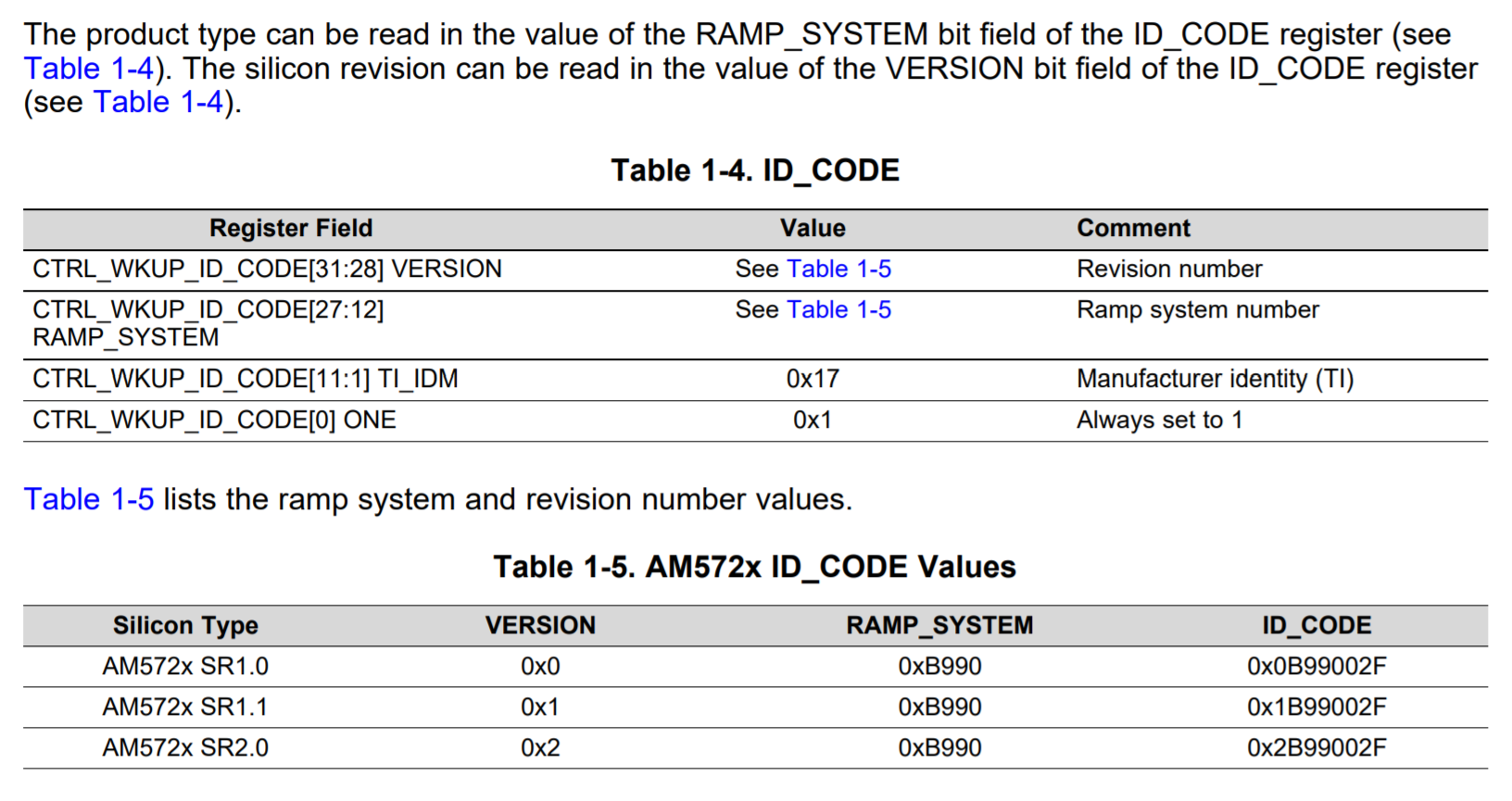

    1) I don't know of a specific correlation table, but one of the experts from the Sitara team provided me with the following information:
    If they can connect to the board, then they can read the *_ID_CODE registers to see the Silicon Revision.  See the following snapshot from AM572x TRM.
     So, RevA is mapped to SR1.x in the table above.

  • Hello Rafael,
    The ID_CODE seems to be 0x2B99002F. That means it is AM572x SR2.0 according to the TRM. In that case, is it still Rev A?

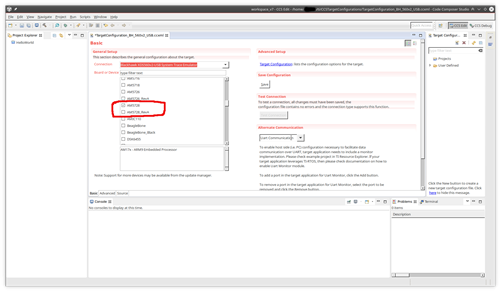

    I am also noticing that the board/device field has 3 other options. As shown in the figure. Which one should be chosen out of them?

    The *_RevA versions are for Silicon Revision 1.1.
    The difference between the board/device variants are which, in any, GEL initialization scripts are used for the Cortex-A15 cores. The GEL initialization scripts perform board specific setup, such as configuring the external memory interface for the memory devices used on the board. If GEL initialization scripts are used for the wrong board, then the external memory may not be configured correctly leading to errors when attempting to download a program from the CCS debugger.
    For your case you should select the GPEVM_AM572X which is for the "AM572x General Purpose Evaluation Module with silicon revision 2.x".
