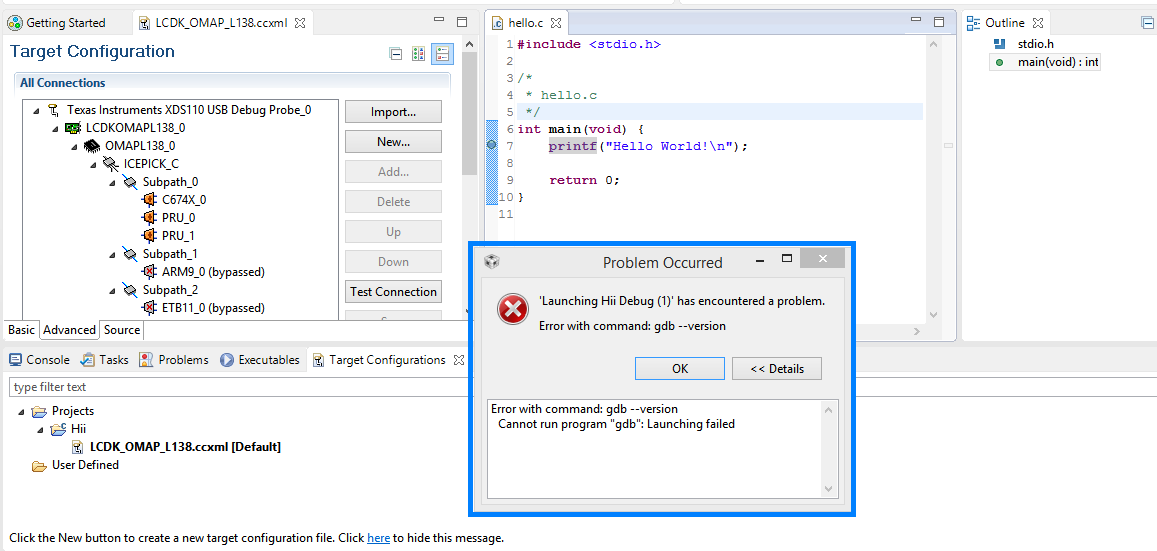

After compilation ok simple Hello program using TMDSLCDK138 target +XDS110, and Test connection OK. Trying to run show problem warning as follows:
Additional, on Run tab the connect/disconnect command is in grey

    It is strange that GDB is being called, as it does not work with the .ccxml files - they are designed to be used exclusively with the TI debugger.
    If your intention is to launch a TI debugger, you can try to follow the procedure to manually launch the debugger mentioned in the link below:
    software-dl.ti.com/.../sdto_ccs_debug-handbook.html
    However, if your intention is to use a GDB debugger, you should instead be running a GDB server either using the XDS GDB Agent or an OpenOCD instance.
    Details about the XDS GDB Agent can be found at the page below; for OpenOCD you need to search on the internet.
    processors.wiki.ti.com/.../XDS_GDB_Agent
    All that said, unfortunately one problem you will face is that XDS110 does not support OMAPL13x devices due to the absence of adaptive clocking. You need a XDS100v2, a XDS200 or XDS560v2.
