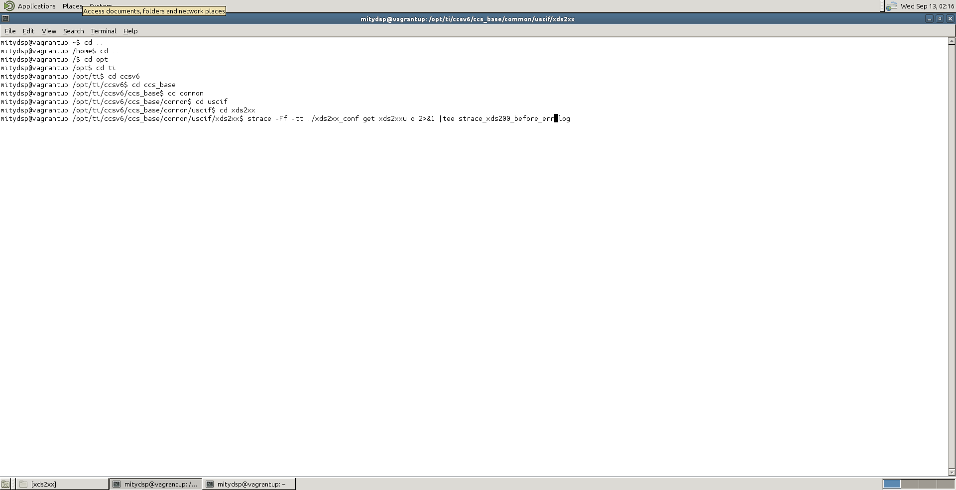

3) You mentioned ./xds2xx_conf get xds2xxu 0 stops working. Can you run xds2xx_conf under strace and post the results. That should details on the error xds2xx_conf is detected.
I am really sorry for the delay in my response.
I am attaching log files and screenshots with respective command names. Please have a look and let me know if I am missing something.
For test connection screenshot, after first screenshot, it takes few minutes to respond from XDS200. The response in is second screenshot.
Thanks.

02:17:04.403903 execve("./xds2xx_conf", ["./xds2xx_conf", "get", "xds2xxu", "o"], [/* 50 vars */]) = 0 [ Process PID=2701 runs in 32 bit mode. ] 02:17:04.407203 brk(0) = 0x98cf000 02:17:04.407550 access("/etc/ld.so.nohwcap", F_OK) = -1 ENOENT (No such file or directory) 02:17:04.407914 mmap2(NULL, 8192, PROT_READ|PROT_WRITE, MAP_PRIVATE|MAP_ANONYMOUS, -1, 0) = 0xfffffffff773a000 02:17:04.408298 readlink("/proc/self/exe", "/opt/ti/ccsv6/ccs_base/common/us"..., 4096) = 54 02:17:04.408593 access("/etc/ld.so.preload", R_OK) = -1 ENOENT (No such file or directory) 02:17:04.408672 open("/opt/ti/ccsv6/ccs_base/common/uscif/xds2xx/./tls/i686/sse2/cmov/libdl.so.2", O_RDONLY|O_CLOEXEC) = -1 ENOENT (No such file or directory) 02:17:04.409014 stat64("/opt/ti/ccsv6/ccs_base/common/uscif/xds2xx/./tls/i686/sse2/cmov", 0xffe8bd00) = -1 ENOENT (No such file or directory) 02:17:04.409191 open("/opt/ti/ccsv6/ccs_base/common/uscif/xds2xx/./tls/i686/sse2/libdl.so.2", O_RDONLY|O_CLOEXEC) = -1 ENOENT (No such file or directory) 02:17:04.409565 stat64("/opt/ti/ccsv6/ccs_base/common/uscif/xds2xx/./tls/i686/sse2", 0xffe8bd00) = -1 ENOENT (No such file or directory) 02:17:04.409697 open("/opt/ti/ccsv6/ccs_base/common/uscif/xds2xx/./tls/i686/cmov/libdl.so.2", O_RDONLY|O_CLOEXEC) = -1 ENOENT (No such file or directory) 02:17:04.409886 stat64("/opt/ti/ccsv6/ccs_base/common/uscif/xds2xx/./tls/i686/cmov", 0xffe8bd00) = -1 ENOENT (No such file or directory) 02:17:04.410048 open("/opt/ti/ccsv6/ccs_base/common/uscif/xds2xx/./tls/i686/libdl.so.2", O_RDONLY|O_CLOEXEC) = -1 ENOENT (No such file or directory) 02:17:04.410204 stat64("/opt/ti/ccsv6/ccs_base/common/uscif/xds2xx/./tls/i686", 0xffe8bd00) = -1 ENOENT (No such file or directory) 02:17:04.410320 open("/opt/ti/ccsv6/ccs_base/common/uscif/xds2xx/./tls/sse2/cmov/libdl.so.2", O_RDONLY|O_CLOEXEC) = -1 ENOENT (No such file or directory) 02:17:04.410404 stat64("/opt/ti/ccsv6/ccs_base/common/uscif/xds2xx/./tls/sse2/cmov", 0xffe8bd00) = -1 ENOENT (No such file or directory) 02:17:04.410547 open("/opt/ti/ccsv6/ccs_base/common/uscif/xds2xx/./tls/sse2/libdl.so.2", O_RDONLY|O_CLOEXEC) = -1 ENOENT (No such file or directory) 02:17:04.410712 stat64("/opt/ti/ccsv6/ccs_base/common/uscif/xds2xx/./tls/sse2", 0xffe8bd00) = -1 ENOENT (No such file or directory) 02:17:04.410821 open("/opt/ti/ccsv6/ccs_base/common/uscif/xds2xx/./tls/cmov/libdl.so.2", O_RDONLY|O_CLOEXEC) = -1 ENOENT (No such file or directory) 02:17:04.410905 stat64("/opt/ti/ccsv6/ccs_base/common/uscif/xds2xx/./tls/cmov", 0xffe8bd00) = -1 ENOENT (No such file or directory) 02:17:04.411050 open("/opt/ti/ccsv6/ccs_base/common/uscif/xds2xx/./tls/libdl.so.2", O_RDONLY|O_CLOEXEC) = -1 ENOENT (No such file or directory) 02:17:04.411169 stat64("/opt/ti/ccsv6/ccs_base/common/uscif/xds2xx/./tls", 0xffe8bd00) = -1 ENOENT (No such file or directory) 02:17:04.411254 open("/opt/ti/ccsv6/ccs_base/common/uscif/xds2xx/./i686/sse2/cmov/libdl.so.2", O_RDONLY|O_CLOEXEC) = -1 ENOENT (No such file or directory) 02:17:04.411391 stat64("/opt/ti/ccsv6/ccs_base/common/uscif/xds2xx/./i686/sse2/cmov", 0xffe8bd00) = -1 ENOENT (No such file or directory) 02:17:04.411451 open("/opt/ti/ccsv6/ccs_base/common/uscif/xds2xx/./i686/sse2/libdl.so.2", O_RDONLY|O_CLOEXEC) = -1 ENOENT (No such file or directory) 02:17:04.411611 stat64("/opt/ti/ccsv6/ccs_base/common/uscif/xds2xx/./i686/sse2", 0xffe8bd00) = -1 ENOENT (No such file or directory) 02:17:04.411733 open("/opt/ti/ccsv6/ccs_base/common/uscif/xds2xx/./i686/cmov/libdl.so.2", O_RDONLY|O_CLOEXEC) = -1 ENOENT (No such file or directory) 02:17:04.411822 stat64("/opt/ti/ccsv6/ccs_base/common/uscif/xds2xx/./i686/cmov", 0xffe8bd00) = -1 ENOENT (No such file or directory) 02:17:04.411988 open("/opt/ti/ccsv6/ccs_base/common/uscif/xds2xx/./i686/libdl.so.2", O_RDONLY|O_CLOEXEC) = -1 ENOENT (No such file or directory) 02:17:04.412128 stat64("/opt/ti/ccsv6/ccs_base/common/uscif/xds2xx/./i686", 0xffe8bd00) = -1 ENOENT (No such file or directory) 02:17:04.412224 open("/opt/ti/ccsv6/ccs_base/common/uscif/xds2xx/./sse2/cmov/libdl.so.2", O_RDONLY|O_CLOEXEC) = -1 ENOENT (No such file or directory) 02:17:04.412397 stat64("/opt/ti/ccsv6/ccs_base/common/uscif/xds2xx/./sse2/cmov", 0xffe8bd00) = -1 ENOENT (No such file or directory) 02:17:04.412456 open("/opt/ti/ccsv6/ccs_base/common/uscif/xds2xx/./sse2/libdl.so.2", O_RDONLY|O_CLOEXEC) = -1 ENOENT (No such file or directory) 02:17:04.412538 stat64("/opt/ti/ccsv6/ccs_base/common/uscif/xds2xx/./sse2", 0xffe8bd00) = -1 ENOENT (No such file or directory) 02:17:04.412639 open("/opt/ti/ccsv6/ccs_base/common/uscif/xds2xx/./cmov/libdl.so.2", O_RDONLY|O_CLOEXEC) = -1 ENOENT (No such file or directory) 02:17:04.412710 stat64("/opt/ti/ccsv6/ccs_base/common/uscif/xds2xx/./cmov", 0xffe8bd00) = -1 ENOENT (No such file or directory) 02:17:04.412767 open("/opt/ti/ccsv6/ccs_base/common/uscif/xds2xx/./libdl.so.2", O_RDONLY|O_CLOEXEC) = -1 ENOENT (No such file or directory) 02:17:04.412856 stat64("/opt/ti/ccsv6/ccs_base/common/uscif/xds2xx/.", {st_mode=S_IFDIR|0757, st_size=4096, ...}) = 0 02:17:04.412950 open("/opt/ti/ccsv6/ccs_base/common/uscif/xds2xx/../../common/uscif/tls/i686/sse2/cmov/libdl.so.2", O_RDONLY|O_CLOEXEC) = -1 ENOENT (No such file or directory) 02:17:04.413040 stat64("/opt/ti/ccsv6/ccs_base/common/uscif/xds2xx/../../common/uscif/tls/i686/sse2/cmov", 0xffe8bd00) = -1 ENOENT (No such file or directory) 02:17:04.413109 open("/opt/ti/ccsv6/ccs_base/common/uscif/xds2xx/../../common/uscif/tls/i686/sse2/libdl.so.2", O_RDONLY|O_CLOEXEC) = -1 ENOENT (No such file or directory) 02:17:04.413169 stat64("/opt/ti/ccsv6/ccs_base/common/uscif/xds2xx/../../common/uscif/tls/i686/sse2", 0xffe8bd00) = -1 ENOENT (No such file or directory) 02:17:04.413261 open("/opt/ti/ccsv6/ccs_base/common/uscif/xds2xx/../../common/uscif/tls/i686/cmov/libdl.so.2", O_RDONLY|O_CLOEXEC) = -1 ENOENT (No such file or directory) 02:17:04.413352 stat64("/opt/ti/ccsv6/ccs_base/common/uscif/xds2xx/../../common/uscif/tls/i686/cmov", 0xffe8bd00) = -1 ENOENT (No such file or directory) 02:17:04.413409 open("/opt/ti/ccsv6/ccs_base/common/uscif/xds2xx/../../common/uscif/tls/i686/libdl.so.2", O_RDONLY|O_CLOEXEC) = -1 ENOENT (No such file or directory) 02:17:04.413588 stat64("/opt/ti/ccsv6/ccs_base/common/uscif/xds2xx/../../common/uscif/tls/i686", 0xffe8bd00) = -1 ENOENT (No such file or directory) 02:17:04.413675 open("/opt/ti/ccsv6/ccs_base/common/uscif/xds2xx/../../common/uscif/tls/sse2/cmov/libdl.so.2", O_RDONLY|O_CLOEXEC) = -1 ENOENT (No such file or directory) 02:17:04.413757 stat64("/opt/ti/ccsv6/ccs_base/common/uscif/xds2xx/../../common/uscif/tls/sse2/cmov", 0xffe8bd00) = -1 ENOENT (No such file or directory) 02:17:04.413836 open("/opt/ti/ccsv6/ccs_base/common/uscif/xds2xx/../../common/uscif/tls/sse2/libdl.so.2", O_RDONLY|O_CLOEXEC) = -1 ENOENT (No such file or directory) 02:17:04.413916 stat64("/opt/ti/ccsv6/ccs_base/common/uscif/xds2xx/../../common/uscif/tls/sse2", 0xffe8bd00) = -1 ENOENT (No such file or directory) 02:17:04.413993 open("/opt/ti/ccsv6/ccs_base/common/uscif/xds2xx/../../common/uscif/tls/cmov/libdl.so.2", O_RDONLY|O_CLOEXEC) = -1 ENOENT (No such file or directory) 02:17:04.414073 stat64("/opt/ti/ccsv6/ccs_base/common/uscif/xds2xx/../../common/uscif/tls/cmov", 0xffe8bd00) = -1 ENOENT (No such file or directory) 02:17:04.414151 open("/opt/ti/ccsv6/ccs_base/common/uscif/xds2xx/../../common/uscif/tls/libdl.so.2", O_RDONLY|O_CLOEXEC) = -1 ENOENT (No such file or directory) 02:17:04.414229 stat64("/opt/ti/ccsv6/ccs_base/common/uscif/xds2xx/../../common/uscif/tls", 0xffe8bd00) = -1 ENOENT (No such file or directory) 02:17:04.414307 open("/opt/ti/ccsv6/ccs_base/common/uscif/xds2xx/../../common/uscif/i686/sse2/cmov/libdl.so.2", O_RDONLY|O_CLOEXEC) = -1 ENOENT (No such file or directory) 02:17:04.414387 stat64("/opt/ti/ccsv6/ccs_base/common/uscif/xds2xx/../../common/uscif/i686/sse2/cmov", 0xffe8bd00) = -1 ENOENT (No such file or directory) 02:17:04.414441 open("/opt/ti/ccsv6/ccs_base/common/uscif/xds2xx/../../common/uscif/i686/sse2/libdl.so.2", O_RDONLY|O_CLOEXEC) = -1 ENOENT (No such file or directory) 02:17:04.414496 stat64("/opt/ti/ccsv6/ccs_base/common/uscif/xds2xx/../../common/uscif/i686/sse2", 0xffe8bd00) = -1 ENOENT (No such file or directory) 02:17:04.414573 open("/opt/ti/ccsv6/ccs_base/common/uscif/xds2xx/../../common/uscif/i686/cmov/libdl.so.2", O_RDONLY|O_CLOEXEC) = -1 ENOENT (No such file or directory) 02:17:04.414649 stat64("/opt/ti/ccsv6/ccs_base/common/uscif/xds2xx/../../common/uscif/i686/cmov", 0xffe8bd00) = -1 ENOENT (No such file or directory) 02:17:04.414723 open("/opt/ti/ccsv6/ccs_base/common/uscif/xds2xx/../../common/uscif/i686/libdl.so.2", O_RDONLY|O_CLOEXEC) = -1 ENOENT (No such file or directory) 02:17:04.414798 stat64("/opt/ti/ccsv6/ccs_base/common/uscif/xds2xx/../../common/uscif/i686", 0xffe8bd00) = -1 ENOENT (No such file or directory) 02:17:04.414872 open("/opt/ti/ccsv6/ccs_base/common/uscif/xds2xx/../../common/uscif/sse2/cmov/libdl.so.2", O_RDONLY|O_CLOEXEC) = -1 ENOENT (No such file or directory) 02:17:04.414947 stat64("/opt/ti/ccsv6/ccs_base/common/uscif/xds2xx/../../common/uscif/sse2/cmov", 0xffe8bd00) = -1 ENOENT (No such file or directory) 02:17:04.415023 open("/opt/ti/ccsv6/ccs_base/common/uscif/xds2xx/../../common/uscif/sse2/libdl.so.2", O_RDONLY|O_CLOEXEC) = -1 ENOENT (No such file or directory) 02:17:04.415101 stat64("/opt/ti/ccsv6/ccs_base/common/uscif/xds2xx/../../common/uscif/sse2", 0xffe8bd00) = -1 ENOENT (No such file or directory) 02:17:04.415155 open("/opt/ti/ccsv6/ccs_base/common/uscif/xds2xx/../../common/uscif/cmov/libdl.so.2", O_RDONLY|O_CLOEXEC) = -1 ENOENT (No such file or directory) 02:17:04.415217 stat64("/opt/ti/ccsv6/ccs_base/common/uscif/xds2xx/../../common/uscif/cmov", 0xffe8bd00) = -1 ENOENT (No such file or directory) 02:17:04.415270 open("/opt/ti/ccsv6/ccs_base/common/uscif/xds2xx/../../common/uscif/libdl.so.2", O_RDONLY|O_CLOEXEC) = -1 ENOENT (No such file or directory) 02:17:04.415328 stat64("/opt/ti/ccsv6/ccs_base/common/uscif/xds2xx/../../common/uscif", 0xffe8bd00) = -1 ENOENT (No such file or directory) 02:17:04.415384 open("/opt/ti/ccsv6/ccs_base/common/uscif/xds2xx/../../common/bin/tls/i686/sse2/cmov/libdl.so.2", O_RDONLY|O_CLOEXEC) = -1 ENOENT (No such file or directory) 02:17:04.415440 stat64("/opt/ti/ccsv6/ccs_base/common/uscif/xds2xx/../../common/bin/tls/i686/sse2/cmov", 0xffe8bd00) = -1 ENOENT (No such file or directory) 02:17:04.415532 open("/opt/ti/ccsv6/ccs_base/common/uscif/xds2xx/../../common/bin/tls/i686/sse2/libdl.so.2", O_RDONLY|O_CLOEXEC) = -1 ENOENT (No such file or directory) 02:17:04.415605 stat64("/opt/ti/ccsv6/ccs_base/common/uscif/xds2xx/../../common/bin/tls/i686/sse2", 0xffe8bd00) = -1 ENOENT (No such file or directory) 02:17:04.415662 open("/opt/ti/ccsv6/ccs_base/common/uscif/xds2xx/../../common/bin/tls/i686/cmov/libdl.so.2", O_RDONLY|O_CLOEXEC) = -1 ENOENT (No such file or directory) 02:17:04.415718 stat64("/opt/ti/ccsv6/ccs_base/common/uscif/xds2xx/../../common/bin/tls/i686/cmov", 0xffe8bd00) = -1 ENOENT (No such file or directory) 02:17:04.415775 open("/opt/ti/ccsv6/ccs_base/common/uscif/xds2xx/../../common/bin/tls/i686/libdl.so.2", O_RDONLY|O_CLOEXEC) = -1 ENOENT (No such file or directory) 02:17:04.415863 stat64("/opt/ti/ccsv6/ccs_base/common/uscif/xds2xx/../../common/bin/tls/i686", 0xffe8bd00) = -1 ENOENT (No such file or directory) 02:17:04.415944 open("/opt/ti/ccsv6/ccs_base/common/uscif/xds2xx/../../common/bin/tls/sse2/cmov/libdl.so.2", O_RDONLY|O_CLOEXEC) = -1 ENOENT (No such file or directory) 02:17:04.416025 stat64("/opt/ti/ccsv6/ccs_base/common/uscif/xds2xx/../../common/bin/tls/sse2/cmov", 0xffe8bd00) = -1 ENOENT (No such file or directory) 02:17:04.416103 open("/opt/ti/ccsv6/ccs_base/common/uscif/xds2xx/../../common/bin/tls/sse2/libdl.so.2", O_RDONLY|O_CLOEXEC) = -1 ENOENT (No such file or directory) 02:17:04.416183 stat64("/opt/ti/ccsv6/ccs_base/common/uscif/xds2xx/../../common/bin/tls/sse2", 0xffe8bd00) = -1 ENOENT (No such file or directory) 02:17:04.416265 open("/opt/ti/ccsv6/ccs_base/common/uscif/xds2xx/../../common/bin/tls/cmov/libdl.so.2", O_RDONLY|O_CLOEXEC) = -1 ENOENT (No such file or directory) 02:17:04.416344 stat64("/opt/ti/ccsv6/ccs_base/common/uscif/xds2xx/../../common/bin/tls/cmov", 0xffe8bd00) = -1 ENOENT (No such file or directory) 02:17:04.416421 open("/opt/ti/ccsv6/ccs_base/common/uscif/xds2xx/../../common/bin/tls/libdl.so.2", O_RDONLY|O_CLOEXEC) = -1 ENOENT (No such file or directory) 02:17:04.416531 stat64("/opt/ti/ccsv6/ccs_base/common/uscif/xds2xx/../../common/bin/tls", 0xffe8bd00) = -1 ENOENT (No such file or directory) 02:17:04.416619 open("/opt/ti/ccsv6/ccs_base/common/uscif/xds2xx/../../common/bin/i686/sse2/cmov/libdl.so.2", O_RDONLY|O_CLOEXEC) = -1 ENOENT (No such file or directory) 02:17:04.416683 stat64("/opt/ti/ccsv6/ccs_base/common/uscif/xds2xx/../../common/bin/i686/sse2/cmov", 0xffe8bd00) = -1 ENOENT (No such file or directory) 02:17:04.416753 open("/opt/ti/ccsv6/ccs_base/common/uscif/xds2xx/../../common/bin/i686/sse2/libdl.so.2", O_RDONLY|O_CLOEXEC) = -1 ENOENT (No such file or directory) 02:17:04.416813 stat64("/opt/ti/ccsv6/ccs_base/common/uscif/xds2xx/../../common/bin/i686/sse2", 0xffe8bd00) = -1 ENOENT (No such file or directory) 02:17:04.416897 open("/opt/ti/ccsv6/ccs_base/common/uscif/xds2xx/../../common/bin/i686/cmov/libdl.so.2", O_RDONLY|O_CLOEXEC) = -1 ENOENT (No such file or directory) 02:17:04.416979 stat64("/opt/ti/ccsv6/ccs_base/common/uscif/xds2xx/../../common/bin/i686/cmov", 0xffe8bd00) = -1 ENOENT (No such file or directory) 02:17:04.417062 open("/opt/ti/ccsv6/ccs_base/common/uscif/xds2xx/../../common/bin/i686/libdl.so.2", O_RDONLY|O_CLOEXEC) = -1 ENOENT (No such file or directory) 02:17:04.417151 stat64("/opt/ti/ccsv6/ccs_base/common/uscif/xds2xx/../../common/bin/i686", 0xffe8bd00) = -1 ENOENT (No such file or directory) 02:17:04.417266 open("/opt/ti/ccsv6/ccs_base/common/uscif/xds2xx/../../common/bin/sse2/cmov/libdl.so.2", O_RDONLY|O_CLOEXEC) = -1 ENOENT (No such file or directory) 02:17:04.417363 stat64("/opt/ti/ccsv6/ccs_base/common/uscif/xds2xx/../../common/bin/sse2/cmov", 0xffe8bd00) = -1 ENOENT (No such file or directory) 02:17:04.417520 open("/opt/ti/ccsv6/ccs_base/common/uscif/xds2xx/../../common/bin/sse2/libdl.so.2", O_RDONLY|O_CLOEXEC) = -1 ENOENT (No such file or directory) 02:17:04.417583 stat64("/opt/ti/ccsv6/ccs_base/common/uscif/xds2xx/../../common/bin/sse2", 0xffe8bd00) = -1 ENOENT (No such file or directory) 02:17:04.417679 open("/opt/ti/ccsv6/ccs_base/common/uscif/xds2xx/../../common/bin/cmov/libdl.so.2", O_RDONLY|O_CLOEXEC) = -1 ENOENT (No such file or directory) 02:17:04.417738 stat64("/opt/ti/ccsv6/ccs_base/common/uscif/xds2xx/../../common/bin/cmov", 0xffe8bd00) = -1 ENOENT (No such file or directory) 02:17:04.417819 open("/opt/ti/ccsv6/ccs_base/common/uscif/xds2xx/../../common/bin/libdl.so.2", O_RDONLY|O_CLOEXEC) = -1 ENOENT (No such file or directory) 02:17:04.417902 stat64("/opt/ti/ccsv6/ccs_base/common/uscif/xds2xx/../../common/bin", 0xffe8bd00) = -1 ENOENT (No such file or directory) 02:17:04.417983 open("/etc/ld.so.cache", O_RDONLY|O_CLOEXEC) = 3 02:17:04.418074 fstat64(3, {st_mode=S_IFREG|0644, st_size=86136, ...}) = 0 02:17:04.418150 mmap2(NULL, 86136, PROT_READ, MAP_PRIVATE, 3, 0) = 0xfffffffff7724000 02:17:04.418216 close(3) = 0 02:17:04.418364 access("/etc/ld.so.nohwcap", F_OK) = -1 ENOENT (No such file or directory) 02:17:04.418583 open("/lib/i386-linux-gnu/libdl.so.2", O_RDONLY|O_CLOEXEC) = 3 02:17:04.418769 read(3, "\177ELF\1\1\1\0\0\0\0\0\0\0\0\0\3\0\3\0\1\0\0\0\320\n\0\0004\0\0\0"..., 512) = 512 02:17:04.418930 fstat64(3, {st_mode=S_IFREG|0644, st_size=13856, ...}) = 0 02:17:04.418997 mmap2(NULL, 16512, PROT_READ|PROT_EXEC, MAP_PRIVATE|MAP_DENYWRITE, 3, 0) = 0xfffffffff771f000 02:17:04.419068 mmap2(0xf7722000, 8192, PROT_READ|PROT_WRITE, MAP_PRIVATE|MAP_FIXED|MAP_DENYWRITE, 3, 0x2000) = 0xfffffffff7722000 02:17:04.419279 close(3) = 0 02:17:04.419414 open("/opt/ti/ccsv6/ccs_base/common/uscif/xds2xx/./libstdc++.so.6", O_RDONLY|O_CLOEXEC) = -1 ENOENT (No such file or directory) 02:17:04.419540 access("/etc/ld.so.nohwcap", F_OK) = -1 ENOENT (No such file or directory) 02:17:04.419614 open("/usr/lib/i386-linux-gnu/libstdc++.so.6", O_RDONLY|O_CLOEXEC) = 3 02:17:04.419708 read(3, "\177ELF\1\1\1\0\0\0\0\0\0\0\0\0\3\0\3\0\1\0\0\0`f\4\0004\0\0\0"..., 512) = 512 02:17:04.419787 fstat64(3, {st_mode=S_IFREG|0644, st_size=922096, ...}) = 0 02:17:04.419851 mmap2(NULL, 4096, PROT_READ|PROT_WRITE, MAP_PRIVATE|MAP_ANONYMOUS, -1, 0) = 0xfffffffff771e000 02:17:04.419988 mmap2(NULL, 947712, PROT_READ|PROT_EXEC, MAP_PRIVATE|MAP_DENYWRITE, 3, 0) = 0xfffffffff7636000 02:17:04.420079 mmap2(0xf7712000, 20480, PROT_READ|PROT_WRITE, MAP_PRIVATE|MAP_FIXED|MAP_DENYWRITE, 3, 0xdc000) = 0xfffffffff7712000 02:17:04.420213 mmap2(0xf7717000, 26112, PROT_READ|PROT_WRITE, MAP_PRIVATE|MAP_FIXED|MAP_ANONYMOUS, -1, 0) = 0xfffffffff7717000 02:17:04.420388 close(3) = 0 02:17:04.420643 open("/opt/ti/ccsv6/ccs_base/common/uscif/xds2xx/./libgcc_s.so.1", O_RDONLY|O_CLOEXEC) = -1 ENOENT (No such file or directory) 02:17:04.420748 access("/etc/ld.so.nohwcap", F_OK) = -1 ENOENT (No such file or directory) 02:17:04.420844 open("/lib/i386-linux-gnu/libgcc_s.so.1", O_RDONLY|O_CLOEXEC) = 3 02:17:04.420907 read(3, "\177ELF\1\1\1\0\0\0\0\0\0\0\0\0\3\0\3\0\1\0\0\0\240 \0\0004\0\0\0"..., 512) = 512 02:17:04.421005 fstat64(3, {st_mode=S_IFREG|0644, st_size=114372, ...}) = 0 02:17:04.421063 mmap2(NULL, 117524, PROT_READ|PROT_EXEC, MAP_PRIVATE|MAP_DENYWRITE, 3, 0) = 0xfffffffff7619000 02:17:04.421154 mmap2(0xf7635000, 4096, PROT_READ|PROT_WRITE, MAP_PRIVATE|MAP_FIXED|MAP_DENYWRITE, 3, 0x1b000) = 0xfffffffff7635000 02:17:04.421268 close(3) = 0 02:17:04.421455 open("/opt/ti/ccsv6/ccs_base/common/uscif/xds2xx/./libc.so.6", O_RDONLY|O_CLOEXEC) = -1 ENOENT (No such file or directory) 02:17:04.421638 access("/etc/ld.so.nohwcap", F_OK) = -1 ENOENT (No such file or directory) 02:17:04.421730 open("/lib/i386-linux-gnu/libc.so.6", O_RDONLY|O_CLOEXEC) = 3 02:17:04.421817 read(3, "\177ELF\1\1\1\0\0\0\0\0\0\0\0\0\3\0\3\0\1\0\0\0P\234\1\0004\0\0\0"..., 512) = 512 02:17:04.421939 fstat64(3, {st_mode=S_IFREG|0755, st_size=1763068, ...}) = 0 02:17:04.422024 mmap2(NULL, 1772156, PROT_READ|PROT_EXEC, MAP_PRIVATE|MAP_DENYWRITE, 3, 0) = 0xfffffffff7468000 02:17:04.422108 mmap2(0xf7613000, 12288, PROT_READ|PROT_WRITE, MAP_PRIVATE|MAP_FIXED|MAP_DENYWRITE, 3, 0x1aa000) = 0xfffffffff7613000 02:17:04.422226 mmap2(0xf7616000, 10876, PROT_READ|PROT_WRITE, MAP_PRIVATE|MAP_FIXED|MAP_ANONYMOUS, -1, 0) = 0xfffffffff7616000 02:17:04.422389 close(3) = 0 02:17:04.422615 open("/opt/ti/ccsv6/ccs_base/common/uscif/xds2xx/./libm.so.6", O_RDONLY|O_CLOEXEC) = -1 ENOENT (No such file or directory) 02:17:04.422721 access("/etc/ld.so.nohwcap", F_OK) = -1 ENOENT (No such file or directory) 02:17:04.422780 open("/lib/i386-linux-gnu/libm.so.6", O_RDONLY|O_CLOEXEC) = 3 02:17:04.422871 read(3, "\177ELF\1\1\1\0\0\0\0\0\0\0\0\0\3\0\3\0\1\0\0\0\0F\0\0004\0\0\0"..., 512) = 512 02:17:04.422991 fstat64(3, {st_mode=S_IFREG|0644, st_size=280108, ...}) = 0 02:17:04.423077 mmap2(NULL, 282784, PROT_READ|PROT_EXEC, MAP_PRIVATE|MAP_DENYWRITE, 3, 0) = 0xfffffffff7422000 02:17:04.423173 mmap2(0xf7466000, 8192, PROT_READ|PROT_WRITE, MAP_PRIVATE|MAP_FIXED|MAP_DENYWRITE, 3, 0x43000) = 0xfffffffff7466000 02:17:04.423394 close(3) = 0 02:17:04.423573 mmap2(NULL, 4096, PROT_READ|PROT_WRITE, MAP_PRIVATE|MAP_ANONYMOUS, -1, 0) = 0xfffffffff7421000 02:17:04.423707 mmap2(NULL, 4096, PROT_READ|PROT_WRITE, MAP_PRIVATE|MAP_ANONYMOUS, -1, 0) = 0xfffffffff7420000 02:17:04.423821 set_thread_area(0xffe8c1d0) = 0 02:17:04.424351 mprotect(0xf7613000, 8192, PROT_READ) = 0 02:17:04.424658 mprotect(0xf7466000, 4096, PROT_READ) = 0 02:17:04.425581 mmap2(NULL, 4096, PROT_READ|PROT_WRITE, MAP_PRIVATE|MAP_ANONYMOUS, -1, 0) = 0xfffffffff741f000 02:17:04.425906 mprotect(0xf7712000, 16384, PROT_READ) = 0 02:17:04.426156 mprotect(0xf7722000, 4096, PROT_READ) = 0 02:17:04.426320 mprotect(0x8061000, 4096, PROT_READ) = 0 02:17:04.426431 mprotect(0xf775f000, 4096, PROT_READ) = 0 02:17:04.426545 munmap(0xf7724000, 86136) = 0 02:17:04.428584 brk(0) = 0x98cf000 02:17:04.428728 brk(0x98f0000) = 0x98f0000 02:17:04.429070 open("/opt/ti/ccsv6/ccs_base/common/uscif/xds2xx/./xds2xx_usbconf.so", O_RDONLY|O_CLOEXEC) = 3 02:17:04.429225 read(3, "\177ELF\1\1\1\0\0\0\0\0\0\0\0\0\3\0\3\0\1\0\0\0\260\37\0\0004\0\0\0"..., 512) = 512 02:17:04.429298 fstat64(3, {st_mode=S_IFREG|0777, st_size=64142, ...}) = 0 02:17:04.429380 mmap2(NULL, 61704, PROT_READ|PROT_EXEC, MAP_PRIVATE|MAP_DENYWRITE, 3, 0) = 0xfffffffff772a000 02:17:04.429671 mmap2(0xf7737000, 8192, PROT_READ|PROT_WRITE, MAP_PRIVATE|MAP_FIXED|MAP_DENYWRITE, 3, 0xc000) = 0xfffffffff7737000 02:17:04.429900 mmap2(0xf7739000, 264, PROT_READ|PROT_WRITE, MAP_PRIVATE|MAP_FIXED|MAP_ANONYMOUS, -1, 0) = 0xfffffffff7739000 02:17:04.430060 close(3) = 0 02:17:04.430265 open("/opt/ti/ccsv6/ccs_base/common/uscif/xds2xx/././tls/i686/sse2/cmov/librt.so.1", O_RDONLY|O_CLOEXEC) = -1 ENOENT (No such file or directory) 02:17:04.430367 stat64("/opt/ti/ccsv6/ccs_base/common/uscif/xds2xx/././tls/i686/sse2/cmov", 0xffe8b750) = -1 ENOENT (No such file or directory) 02:17:04.430439 open("/opt/ti/ccsv6/ccs_base/common/uscif/xds2xx/././tls/i686/sse2/librt.so.1", O_RDONLY|O_CLOEXEC) = -1 ENOENT (No such file or directory) 02:17:04.430527 stat64("/opt/ti/ccsv6/ccs_base/common/uscif/xds2xx/././tls/i686/sse2", 0xffe8b750) = -1 ENOENT (No such file or directory) 02:17:04.430586 open("/opt/ti/ccsv6/ccs_base/common/uscif/xds2xx/././tls/i686/cmov/librt.so.1", O_RDONLY|O_CLOEXEC) = -1 ENOENT (No such file or directory) 02:17:04.430658 stat64("/opt/ti/ccsv6/ccs_base/common/uscif/xds2xx/././tls/i686/cmov", 0xffe8b750) = -1 ENOENT (No such file or directory) 02:17:04.430722 open("/opt/ti/ccsv6/ccs_base/common/uscif/xds2xx/././tls/i686/librt.so.1", O_RDONLY|O_CLOEXEC) = -1 ENOENT (No such file or directory) 02:17:04.430805 stat64("/opt/ti/ccsv6/ccs_base/common/uscif/xds2xx/././tls/i686", 0xffe8b750) = -1 ENOENT (No such file or directory) 02:17:04.430868 open("/opt/ti/ccsv6/ccs_base/common/uscif/xds2xx/././tls/sse2/cmov/librt.so.1", O_RDONLY|O_CLOEXEC) = -1 ENOENT (No such file or directory) 02:17:04.430932 stat64("/opt/ti/ccsv6/ccs_base/common/uscif/xds2xx/././tls/sse2/cmov", 0xffe8b750) = -1 ENOENT (No such file or directory) 02:17:04.430989 open("/opt/ti/ccsv6/ccs_base/common/uscif/xds2xx/././tls/sse2/librt.so.1", O_RDONLY|O_CLOEXEC) = -1 ENOENT (No such file or directory) 02:17:04.431045 stat64("/opt/ti/ccsv6/ccs_base/common/uscif/xds2xx/././tls/sse2", 0xffe8b750) = -1 ENOENT (No such file or directory) 02:17:04.431098 open("/opt/ti/ccsv6/ccs_base/common/uscif/xds2xx/././tls/cmov/librt.so.1", O_RDONLY|O_CLOEXEC) = -1 ENOENT (No such file or directory) 02:17:04.431169 stat64("/opt/ti/ccsv6/ccs_base/common/uscif/xds2xx/././tls/cmov", 0xffe8b750) = -1 ENOENT (No such file or directory) 02:17:04.431223 open("/opt/ti/ccsv6/ccs_base/common/uscif/xds2xx/././tls/librt.so.1", O_RDONLY|O_CLOEXEC) = -1 ENOENT (No such file or directory) 02:17:04.431278 stat64("/opt/ti/ccsv6/ccs_base/common/uscif/xds2xx/././tls", 0xffe8b750) = -1 ENOENT (No such file or directory) 02:17:04.431332 open("/opt/ti/ccsv6/ccs_base/common/uscif/xds2xx/././i686/sse2/cmov/librt.so.1", O_RDONLY|O_CLOEXEC) = -1 ENOENT (No such file or directory) 02:17:04.431387 stat64("/opt/ti/ccsv6/ccs_base/common/uscif/xds2xx/././i686/sse2/cmov", 0xffe8b750) = -1 ENOENT (No such file or directory) 02:17:04.431440 open("/opt/ti/ccsv6/ccs_base/common/uscif/xds2xx/././i686/sse2/librt.so.1", O_RDONLY|O_CLOEXEC) = -1 ENOENT (No such file or directory) 02:17:04.431495 stat64("/opt/ti/ccsv6/ccs_base/common/uscif/xds2xx/././i686/sse2", 0xffe8b750) = -1 ENOENT (No such file or directory) 02:17:04.431548 open("/opt/ti/ccsv6/ccs_base/common/uscif/xds2xx/././i686/cmov/librt.so.1", O_RDONLY|O_CLOEXEC) = -1 ENOENT (No such file or directory) 02:17:04.431603 stat64("/opt/ti/ccsv6/ccs_base/common/uscif/xds2xx/././i686/cmov", 0xffe8b750) = -1 ENOENT (No such file or directory) 02:17:04.431656 open("/opt/ti/ccsv6/ccs_base/common/uscif/xds2xx/././i686/librt.so.1", O_RDONLY|O_CLOEXEC) = -1 ENOENT (No such file or directory) 02:17:04.431712 stat64("/opt/ti/ccsv6/ccs_base/common/uscif/xds2xx/././i686", 0xffe8b750) = -1 ENOENT (No such file or directory) 02:17:04.431765 open("/opt/ti/ccsv6/ccs_base/common/uscif/xds2xx/././sse2/cmov/librt.so.1", O_RDONLY|O_CLOEXEC) = -1 ENOENT (No such file or directory) 02:17:04.431819 stat64("/opt/ti/ccsv6/ccs_base/common/uscif/xds2xx/././sse2/cmov", 0xffe8b750) = -1 ENOENT (No such file or directory) 02:17:04.431872 open("/opt/ti/ccsv6/ccs_base/common/uscif/xds2xx/././sse2/librt.so.1", O_RDONLY|O_CLOEXEC) = -1 ENOENT (No such file or directory) 02:17:04.431927 stat64("/opt/ti/ccsv6/ccs_base/common/uscif/xds2xx/././sse2", 0xffe8b750) = -1 ENOENT (No such file or directory) 02:17:04.431980 open("/opt/ti/ccsv6/ccs_base/common/uscif/xds2xx/././cmov/librt.so.1", O_RDONLY|O_CLOEXEC) = -1 ENOENT (No such file or directory) 02:17:04.432036 stat64("/opt/ti/ccsv6/ccs_base/common/uscif/xds2xx/././cmov", 0xffe8b750) = -1 ENOENT (No such file or directory) 02:17:04.432088 open("/opt/ti/ccsv6/ccs_base/common/uscif/xds2xx/././librt.so.1", O_RDONLY|O_CLOEXEC) = -1 ENOENT (No such file or directory) 02:17:04.432168 stat64("/opt/ti/ccsv6/ccs_base/common/uscif/xds2xx/./.", {st_mode=S_IFDIR|0757, st_size=4096, ...}) = 0 02:17:04.432230 open("/opt/ti/ccsv6/ccs_base/common/uscif/xds2xx/./../../common/uscif/tls/i686/sse2/cmov/librt.so.1", O_RDONLY|O_CLOEXEC) = -1 ENOENT (No such file or directory) 02:17:04.432288 stat64("/opt/ti/ccsv6/ccs_base/common/uscif/xds2xx/./../../common/uscif/tls/i686/sse2/cmov", 0xffe8b750) = -1 ENOENT (No such file or directory) 02:17:04.432341 open("/opt/ti/ccsv6/ccs_base/common/uscif/xds2xx/./../../common/uscif/tls/i686/sse2/librt.so.1", O_RDONLY|O_CLOEXEC) = -1 ENOENT (No such file or directory) 02:17:04.432395 stat64("/opt/ti/ccsv6/ccs_base/common/uscif/xds2xx/./../../common/uscif/tls/i686/sse2", 0xffe8b750) = -1 ENOENT (No such file or directory) 02:17:04.432448 open("/opt/ti/ccsv6/ccs_base/common/uscif/xds2xx/./../../common/uscif/tls/i686/cmov/librt.so.1", O_RDONLY|O_CLOEXEC) = -1 ENOENT (No such file or directory) 02:17:04.432502 stat64("/opt/ti/ccsv6/ccs_base/common/uscif/xds2xx/./../../common/uscif/tls/i686/cmov", 0xffe8b750) = -1 ENOENT (No such file or directory) 02:17:04.432555 open("/opt/ti/ccsv6/ccs_base/common/uscif/xds2xx/./../../common/uscif/tls/i686/librt.so.1", O_RDONLY|O_CLOEXEC) = -1 ENOENT (No such file or directory) 02:17:04.432685 stat64("/opt/ti/ccsv6/ccs_base/common/uscif/xds2xx/./../../common/uscif/tls/i686", 0xffe8b750) = -1 ENOENT (No such file or directory) 02:17:04.432739 open("/opt/ti/ccsv6/ccs_base/common/uscif/xds2xx/./../../common/uscif/tls/sse2/cmov/librt.so.1", O_RDONLY|O_CLOEXEC) = -1 ENOENT (No such file or directory) 02:17:04.432794 stat64("/opt/ti/ccsv6/ccs_base/common/uscif/xds2xx/./../../common/uscif/tls/sse2/cmov", 0xffe8b750) = -1 ENOENT (No such file or directory) 02:17:04.432847 open("/opt/ti/ccsv6/ccs_base/common/uscif/xds2xx/./../../common/uscif/tls/sse2/librt.so.1", O_RDONLY|O_CLOEXEC) = -1 ENOENT (No such file or directory) 02:17:04.432902 stat64("/opt/ti/ccsv6/ccs_base/common/uscif/xds2xx/./../../common/uscif/tls/sse2", 0xffe8b750) = -1 ENOENT (No such file or directory) 02:17:04.432955 open("/opt/ti/ccsv6/ccs_base/common/uscif/xds2xx/./../../common/uscif/tls/cmov/librt.so.1", O_RDONLY|O_CLOEXEC) = -1 ENOENT (No such file or directory) 02:17:04.433009 stat64("/opt/ti/ccsv6/ccs_base/common/uscif/xds2xx/./../../common/uscif/tls/cmov", 0xffe8b750) = -1 ENOENT (No such file or directory) 02:17:04.433062 open("/opt/ti/ccsv6/ccs_base/common/uscif/xds2xx/./../../common/uscif/tls/librt.so.1", O_RDONLY|O_CLOEXEC) = -1 ENOENT (No such file or directory) 02:17:04.434956 stat64("/opt/ti/ccsv6/ccs_base/common/uscif/xds2xx/./../../common/uscif/tls", 0xffe8b750) = -1 ENOENT (No such file or directory) 02:17:04.435036 open("/opt/ti/ccsv6/ccs_base/common/uscif/xds2xx/./../../common/uscif/i686/sse2/cmov/librt.so.1", O_RDONLY|O_CLOEXEC) = -1 ENOENT (No such file or directory) 02:17:04.435118 stat64("/opt/ti/ccsv6/ccs_base/common/uscif/xds2xx/./../../common/uscif/i686/sse2/cmov", 0xffe8b750) = -1 ENOENT (No such file or directory) 02:17:04.435203 open("/opt/ti/ccsv6/ccs_base/common/uscif/xds2xx/./../../common/uscif/i686/sse2/librt.so.1", O_RDONLY|O_CLOEXEC) = -1 ENOENT (No such file or directory) 02:17:04.435260 stat64("/opt/ti/ccsv6/ccs_base/common/uscif/xds2xx/./../../common/uscif/i686/sse2", 0xffe8b750) = -1 ENOENT (No such file or directory) 02:17:04.435313 open("/opt/ti/ccsv6/ccs_base/common/uscif/xds2xx/./../../common/uscif/i686/cmov/librt.so.1", O_RDONLY|O_CLOEXEC) = -1 ENOENT (No such file or directory) 02:17:04.435369 stat64("/opt/ti/ccsv6/ccs_base/common/uscif/xds2xx/./../../common/uscif/i686/cmov", 0xffe8b750) = -1 ENOENT (No such file or directory) 02:17:04.435422 open("/opt/ti/ccsv6/ccs_base/common/uscif/xds2xx/./../../common/uscif/i686/librt.so.1", O_RDONLY|O_CLOEXEC) = -1 ENOENT (No such file or directory) 02:17:04.435476 stat64("/opt/ti/ccsv6/ccs_base/common/uscif/xds2xx/./../../common/uscif/i686", 0xffe8b750) = -1 ENOENT (No such file or directory) 02:17:04.435528 open("/opt/ti/ccsv6/ccs_base/common/uscif/xds2xx/./../../common/uscif/sse2/cmov/librt.so.1", O_RDONLY|O_CLOEXEC) = -1 ENOENT (No such file or directory) 02:17:04.435584 stat64("/opt/ti/ccsv6/ccs_base/common/uscif/xds2xx/./../../common/uscif/sse2/cmov", 0xffe8b750) = -1 ENOENT (No such file or directory) 02:17:04.435638 open("/opt/ti/ccsv6/ccs_base/common/uscif/xds2xx/./../../common/uscif/sse2/librt.so.1", O_RDONLY|O_CLOEXEC) = -1 ENOENT (No such file or directory) 02:17:04.435713 stat64("/opt/ti/ccsv6/ccs_base/common/uscif/xds2xx/./../../common/uscif/sse2", 0xffe8b750) = -1 ENOENT (No such file or directory) 02:17:04.435771 open("/opt/ti/ccsv6/ccs_base/common/uscif/xds2xx/./../../common/uscif/cmov/librt.so.1", O_RDONLY|O_CLOEXEC) = -1 ENOENT (No such file or directory) 02:17:04.435825 stat64("/opt/ti/ccsv6/ccs_base/common/uscif/xds2xx/./../../common/uscif/cmov", 0xffe8b750) = -1 ENOENT (No such file or directory) 02:17:04.435877 open("/opt/ti/ccsv6/ccs_base/common/uscif/xds2xx/./../../common/uscif/librt.so.1", O_RDONLY|O_CLOEXEC) = -1 ENOENT (No such file or directory) 02:17:04.435948 stat64("/opt/ti/ccsv6/ccs_base/common/uscif/xds2xx/./../../common/uscif", 0xffe8b750) = -1 ENOENT (No such file or directory) 02:17:04.436002 open("/opt/ti/ccsv6/ccs_base/common/uscif/xds2xx/./../../common/bin/tls/i686/sse2/cmov/librt.so.1", O_RDONLY|O_CLOEXEC) = -1 ENOENT (No such file or directory) 02:17:04.436061 stat64("/opt/ti/ccsv6/ccs_base/common/uscif/xds2xx/./../../common/bin/tls/i686/sse2/cmov", 0xffe8b750) = -1 ENOENT (No such file or directory) 02:17:04.436118 open("/opt/ti/ccsv6/ccs_base/common/uscif/xds2xx/./../../common/bin/tls/i686/sse2/librt.so.1", O_RDONLY|O_CLOEXEC) = -1 ENOENT (No such file or directory) 02:17:04.436175 stat64("/opt/ti/ccsv6/ccs_base/common/uscif/xds2xx/./../../common/bin/tls/i686/sse2", 0xffe8b750) = -1 ENOENT (No such file or directory) 02:17:04.436228 open("/opt/ti/ccsv6/ccs_base/common/uscif/xds2xx/./../../common/bin/tls/i686/cmov/librt.so.1", O_RDONLY|O_CLOEXEC) = -1 ENOENT (No such file or directory) 02:17:04.436281 stat64("/opt/ti/ccsv6/ccs_base/common/uscif/xds2xx/./../../common/bin/tls/i686/cmov", 0xffe8b750) = -1 ENOENT (No such file or directory) 02:17:04.436334 open("/opt/ti/ccsv6/ccs_base/common/uscif/xds2xx/./../../common/bin/tls/i686/librt.so.1", O_RDONLY|O_CLOEXEC) = -1 ENOENT (No such file or directory) 02:17:04.436389 stat64("/opt/ti/ccsv6/ccs_base/common/uscif/xds2xx/./../../common/bin/tls/i686", 0xffe8b750) = -1 ENOENT (No such file or directory) 02:17:04.436441 open("/opt/ti/ccsv6/ccs_base/common/uscif/xds2xx/./../../common/bin/tls/sse2/cmov/librt.so.1", O_RDONLY|O_CLOEXEC) = -1 ENOENT (No such file or directory) 02:17:04.436562 stat64("/opt/ti/ccsv6/ccs_base/common/uscif/xds2xx/./../../common/bin/tls/sse2/cmov", 0xffe8b750) = -1 ENOENT (No such file or directory) 02:17:04.436616 open("/opt/ti/ccsv6/ccs_base/common/uscif/xds2xx/./../../common/bin/tls/sse2/librt.so.1", O_RDONLY|O_CLOEXEC) = -1 ENOENT (No such file or directory) 02:17:04.436671 stat64("/opt/ti/ccsv6/ccs_base/common/uscif/xds2xx/./../../common/bin/tls/sse2", 0xffe8b750) = -1 ENOENT (No such file or directory) 02:17:04.436724 open("/opt/ti/ccsv6/ccs_base/common/uscif/xds2xx/./../../common/bin/tls/cmov/librt.so.1", O_RDONLY|O_CLOEXEC) = -1 ENOENT (No such file or directory) 02:17:04.436778 stat64("/opt/ti/ccsv6/ccs_base/common/uscif/xds2xx/./../../common/bin/tls/cmov", 0xffe8b750) = -1 ENOENT (No such file or directory) 02:17:04.436830 open("/opt/ti/ccsv6/ccs_base/common/uscif/xds2xx/./../../common/bin/tls/librt.so.1", O_RDONLY|O_CLOEXEC) = -1 ENOENT (No such file or directory) 02:17:04.436884 stat64("/opt/ti/ccsv6/ccs_base/common/uscif/xds2xx/./../../common/bin/tls", 0xffe8b750) = -1 ENOENT (No such file or directory) 02:17:04.436938 open("/opt/ti/ccsv6/ccs_base/common/uscif/xds2xx/./../../common/bin/i686/sse2/cmov/librt.so.1", O_RDONLY|O_CLOEXEC) = -1 ENOENT (No such file or directory) 02:17:04.437001 stat64("/opt/ti/ccsv6/ccs_base/common/uscif/xds2xx/./../../common/bin/i686/sse2/cmov", 0xffe8b750) = -1 ENOENT (No such file or directory) 02:17:04.437056 open("/opt/ti/ccsv6/ccs_base/common/uscif/xds2xx/./../../common/bin/i686/sse2/librt.so.1", O_RDONLY|O_CLOEXEC) = -1 ENOENT (No such file or directory) 02:17:04.437111 stat64("/opt/ti/ccsv6/ccs_base/common/uscif/xds2xx/./../../common/bin/i686/sse2", 0xffe8b750) = -1 ENOENT (No such file or directory) 02:17:04.437163 open("/opt/ti/ccsv6/ccs_base/common/uscif/xds2xx/./../../common/bin/i686/cmov/librt.so.1", O_RDONLY|O_CLOEXEC) = -1 ENOENT (No such file or directory) 02:17:04.437218 stat64("/opt/ti/ccsv6/ccs_base/common/uscif/xds2xx/./../../common/bin/i686/cmov", 0xffe8b750) = -1 ENOENT (No such file or directory) 02:17:04.437271 open("/opt/ti/ccsv6/ccs_base/common/uscif/xds2xx/./../../common/bin/i686/librt.so.1", O_RDONLY|O_CLOEXEC) = -1 ENOENT (No such file or directory) 02:17:04.437326 stat64("/opt/ti/ccsv6/ccs_base/common/uscif/xds2xx/./../../common/bin/i686", 0xffe8b750) = -1 ENOENT (No such file or directory) 02:17:04.437378 open("/opt/ti/ccsv6/ccs_base/common/uscif/xds2xx/./../../common/bin/sse2/cmov/librt.so.1", O_RDONLY|O_CLOEXEC) = -1 ENOENT (No such file or directory) 02:17:04.437432 stat64("/opt/ti/ccsv6/ccs_base/common/uscif/xds2xx/./../../common/bin/sse2/cmov", 0xffe8b750) = -1 ENOENT (No such file or directory) 02:17:04.437485 open("/opt/ti/ccsv6/ccs_base/common/uscif/xds2xx/./../../common/bin/sse2/librt.so.1", O_RDONLY|O_CLOEXEC) = -1 ENOENT (No such file or directory) 02:17:04.437540 stat64("/opt/ti/ccsv6/ccs_base/common/uscif/xds2xx/./../../common/bin/sse2", 0xffe8b750) = -1 ENOENT (No such file or directory) 02:17:04.437592 open("/opt/ti/ccsv6/ccs_base/common/uscif/xds2xx/./../../common/bin/cmov/librt.so.1", O_RDONLY|O_CLOEXEC) = -1 ENOENT (No such file or directory) 02:17:04.437644 stat64("/opt/ti/ccsv6/ccs_base/common/uscif/xds2xx/./../../common/bin/cmov", 0xffe8b750) = -1 ENOENT (No such file or directory) 02:17:04.437696 open("/opt/ti/ccsv6/ccs_base/common/uscif/xds2xx/./../../common/bin/librt.so.1", O_RDONLY|O_CLOEXEC) = -1 ENOENT (No such file or directory) 02:17:04.437750 stat64("/opt/ti/ccsv6/ccs_base/common/uscif/xds2xx/./../../common/bin", 0xffe8b750) = -1 ENOENT (No such file or directory) 02:17:04.437804 open("/opt/ti/ccsv6/ccs_base/common/uscif/xds2xx/./librt.so.1", O_RDONLY|O_CLOEXEC) = -1 ENOENT (No such file or directory) 02:17:04.437859 open("/etc/ld.so.cache", O_RDONLY|O_CLOEXEC) = 3 02:17:04.437919 fstat64(3, {st_mode=S_IFREG|0644, st_size=86136, ...}) = 0 02:17:04.438107 mmap2(NULL, 86136, PROT_READ, MAP_PRIVATE, 3, 0) = 0xfffffffff7409000 02:17:04.438262 close(3) = 0 02:17:04.438431 access("/etc/ld.so.nohwcap", F_OK) = -1 ENOENT (No such file or directory) 02:17:04.438532 open("/lib/i386-linux-gnu/librt.so.1", O_RDONLY|O_CLOEXEC) = 3 02:17:04.438617 read(3, "\177ELF\1\1\1\0\0\0\0\0\0\0\0\0\3\0\3\0\1\0\0\0\260\31\0\0004\0\0\0"..., 512) = 512 02:17:04.438731 fstat64(3, {st_mode=S_IFREG|0644, st_size=30696, ...}) = 0 02:17:04.438894 mmap2(NULL, 33352, PROT_READ|PROT_EXEC, MAP_PRIVATE|MAP_DENYWRITE, 3, 0) = 0xfffffffff7400000 02:17:04.438989 mmap2(0xf7407000, 8192, PROT_READ|PROT_WRITE, MAP_PRIVATE|MAP_FIXED|MAP_DENYWRITE, 3, 0x6000) = 0xfffffffff7407000 02:17:04.439243 close(3) = 0 02:17:04.439472 open("/opt/ti/ccsv6/ccs_base/common/uscif/xds2xx/././libpthread.so.0", O_RDONLY|O_CLOEXEC) = -1 ENOENT (No such file or directory) 02:17:04.439581 open("/opt/ti/ccsv6/ccs_base/common/uscif/xds2xx/./libpthread.so.0", O_RDONLY|O_CLOEXEC) = -1 ENOENT (No such file or directory) 02:17:04.439640 access("/etc/ld.so.nohwcap", F_OK) = -1 ENOENT (No such file or directory) 02:17:04.439717 open("/lib/i386-linux-gnu/libpthread.so.0", O_RDONLY|O_CLOEXEC) = 3 02:17:04.439789 read(3, "\177ELF\1\1\1\0\0\0\0\0\0\0\0\0\3\0\3\0\1\0\0\0\320]\0\0004\0\0\0"..., 512) = 512 02:17:04.439903 fstat64(3, {st_mode=S_IFREG|0755, st_size=134614, ...}) = 0 02:17:04.440044 mmap2(NULL, 111276, PROT_READ|PROT_EXEC, MAP_PRIVATE|MAP_DENYWRITE, 3, 0) = 0xfffffffff73e4000 02:17:04.440108 mmap2(0xf73fc000, 8192, PROT_READ|PROT_WRITE, MAP_PRIVATE|MAP_FIXED|MAP_DENYWRITE, 3, 0x18000) = 0xfffffffff73fc000 02:17:04.440371 mmap2(0xf73fe000, 4780, PROT_READ|PROT_WRITE, MAP_PRIVATE|MAP_FIXED|MAP_ANONYMOUS, -1, 0) = 0xfffffffff73fe000 02:17:04.440546 close(3) = 0 02:17:04.441555 mprotect(0xf73fc000, 4096, PROT_READ) = 0 02:17:04.442148 mprotect(0xf7407000, 4096, PROT_READ) = 0 02:17:04.442463 mprotect(0xf7737000, 4096, PROT_READ) = 0 02:17:04.442610 set_tid_address(0xf7420768) = 2701 02:17:04.442723 set_robust_list(0xf7420770, 12) = 0 02:17:04.442772 futex(0xffe8b924, FUTEX_WAIT_BITSET_PRIVATE|FUTEX_CLOCK_REALTIME, 1, NULL, f7420700) = -1 EAGAIN (Resource temporarily unavailable) 02:17:04.443104 rt_sigaction(SIGRTMIN, {0xf73e97d0, [], SA_SIGINFO}, NULL, 8) = 0 02:17:04.443185 rt_sigaction(SIGRT_1, {0xf73e9850, [], SA_RESTART|SA_SIGINFO}, NULL, 8) = 0 02:17:04.443239 rt_sigprocmask(SIG_UNBLOCK, [RTMIN RT_1], NULL, 8) = 0 02:17:04.443307 getrlimit(RLIMIT_STACK, {rlim_cur=8192*1024, rlim_max=RLIM_INFINITY}) = 0 02:17:04.443511 uname({sys="Linux", node="vagrantup", ...}) = 0 02:17:04.443680 munmap(0xf7409000, 86136) = 0 02:17:04.444388 open("//dev//ttyACM0", O_RDWR) = 3 02:17:04.486070 ioctl(3, SNDCTL_TMR_TIMEBASE or SNDRV_TIMER_IOCTL_NEXT_DEVICE or TCGETS, {B115200 -opost -isig -icanon -echo ...}) = 0 02:17:04.486696 ioctl(3, FIONREAD, [0]) = 0 02:17:04.486781 ioctl(3, TCFLSH, 0x2) = 0 02:17:04.487365 ioctl(3, SNDCTL_TMR_TIMEBASE or SNDRV_TIMER_IOCTL_NEXT_DEVICE or TCGETS, {B115200 -opost -isig -icanon -echo ...}) = 0 02:17:04.487440 ioctl(3, SNDCTL_TMR_START or SNDRV_TIMER_IOCTL_TREAD or TCSETS, {B115200 -opost -isig -icanon -echo ...}) = 0 02:17:04.487536 ioctl(3, SNDCTL_TMR_TIMEBASE or SNDRV_TIMER_IOCTL_NEXT_DEVICE or TCGETS, {B115200 -opost -isig -icanon -echo ...}) = 0 02:17:04.487797 nanosleep({1, 0}, 0xffe8c068) = 0 02:17:05.513763 write(3, "\0\0\0\0\0\0\0\0", 8) = 8 02:17:05.514147 write(3, "\0\0\0\0\0\0\0\0", 8) = 8 02:17:05.514361 write(3, "\0\0\0\0\0\0\0\0", 8) = 8 02:17:05.514850 write(3, "\0\0\0\0\0\0\0\0", 8) = 8 02:17:05.515361 write(3, "\0\0\0\0\0\0\0\0", 8) = 8 02:17:05.515765 write(3, "\0\0\0\0\0\0\0\0", 8) = 8 02:17:05.516130 write(3, "\0\0\0\0\0\0\0\0", 8) = 8 02:17:05.516623 write(3, "\1f\231\0\0\22\0\0\0\30\0\0\0\0\0\0\0\0", 18) = 18 02:17:05.516822 read(3, "", 8) = 0 02:17:05.817595 read(3, "", 8) = 0 02:17:06.118522 read(3, "", 8) = 0 02:17:06.423755 read(3, "", 8) = 0 02:17:06.731816 read(3, "", 8) = 0 02:17:07.030142 read(3, "", 8) = 0 02:17:07.330206 read(3, "", 8) = 0 02:17:07.630189 read(3, "", 8) = 0 02:17:07.933139 read(3, "", 8) = 0 02:17:08.232097 read(3, "", 8) = 0 02:17:08.530187 read(3, "", 8) = 0 02:17:08.830194 read(3, "", 8) = 0 02:17:09.130221 read(3, "", 8) = 0 02:17:09.434031 read(3, "", 8) = 0 02:17:09.733998 read(3, "", 8) = 0 02:17:10.034126 read(3, "", 8) = 0 02:17:10.334031 read(3, "", 8) = 0 02:17:10.634979 read(3, "", 8) = 0 02:17:10.933931 read(3, "", 8) = 0 02:17:11.238949 read(3, "", 8) = 0 02:17:11.540818 read(3, "", 8) = 0 02:17:11.838873 read(3, "", 8) = 0 02:17:12.138065 read(3, "", 8) = 0 02:17:12.437823 read(3, "", 8) = 0 02:17:12.743760 read(3, "", 8) = 0 02:17:13.041869 read(3, "", 8) = 0 02:17:13.350514 read(3, "", 8) = 0 02:17:13.650553 read(3, "", 8) = 0 02:17:13.950572 read(3, "", 8) = 0 02:17:14.250529 read(3, "", 8) = 0 02:17:14.550472 read(3, "", 8) = 0 02:17:14.850445 read(3, "", 8) = 0 02:17:15.154388 read(3, "", 8) = 0 02:17:15.454325 read(3, "", 8) = 0 02:17:15.757235 read(3, "", 8) = 0 02:17:16.054339 read(3, "", 8) = 0 02:17:16.359212 read(3, "", 8) = 0 02:17:16.658199 read(3, "", 8) = 0 02:17:16.961217 read(3, "", 8) = 0 02:17:17.264111 read(3, "", 8) = 0 02:17:17.562045 read(3, "", 8) = 0 02:17:17.863071 read(3, "", 8) = 0 02:17:18.162166 read(3, "", 8) = 0 02:17:18.462020 read(3, "", 8) = 0 02:17:18.764082 read(3, "", 8) = 0 02:17:19.062029 read(3, "", 8) = 0 02:17:19.361970 read(3, "", 8) = 0 02:17:19.662084 read(3, "", 8) = 0 02:17:19.962046 read(3, "", 8) = 0 02:17:20.264095 read(3, "", 8) = 0 02:17:20.561985 read(3, "", 8) = 0 02:17:20.892371 read(3, "", 8) = 0 02:17:21.206687 read(3, "", 8) = 0 02:17:21.508135 read(3, "", 8) = 0 02:17:21.806109 read(3, "", 8) = 0 02:17:22.109644 read(3, "", 8) = 0 02:17:22.410008 read(3, "", 8) = 0 02:17:22.710555 read(3, "", 8) = 0 02:17:23.010015 read(3, "", 8) = 0 02:17:23.316965 read(3, "", 8) = 0 02:17:23.613993 read(3, "", 8) = 0 02:17:23.917875 read(3, "", 8) = 0 02:17:24.217895 read(3, "", 8) = 0 02:17:24.517818 read(3, "", 8) = 0 02:17:24.818298 read(3, "", 8) = 0 02:17:25.118419 read(3, "", 8) = 0 02:17:25.418360 read(3, "", 8) = 0 02:17:25.717843 read(3, "", 8) = 0 02:17:26.019326 read(3, "", 8) = 0 02:17:26.318200 read(3, "", 8) = 0 02:17:26.618463 read(3, "", 8) = 0 02:17:26.921142 read(3, "", 8) = 0 02:17:27.218180 read(3, "", 8) = 0 02:17:27.518161 read(3, "", 8) = 0 02:17:27.818544 read(3, "", 8) = 0 02:17:28.118058 read(3, "", 8) = 0 02:17:28.422951 read(3, "", 8) = 0 02:17:28.721957 read(3, "", 8) = 0 02:17:29.026841 read(3, "", 8) = 0 02:17:29.326737 read(3, "", 8) = 0 02:17:29.625796 read(3, "", 8) = 0 02:17:29.926250 read(3, "", 8) = 0 02:17:30.226190 read(3, "", 8) = 0 02:17:30.526284 read(3, "", 8) = 0 02:17:30.828280 read(3, "", 8) = 0 02:17:31.126231 read(3, "", 8) = 0 02:17:31.426236 read(3, "", 8) = 0 02:17:31.726203 read(3, "", 8) = 0 02:17:32.026178 read(3, "", 8) = 0 02:17:32.327154 read(3, "", 8) = 0 02:17:32.626201 read(3, "", 8) = 0 02:17:32.926372 read(3, "", 8) = 0 02:17:33.226165 read(3, "", 8) = 0 02:17:33.526077 read(3, "", 8) = 0 02:17:33.828258 read(3, "", 8) = 0 02:17:34.126166 read(3, "", 8) = 0 02:17:34.434910 read(3, "", 8) = 0 02:17:34.734010 read(3, "", 8) = 0 02:17:35.040826 read(3, "", 8) = 0 02:17:35.337790 read(3, "", 8) = 0 02:17:35.637837 read(3, "", 8) = 0 02:17:35.937748 read(3, "", 8) = 0 02:17:36.237805 read(3, 0x98d011c, 8) = ? ERESTARTSYS (To be restarted if SA_RESTART is set) 02:17:36.455092 --- SIGTERM {si_signo=SIGTERM, si_code=SI_USER, si_pid=2677, si_uid=1001} --- 02:17:36.460241 +++ killed by SIGTERM +++
02:41:23.263499 execve("./xds2xx_conf", ["./xds2xx_conf", "get", "xds2xxu", "o"], [/* 50 vars */]) = 0 [ Process PID=3739 runs in 32 bit mode. ] 02:41:23.266567 brk(0) = 0xa061000 02:41:23.267188 access("/etc/ld.so.nohwcap", F_OK) = -1 ENOENT (No such file or directory) 02:41:23.267767 mmap2(NULL, 8192, PROT_READ|PROT_WRITE, MAP_PRIVATE|MAP_ANONYMOUS, -1, 0) = 0xfffffffff778f000 02:41:23.268225 readlink("/proc/self/exe", "/opt/ti/ccsv6/ccs_base/common/us"..., 4096) = 54 02:41:23.268668 access("/etc/ld.so.preload", R_OK) = -1 ENOENT (No such file or directory) 02:41:23.269016 open("/opt/ti/ccsv6/ccs_base/common/uscif/xds2xx/./tls/i686/sse2/cmov/libdl.so.2", O_RDONLY|O_CLOEXEC) = -1 ENOENT (No such file or directory) 02:41:23.269436 stat64("/opt/ti/ccsv6/ccs_base/common/uscif/xds2xx/./tls/i686/sse2/cmov", 0xffd4a220) = -1 ENOENT (No such file or directory) 02:41:23.269798 open("/opt/ti/ccsv6/ccs_base/common/uscif/xds2xx/./tls/i686/sse2/libdl.so.2", O_RDONLY|O_CLOEXEC) = -1 ENOENT (No such file or directory) 02:41:23.270138 stat64("/opt/ti/ccsv6/ccs_base/common/uscif/xds2xx/./tls/i686/sse2", 0xffd4a220) = -1 ENOENT (No such file or directory) 02:41:23.270541 open("/opt/ti/ccsv6/ccs_base/common/uscif/xds2xx/./tls/i686/cmov/libdl.so.2", O_RDONLY|O_CLOEXEC) = -1 ENOENT (No such file or directory) 02:41:23.270914 stat64("/opt/ti/ccsv6/ccs_base/common/uscif/xds2xx/./tls/i686/cmov", 0xffd4a220) = -1 ENOENT (No such file or directory) 02:41:23.271282 open("/opt/ti/ccsv6/ccs_base/common/uscif/xds2xx/./tls/i686/libdl.so.2", O_RDONLY|O_CLOEXEC) = -1 ENOENT (No such file or directory) 02:41:23.271684 stat64("/opt/ti/ccsv6/ccs_base/common/uscif/xds2xx/./tls/i686", 0xffd4a220) = -1 ENOENT (No such file or directory) 02:41:23.272052 open("/opt/ti/ccsv6/ccs_base/common/uscif/xds2xx/./tls/sse2/cmov/libdl.so.2", O_RDONLY|O_CLOEXEC) = -1 ENOENT (No such file or directory) 02:41:23.272421 stat64("/opt/ti/ccsv6/ccs_base/common/uscif/xds2xx/./tls/sse2/cmov", 0xffd4a220) = -1 ENOENT (No such file or directory) 02:41:23.272805 open("/opt/ti/ccsv6/ccs_base/common/uscif/xds2xx/./tls/sse2/libdl.so.2", O_RDONLY|O_CLOEXEC) = -1 ENOENT (No such file or directory) 02:41:23.273165 stat64("/opt/ti/ccsv6/ccs_base/common/uscif/xds2xx/./tls/sse2", 0xffd4a220) = -1 ENOENT (No such file or directory) 02:41:23.273626 open("/opt/ti/ccsv6/ccs_base/common/uscif/xds2xx/./tls/cmov/libdl.so.2", O_RDONLY|O_CLOEXEC) = -1 ENOENT (No such file or directory) 02:41:23.273857 stat64("/opt/ti/ccsv6/ccs_base/common/uscif/xds2xx/./tls/cmov", 0xffd4a220) = -1 ENOENT (No such file or directory) 02:41:23.274000 open("/opt/ti/ccsv6/ccs_base/common/uscif/xds2xx/./tls/libdl.so.2", O_RDONLY|O_CLOEXEC) = -1 ENOENT (No such file or directory) 02:41:23.274146 stat64("/opt/ti/ccsv6/ccs_base/common/uscif/xds2xx/./tls", 0xffd4a220) = -1 ENOENT (No such file or directory) 02:41:23.274289 open("/opt/ti/ccsv6/ccs_base/common/uscif/xds2xx/./i686/sse2/cmov/libdl.so.2", O_RDONLY|O_CLOEXEC) = -1 ENOENT (No such file or directory) 02:41:23.274448 stat64("/opt/ti/ccsv6/ccs_base/common/uscif/xds2xx/./i686/sse2/cmov", 0xffd4a220) = -1 ENOENT (No such file or directory) 02:41:23.274589 open("/opt/ti/ccsv6/ccs_base/common/uscif/xds2xx/./i686/sse2/libdl.so.2", O_RDONLY|O_CLOEXEC) = -1 ENOENT (No such file or directory) 02:41:23.274730 stat64("/opt/ti/ccsv6/ccs_base/common/uscif/xds2xx/./i686/sse2", 0xffd4a220) = -1 ENOENT (No such file or directory) 02:41:23.274872 open("/opt/ti/ccsv6/ccs_base/common/uscif/xds2xx/./i686/cmov/libdl.so.2", O_RDONLY|O_CLOEXEC) = -1 ENOENT (No such file or directory) 02:41:23.275013 stat64("/opt/ti/ccsv6/ccs_base/common/uscif/xds2xx/./i686/cmov", 0xffd4a220) = -1 ENOENT (No such file or directory) 02:41:23.275154 open("/opt/ti/ccsv6/ccs_base/common/uscif/xds2xx/./i686/libdl.so.2", O_RDONLY|O_CLOEXEC) = -1 ENOENT (No such file or directory) 02:41:23.275294 stat64("/opt/ti/ccsv6/ccs_base/common/uscif/xds2xx/./i686", 0xffd4a220) = -1 ENOENT (No such file or directory) 02:41:23.275448 open("/opt/ti/ccsv6/ccs_base/common/uscif/xds2xx/./sse2/cmov/libdl.so.2", O_RDONLY|O_CLOEXEC) = -1 ENOENT (No such file or directory) 02:41:23.275606 stat64("/opt/ti/ccsv6/ccs_base/common/uscif/xds2xx/./sse2/cmov", 0xffd4a220) = -1 ENOENT (No such file or directory) 02:41:23.275713 open("/opt/ti/ccsv6/ccs_base/common/uscif/xds2xx/./sse2/libdl.so.2", O_RDONLY|O_CLOEXEC) = -1 ENOENT (No such file or directory) 02:41:23.275821 stat64("/opt/ti/ccsv6/ccs_base/common/uscif/xds2xx/./sse2", 0xffd4a220) = -1 ENOENT (No such file or directory) 02:41:23.275927 open("/opt/ti/ccsv6/ccs_base/common/uscif/xds2xx/./cmov/libdl.so.2", O_RDONLY|O_CLOEXEC) = -1 ENOENT (No such file or directory) 02:41:23.276036 stat64("/opt/ti/ccsv6/ccs_base/common/uscif/xds2xx/./cmov", 0xffd4a220) = -1 ENOENT (No such file or directory) 02:41:23.276146 open("/opt/ti/ccsv6/ccs_base/common/uscif/xds2xx/./libdl.so.2", O_RDONLY|O_CLOEXEC) = -1 ENOENT (No such file or directory) 02:41:23.276257 stat64("/opt/ti/ccsv6/ccs_base/common/uscif/xds2xx/.", {st_mode=S_IFDIR|0757, st_size=4096, ...}) = 0 02:41:23.276376 open("/opt/ti/ccsv6/ccs_base/common/uscif/xds2xx/../../common/uscif/tls/i686/sse2/cmov/libdl.so.2", O_RDONLY|O_CLOEXEC) = -1 ENOENT (No such file or directory) 02:41:23.276586 stat64("/opt/ti/ccsv6/ccs_base/common/uscif/xds2xx/../../common/uscif/tls/i686/sse2/cmov", 0xffd4a220) = -1 ENOENT (No such file or directory) 02:41:23.276720 open("/opt/ti/ccsv6/ccs_base/common/uscif/xds2xx/../../common/uscif/tls/i686/sse2/libdl.so.2", O_RDONLY|O_CLOEXEC) = -1 ENOENT (No such file or directory) 02:41:23.276828 stat64("/opt/ti/ccsv6/ccs_base/common/uscif/xds2xx/../../common/uscif/tls/i686/sse2", 0xffd4a220) = -1 ENOENT (No such file or directory) 02:41:23.276936 open("/opt/ti/ccsv6/ccs_base/common/uscif/xds2xx/../../common/uscif/tls/i686/cmov/libdl.so.2", O_RDONLY|O_CLOEXEC) = -1 ENOENT (No such file or directory) 02:41:23.277066 stat64("/opt/ti/ccsv6/ccs_base/common/uscif/xds2xx/../../common/uscif/tls/i686/cmov", 0xffd4a220) = -1 ENOENT (No such file or directory) 02:41:23.277172 open("/opt/ti/ccsv6/ccs_base/common/uscif/xds2xx/../../common/uscif/tls/i686/libdl.so.2", O_RDONLY|O_CLOEXEC) = -1 ENOENT (No such file or directory) 02:41:23.277280 stat64("/opt/ti/ccsv6/ccs_base/common/uscif/xds2xx/../../common/uscif/tls/i686", 0xffd4a220) = -1 ENOENT (No such file or directory) 02:41:23.277421 open("/opt/ti/ccsv6/ccs_base/common/uscif/xds2xx/../../common/uscif/tls/sse2/cmov/libdl.so.2", O_RDONLY|O_CLOEXEC) = -1 ENOENT (No such file or directory) 02:41:23.277530 stat64("/opt/ti/ccsv6/ccs_base/common/uscif/xds2xx/../../common/uscif/tls/sse2/cmov", 0xffd4a220) = -1 ENOENT (No such file or directory) 02:41:23.277635 open("/opt/ti/ccsv6/ccs_base/common/uscif/xds2xx/../../common/uscif/tls/sse2/libdl.so.2", O_RDONLY|O_CLOEXEC) = -1 ENOENT (No such file or directory) 02:41:23.277740 stat64("/opt/ti/ccsv6/ccs_base/common/uscif/xds2xx/../../common/uscif/tls/sse2", 0xffd4a220) = -1 ENOENT (No such file or directory) 02:41:23.277843 open("/opt/ti/ccsv6/ccs_base/common/uscif/xds2xx/../../common/uscif/tls/cmov/libdl.so.2", O_RDONLY|O_CLOEXEC) = -1 ENOENT (No such file or directory) 02:41:23.277948 stat64("/opt/ti/ccsv6/ccs_base/common/uscif/xds2xx/../../common/uscif/tls/cmov", 0xffd4a220) = -1 ENOENT (No such file or directory) 02:41:23.278052 open("/opt/ti/ccsv6/ccs_base/common/uscif/xds2xx/../../common/uscif/tls/libdl.so.2", O_RDONLY|O_CLOEXEC) = -1 ENOENT (No such file or directory) 02:41:23.278156 stat64("/opt/ti/ccsv6/ccs_base/common/uscif/xds2xx/../../common/uscif/tls", 0xffd4a220) = -1 ENOENT (No such file or directory) 02:41:23.278260 open("/opt/ti/ccsv6/ccs_base/common/uscif/xds2xx/../../common/uscif/i686/sse2/cmov/libdl.so.2", O_RDONLY|O_CLOEXEC) = -1 ENOENT (No such file or directory) 02:41:23.278366 stat64("/opt/ti/ccsv6/ccs_base/common/uscif/xds2xx/../../common/uscif/i686/sse2/cmov", 0xffd4a220) = -1 ENOENT (No such file or directory) 02:41:23.278469 open("/opt/ti/ccsv6/ccs_base/common/uscif/xds2xx/../../common/uscif/i686/sse2/libdl.so.2", O_RDONLY|O_CLOEXEC) = -1 ENOENT (No such file or directory) 02:41:23.278589 stat64("/opt/ti/ccsv6/ccs_base/common/uscif/xds2xx/../../common/uscif/i686/sse2", 0xffd4a220) = -1 ENOENT (No such file or directory) 02:41:23.278705 open("/opt/ti/ccsv6/ccs_base/common/uscif/xds2xx/../../common/uscif/i686/cmov/libdl.so.2", O_RDONLY|O_CLOEXEC) = -1 ENOENT (No such file or directory) 02:41:23.278809 stat64("/opt/ti/ccsv6/ccs_base/common/uscif/xds2xx/../../common/uscif/i686/cmov", 0xffd4a220) = -1 ENOENT (No such file or directory) 02:41:23.278912 open("/opt/ti/ccsv6/ccs_base/common/uscif/xds2xx/../../common/uscif/i686/libdl.so.2", O_RDONLY|O_CLOEXEC) = -1 ENOENT (No such file or directory) 02:41:23.279016 stat64("/opt/ti/ccsv6/ccs_base/common/uscif/xds2xx/../../common/uscif/i686", 0xffd4a220) = -1 ENOENT (No such file or directory) 02:41:23.279118 open("/opt/ti/ccsv6/ccs_base/common/uscif/xds2xx/../../common/uscif/sse2/cmov/libdl.so.2", O_RDONLY|O_CLOEXEC) = -1 ENOENT (No such file or directory) 02:41:23.279223 stat64("/opt/ti/ccsv6/ccs_base/common/uscif/xds2xx/../../common/uscif/sse2/cmov", 0xffd4a220) = -1 ENOENT (No such file or directory) 02:41:23.279409 open("/opt/ti/ccsv6/ccs_base/common/uscif/xds2xx/../../common/uscif/sse2/libdl.so.2", O_RDONLY|O_CLOEXEC) = -1 ENOENT (No such file or directory) 02:41:23.279519 stat64("/opt/ti/ccsv6/ccs_base/common/uscif/xds2xx/../../common/uscif/sse2", 0xffd4a220) = -1 ENOENT (No such file or directory) 02:41:23.279622 open("/opt/ti/ccsv6/ccs_base/common/uscif/xds2xx/../../common/uscif/cmov/libdl.so.2", O_RDONLY|O_CLOEXEC) = -1 ENOENT (No such file or directory) 02:41:23.279725 stat64("/opt/ti/ccsv6/ccs_base/common/uscif/xds2xx/../../common/uscif/cmov", 0xffd4a220) = -1 ENOENT (No such file or directory) 02:41:23.279826 open("/opt/ti/ccsv6/ccs_base/common/uscif/xds2xx/../../common/uscif/libdl.so.2", O_RDONLY|O_CLOEXEC) = -1 ENOENT (No such file or directory) 02:41:23.279940 stat64("/opt/ti/ccsv6/ccs_base/common/uscif/xds2xx/../../common/uscif", 0xffd4a220) = -1 ENOENT (No such file or directory) 02:41:23.280042 open("/opt/ti/ccsv6/ccs_base/common/uscif/xds2xx/../../common/bin/tls/i686/sse2/cmov/libdl.so.2", O_RDONLY|O_CLOEXEC) = -1 ENOENT (No such file or directory) 02:41:23.280145 stat64("/opt/ti/ccsv6/ccs_base/common/uscif/xds2xx/../../common/bin/tls/i686/sse2/cmov", 0xffd4a220) = -1 ENOENT (No such file or directory) 02:41:23.280247 open("/opt/ti/ccsv6/ccs_base/common/uscif/xds2xx/../../common/bin/tls/i686/sse2/libdl.so.2", O_RDONLY|O_CLOEXEC) = -1 ENOENT (No such file or directory) 02:41:23.280352 stat64("/opt/ti/ccsv6/ccs_base/common/uscif/xds2xx/../../common/bin/tls/i686/sse2", 0xffd4a220) = -1 ENOENT (No such file or directory) 02:41:23.280455 open("/opt/ti/ccsv6/ccs_base/common/uscif/xds2xx/../../common/bin/tls/i686/cmov/libdl.so.2", O_RDONLY|O_CLOEXEC) = -1 ENOENT (No such file or directory) 02:41:23.280560 stat64("/opt/ti/ccsv6/ccs_base/common/uscif/xds2xx/../../common/bin/tls/i686/cmov", 0xffd4a220) = -1 ENOENT (No such file or directory) 02:41:23.280662 open("/opt/ti/ccsv6/ccs_base/common/uscif/xds2xx/../../common/bin/tls/i686/libdl.so.2", O_RDONLY|O_CLOEXEC) = -1 ENOENT (No such file or directory) 02:41:23.280766 stat64("/opt/ti/ccsv6/ccs_base/common/uscif/xds2xx/../../common/bin/tls/i686", 0xffd4a220) = -1 ENOENT (No such file or directory) 02:41:23.280869 open("/opt/ti/ccsv6/ccs_base/common/uscif/xds2xx/../../common/bin/tls/sse2/cmov/libdl.so.2", O_RDONLY|O_CLOEXEC) = -1 ENOENT (No such file or directory) 02:41:23.280972 stat64("/opt/ti/ccsv6/ccs_base/common/uscif/xds2xx/../../common/bin/tls/sse2/cmov", 0xffd4a220) = -1 ENOENT (No such file or directory) 02:41:23.281075 open("/opt/ti/ccsv6/ccs_base/common/uscif/xds2xx/../../common/bin/tls/sse2/libdl.so.2", O_RDONLY|O_CLOEXEC) = -1 ENOENT (No such file or directory) 02:41:23.281179 stat64("/opt/ti/ccsv6/ccs_base/common/uscif/xds2xx/../../common/bin/tls/sse2", 0xffd4a220) = -1 ENOENT (No such file or directory) 02:41:23.281312 open("/opt/ti/ccsv6/ccs_base/common/uscif/xds2xx/../../common/bin/tls/cmov/libdl.so.2", O_RDONLY|O_CLOEXEC) = -1 ENOENT (No such file or directory) 02:41:23.281416 stat64("/opt/ti/ccsv6/ccs_base/common/uscif/xds2xx/../../common/bin/tls/cmov", 0xffd4a220) = -1 ENOENT (No such file or directory) 02:41:23.281526 open("/opt/ti/ccsv6/ccs_base/common/uscif/xds2xx/../../common/bin/tls/libdl.so.2", O_RDONLY|O_CLOEXEC) = -1 ENOENT (No such file or directory) 02:41:23.281635 stat64("/opt/ti/ccsv6/ccs_base/common/uscif/xds2xx/../../common/bin/tls", 0xffd4a220) = -1 ENOENT (No such file or directory) 02:41:23.281738 open("/opt/ti/ccsv6/ccs_base/common/uscif/xds2xx/../../common/bin/i686/sse2/cmov/libdl.so.2", O_RDONLY|O_CLOEXEC) = -1 ENOENT (No such file or directory) 02:41:23.281843 stat64("/opt/ti/ccsv6/ccs_base/common/uscif/xds2xx/../../common/bin/i686/sse2/cmov", 0xffd4a220) = -1 ENOENT (No such file or directory) 02:41:23.281946 open("/opt/ti/ccsv6/ccs_base/common/uscif/xds2xx/../../common/bin/i686/sse2/libdl.so.2", O_RDONLY|O_CLOEXEC) = -1 ENOENT (No such file or directory) 02:41:23.282050 stat64("/opt/ti/ccsv6/ccs_base/common/uscif/xds2xx/../../common/bin/i686/sse2", 0xffd4a220) = -1 ENOENT (No such file or directory) 02:41:23.282154 open("/opt/ti/ccsv6/ccs_base/common/uscif/xds2xx/../../common/bin/i686/cmov/libdl.so.2", O_RDONLY|O_CLOEXEC) = -1 ENOENT (No such file or directory) 02:41:23.282349 stat64("/opt/ti/ccsv6/ccs_base/common/uscif/xds2xx/../../common/bin/i686/cmov", 0xffd4a220) = -1 ENOENT (No such file or directory) 02:41:23.282462 open("/opt/ti/ccsv6/ccs_base/common/uscif/xds2xx/../../common/bin/i686/libdl.so.2", O_RDONLY|O_CLOEXEC) = -1 ENOENT (No such file or directory) 02:41:23.282568 stat64("/opt/ti/ccsv6/ccs_base/common/uscif/xds2xx/../../common/bin/i686", 0xffd4a220) = -1 ENOENT (No such file or directory) 02:41:23.282671 open("/opt/ti/ccsv6/ccs_base/common/uscif/xds2xx/../../common/bin/sse2/cmov/libdl.so.2", O_RDONLY|O_CLOEXEC) = -1 ENOENT (No such file or directory) 02:41:23.282775 stat64("/opt/ti/ccsv6/ccs_base/common/uscif/xds2xx/../../common/bin/sse2/cmov", 0xffd4a220) = -1 ENOENT (No such file or directory) 02:41:23.282877 open("/opt/ti/ccsv6/ccs_base/common/uscif/xds2xx/../../common/bin/sse2/libdl.so.2", O_RDONLY|O_CLOEXEC) = -1 ENOENT (No such file or directory) 02:41:23.282982 stat64("/opt/ti/ccsv6/ccs_base/common/uscif/xds2xx/../../common/bin/sse2", 0xffd4a220) = -1 ENOENT (No such file or directory) 02:41:23.283085 open("/opt/ti/ccsv6/ccs_base/common/uscif/xds2xx/../../common/bin/cmov/libdl.so.2", O_RDONLY|O_CLOEXEC) = -1 ENOENT (No such file or directory) 02:41:23.283201 stat64("/opt/ti/ccsv6/ccs_base/common/uscif/xds2xx/../../common/bin/cmov", 0xffd4a220) = -1 ENOENT (No such file or directory) 02:41:23.283317 open("/opt/ti/ccsv6/ccs_base/common/uscif/xds2xx/../../common/bin/libdl.so.2", O_RDONLY|O_CLOEXEC) = -1 ENOENT (No such file or directory) 02:41:23.283421 stat64("/opt/ti/ccsv6/ccs_base/common/uscif/xds2xx/../../common/bin", 0xffd4a220) = -1 ENOENT (No such file or directory) 02:41:23.283526 open("/etc/ld.so.cache", O_RDONLY|O_CLOEXEC) = 3 02:41:23.283633 fstat64(3, {st_mode=S_IFREG|0644, st_size=86136, ...}) = 0 02:41:23.283735 mmap2(NULL, 86136, PROT_READ, MAP_PRIVATE, 3, 0) = 0xfffffffff7779000 02:41:23.283841 close(3) = 0 02:41:23.284022 access("/etc/ld.so.nohwcap", F_OK) = -1 ENOENT (No such file or directory) 02:41:23.284199 open("/lib/i386-linux-gnu/libdl.so.2", O_RDONLY|O_CLOEXEC) = 3 02:41:23.284359 read(3, "\177ELF\1\1\1\0\0\0\0\0\0\0\0\0\3\0\3\0\1\0\0\0\320\n\0\0004\0\0\0"..., 512) = 512 02:41:23.284497 fstat64(3, {st_mode=S_IFREG|0644, st_size=13856, ...}) = 0 02:41:23.284600 mmap2(NULL, 16512, PROT_READ|PROT_EXEC, MAP_PRIVATE|MAP_DENYWRITE, 3, 0) = 0xfffffffff7774000 02:41:23.284703 mmap2(0xf7777000, 8192, PROT_READ|PROT_WRITE, MAP_PRIVATE|MAP_FIXED|MAP_DENYWRITE, 3, 0x2000) = 0xfffffffff7777000 02:41:23.284901 close(3) = 0 02:41:23.285043 open("/opt/ti/ccsv6/ccs_base/common/uscif/xds2xx/./libstdc++.so.6", O_RDONLY|O_CLOEXEC) = -1 ENOENT (No such file or directory) 02:41:23.285152 access("/etc/ld.so.nohwcap", F_OK) = -1 ENOENT (No such file or directory) 02:41:23.285331 open("/usr/lib/i386-linux-gnu/libstdc++.so.6", O_RDONLY|O_CLOEXEC) = 3 02:41:23.285439 read(3, "\177ELF\1\1\1\0\0\0\0\0\0\0\0\0\3\0\3\0\1\0\0\0`f\4\0004\0\0\0"..., 512) = 512 02:41:23.285550 fstat64(3, {st_mode=S_IFREG|0644, st_size=922096, ...}) = 0 02:41:23.285653 mmap2(NULL, 4096, PROT_READ|PROT_WRITE, MAP_PRIVATE|MAP_ANONYMOUS, -1, 0) = 0xfffffffff7773000 02:41:23.285784 mmap2(NULL, 947712, PROT_READ|PROT_EXEC, MAP_PRIVATE|MAP_DENYWRITE, 3, 0) = 0xfffffffff768b000 02:41:23.285887 mmap2(0xf7767000, 20480, PROT_READ|PROT_WRITE, MAP_PRIVATE|MAP_FIXED|MAP_DENYWRITE, 3, 0xdc000) = 0xfffffffff7767000 02:41:23.286022 mmap2(0xf776c000, 26112, PROT_READ|PROT_WRITE, MAP_PRIVATE|MAP_FIXED|MAP_ANONYMOUS, -1, 0) = 0xfffffffff776c000 02:41:23.286221 close(3) = 0 02:41:23.286448 open("/opt/ti/ccsv6/ccs_base/common/uscif/xds2xx/./libgcc_s.so.1", O_RDONLY|O_CLOEXEC) = -1 ENOENT (No such file or directory) 02:41:23.286555 access("/etc/ld.so.nohwcap", F_OK) = -1 ENOENT (No such file or directory) 02:41:23.286657 open("/lib/i386-linux-gnu/libgcc_s.so.1", O_RDONLY|O_CLOEXEC) = 3 02:41:23.286759 read(3, "\177ELF\1\1\1\0\0\0\0\0\0\0\0\0\3\0\3\0\1\0\0\0\240 \0\0004\0\0\0"..., 512) = 512 02:41:23.286900 fstat64(3, {st_mode=S_IFREG|0644, st_size=114372, ...}) = 0 02:41:23.287000 mmap2(NULL, 117524, PROT_READ|PROT_EXEC, MAP_PRIVATE|MAP_DENYWRITE, 3, 0) = 0xfffffffff766e000 02:41:23.287101 mmap2(0xf768a000, 4096, PROT_READ|PROT_WRITE, MAP_PRIVATE|MAP_FIXED|MAP_DENYWRITE, 3, 0x1b000) = 0xfffffffff768a000 02:41:23.287234 close(3) = 0 02:41:23.287400 open("/opt/ti/ccsv6/ccs_base/common/uscif/xds2xx/./libc.so.6", O_RDONLY|O_CLOEXEC) = -1 ENOENT (No such file or directory) 02:41:23.287507 access("/etc/ld.so.nohwcap", F_OK) = -1 ENOENT (No such file or directory) 02:41:23.287609 open("/lib/i386-linux-gnu/libc.so.6", O_RDONLY|O_CLOEXEC) = 3 02:41:23.287712 read(3, "\177ELF\1\1\1\0\0\0\0\0\0\0\0\0\3\0\3\0\1\0\0\0P\234\1\0004\0\0\0"..., 512) = 512 02:41:23.287811 fstat64(3, {st_mode=S_IFREG|0755, st_size=1763068, ...}) = 0 02:41:23.287911 mmap2(NULL, 1772156, PROT_READ|PROT_EXEC, MAP_PRIVATE|MAP_DENYWRITE, 3, 0) = 0xfffffffff74bd000 02:41:23.288020 mmap2(0xf7668000, 12288, PROT_READ|PROT_WRITE, MAP_PRIVATE|MAP_FIXED|MAP_DENYWRITE, 3, 0x1aa000) = 0xfffffffff7668000 02:41:23.288389 mmap2(0xf766b000, 10876, PROT_READ|PROT_WRITE, MAP_PRIVATE|MAP_FIXED|MAP_ANONYMOUS, -1, 0) = 0xfffffffff766b000 02:41:23.288713 close(3) = 0 02:41:23.288985 open("/opt/ti/ccsv6/ccs_base/common/uscif/xds2xx/./libm.so.6", O_RDONLY|O_CLOEXEC) = -1 ENOENT (No such file or directory) 02:41:23.289155 access("/etc/ld.so.nohwcap", F_OK) = -1 ENOENT (No such file or directory) 02:41:23.289260 open("/lib/i386-linux-gnu/libm.so.6", O_RDONLY|O_CLOEXEC) = 3 02:41:23.289365 read(3, "\177ELF\1\1\1\0\0\0\0\0\0\0\0\0\3\0\3\0\1\0\0\0\0F\0\0004\0\0\0"..., 512) = 512 02:41:23.289466 fstat64(3, {st_mode=S_IFREG|0644, st_size=280108, ...}) = 0 02:41:23.289567 mmap2(NULL, 282784, PROT_READ|PROT_EXEC, MAP_PRIVATE|MAP_DENYWRITE, 3, 0) = 0xfffffffff7477000 02:41:23.289669 mmap2(0xf74bb000, 8192, PROT_READ|PROT_WRITE, MAP_PRIVATE|MAP_FIXED|MAP_DENYWRITE, 3, 0x43000) = 0xfffffffff74bb000 02:41:23.289858 close(3) = 0 02:41:23.290034 mmap2(NULL, 4096, PROT_READ|PROT_WRITE, MAP_PRIVATE|MAP_ANONYMOUS, -1, 0) = 0xfffffffff7476000 02:41:23.290262 mmap2(NULL, 4096, PROT_READ|PROT_WRITE, MAP_PRIVATE|MAP_ANONYMOUS, -1, 0) = 0xfffffffff7475000 02:41:23.290388 set_thread_area(0xffd4a6f0) = 0 02:41:23.290879 mprotect(0xf7668000, 8192, PROT_READ) = 0 02:41:23.291175 mprotect(0xf74bb000, 4096, PROT_READ) = 0 02:41:23.291848 mmap2(NULL, 4096, PROT_READ|PROT_WRITE, MAP_PRIVATE|MAP_ANONYMOUS, -1, 0) = 0xfffffffff7474000 02:41:23.292070 mprotect(0xf7767000, 16384, PROT_READ) = 0 02:41:23.292266 mprotect(0xf7777000, 4096, PROT_READ) = 0 02:41:23.292396 mprotect(0x8061000, 4096, PROT_READ) = 0 02:41:23.292526 mprotect(0xf77b4000, 4096, PROT_READ) = 0 02:41:23.292651 munmap(0xf7779000, 86136) = 0 02:41:23.294317 brk(0) = 0xa061000 02:41:23.294442 brk(0xa082000) = 0xa082000 02:41:23.294794 open("/opt/ti/ccsv6/ccs_base/common/uscif/xds2xx/./xds2xx_usbconf.so", O_RDONLY|O_CLOEXEC) = 3 02:41:23.295034 read(3, "\177ELF\1\1\1\0\0\0\0\0\0\0\0\0\3\0\3\0\1\0\0\0\260\37\0\0004\0\0\0"..., 512) = 512 02:41:23.295258 fstat64(3, {st_mode=S_IFREG|0777, st_size=64142, ...}) = 0 02:41:23.295416 mmap2(NULL, 61704, PROT_READ|PROT_EXEC, MAP_PRIVATE|MAP_DENYWRITE, 3, 0) = 0xfffffffff777f000 02:41:23.295714 mmap2(0xf778c000, 8192, PROT_READ|PROT_WRITE, MAP_PRIVATE|MAP_FIXED|MAP_DENYWRITE, 3, 0xc000) = 0xfffffffff778c000 02:41:23.295959 mmap2(0xf778e000, 264, PROT_READ|PROT_WRITE, MAP_PRIVATE|MAP_FIXED|MAP_ANONYMOUS, -1, 0) = 0xfffffffff778e000 02:41:23.296127 close(3) = 0 02:41:23.296330 open("/opt/ti/ccsv6/ccs_base/common/uscif/xds2xx/././tls/i686/sse2/cmov/librt.so.1", O_RDONLY|O_CLOEXEC) = -1 ENOENT (No such file or directory) 02:41:23.296451 stat64("/opt/ti/ccsv6/ccs_base/common/uscif/xds2xx/././tls/i686/sse2/cmov", 0xffd49c70) = -1 ENOENT (No such file or directory) 02:41:23.296554 open("/opt/ti/ccsv6/ccs_base/common/uscif/xds2xx/././tls/i686/sse2/librt.so.1", O_RDONLY|O_CLOEXEC) = -1 ENOENT (No such file or directory) 02:41:23.296656 stat64("/opt/ti/ccsv6/ccs_base/common/uscif/xds2xx/././tls/i686/sse2", 0xffd49c70) = -1 ENOENT (No such file or directory) 02:41:23.296814 open("/opt/ti/ccsv6/ccs_base/common/uscif/xds2xx/././tls/i686/cmov/librt.so.1", O_RDONLY|O_CLOEXEC) = -1 ENOENT (No such file or directory) 02:41:23.297474 stat64("/opt/ti/ccsv6/ccs_base/common/uscif/xds2xx/././tls/i686/cmov", 0xffd49c70) = -1 ENOENT (No such file or directory) 02:41:23.297758 open("/opt/ti/ccsv6/ccs_base/common/uscif/xds2xx/././tls/i686/librt.so.1", O_RDONLY|O_CLOEXEC) = -1 ENOENT (No such file or directory) 02:41:23.298044 stat64("/opt/ti/ccsv6/ccs_base/common/uscif/xds2xx/././tls/i686", 0xffd49c70) = -1 ENOENT (No such file or directory) 02:41:23.298162 open("/opt/ti/ccsv6/ccs_base/common/uscif/xds2xx/././tls/sse2/cmov/librt.so.1", O_RDONLY|O_CLOEXEC) = -1 ENOENT (No such file or directory) 02:41:23.298280 stat64("/opt/ti/ccsv6/ccs_base/common/uscif/xds2xx/././tls/sse2/cmov", 0xffd49c70) = -1 ENOENT (No such file or directory) 02:41:23.298385 open("/opt/ti/ccsv6/ccs_base/common/uscif/xds2xx/././tls/sse2/librt.so.1", O_RDONLY|O_CLOEXEC) = -1 ENOENT (No such file or directory) 02:41:23.298494 stat64("/opt/ti/ccsv6/ccs_base/common/uscif/xds2xx/././tls/sse2", 0xffd49c70) = -1 ENOENT (No such file or directory) 02:41:23.298614 open("/opt/ti/ccsv6/ccs_base/common/uscif/xds2xx/././tls/cmov/librt.so.1", O_RDONLY|O_CLOEXEC) = -1 ENOENT (No such file or directory) 02:41:23.298721 stat64("/opt/ti/ccsv6/ccs_base/common/uscif/xds2xx/././tls/cmov", 0xffd49c70) = -1 ENOENT (No such file or directory) 02:41:23.298827 open("/opt/ti/ccsv6/ccs_base/common/uscif/xds2xx/././tls/librt.so.1", O_RDONLY|O_CLOEXEC) = -1 ENOENT (No such file or directory) 02:41:23.298983 stat64("/opt/ti/ccsv6/ccs_base/common/uscif/xds2xx/././tls", 0xffd49c70) = -1 ENOENT (No such file or directory) 02:41:23.299087 open("/opt/ti/ccsv6/ccs_base/common/uscif/xds2xx/././i686/sse2/cmov/librt.so.1", O_RDONLY|O_CLOEXEC) = -1 ENOENT (No such file or directory) 02:41:23.299193 stat64("/opt/ti/ccsv6/ccs_base/common/uscif/xds2xx/././i686/sse2/cmov", 0xffd49c70) = -1 ENOENT (No such file or directory) 02:41:23.299299 open("/opt/ti/ccsv6/ccs_base/common/uscif/xds2xx/././i686/sse2/librt.so.1", O_RDONLY|O_CLOEXEC) = -1 ENOENT (No such file or directory) 02:41:23.299409 stat64("/opt/ti/ccsv6/ccs_base/common/uscif/xds2xx/././i686/sse2", 0xffd49c70) = -1 ENOENT (No such file or directory) 02:41:23.299514 open("/opt/ti/ccsv6/ccs_base/common/uscif/xds2xx/././i686/cmov/librt.so.1", O_RDONLY|O_CLOEXEC) = -1 ENOENT (No such file or directory) 02:41:23.299620 stat64("/opt/ti/ccsv6/ccs_base/common/uscif/xds2xx/././i686/cmov", 0xffd49c70) = -1 ENOENT (No such file or directory) 02:41:23.299800 open("/opt/ti/ccsv6/ccs_base/common/uscif/xds2xx/././i686/librt.so.1", O_RDONLY|O_CLOEXEC) = -1 ENOENT (No such file or directory) 02:41:23.300063 stat64("/opt/ti/ccsv6/ccs_base/common/uscif/xds2xx/././i686", 0xffd49c70) = -1 ENOENT (No such file or directory) 02:41:23.300196 open("/opt/ti/ccsv6/ccs_base/common/uscif/xds2xx/././sse2/cmov/librt.so.1", O_RDONLY|O_CLOEXEC) = -1 ENOENT (No such file or directory) 02:41:23.300304 stat64("/opt/ti/ccsv6/ccs_base/common/uscif/xds2xx/././sse2/cmov", 0xffd49c70) = -1 ENOENT (No such file or directory) 02:41:23.300409 open("/opt/ti/ccsv6/ccs_base/common/uscif/xds2xx/././sse2/librt.so.1", O_RDONLY|O_CLOEXEC) = -1 ENOENT (No such file or directory) 02:41:23.300515 stat64("/opt/ti/ccsv6/ccs_base/common/uscif/xds2xx/././sse2", 0xffd49c70) = -1 ENOENT (No such file or directory) 02:41:23.300618 open("/opt/ti/ccsv6/ccs_base/common/uscif/xds2xx/././cmov/librt.so.1", O_RDONLY|O_CLOEXEC) = -1 ENOENT (No such file or directory) 02:41:23.300775 stat64("/opt/ti/ccsv6/ccs_base/common/uscif/xds2xx/././cmov", 0xffd49c70) = -1 ENOENT (No such file or directory) 02:41:23.301040 open("/opt/ti/ccsv6/ccs_base/common/uscif/xds2xx/././librt.so.1", O_RDONLY|O_CLOEXEC) = -1 ENOENT (No such file or directory) 02:41:23.301150 stat64("/opt/ti/ccsv6/ccs_base/common/uscif/xds2xx/./.", {st_mode=S_IFDIR|0757, st_size=4096, ...}) = 0 02:41:23.301266 open("/opt/ti/ccsv6/ccs_base/common/uscif/xds2xx/./../../common/uscif/tls/i686/sse2/cmov/librt.so.1", O_RDONLY|O_CLOEXEC) = -1 ENOENT (No such file or directory) 02:41:23.301707 stat64("/opt/ti/ccsv6/ccs_base/common/uscif/xds2xx/./../../common/uscif/tls/i686/sse2/cmov", 0xffd49c70) = -1 ENOENT (No such file or directory) 02:41:23.302080 open("/opt/ti/ccsv6/ccs_base/common/uscif/xds2xx/./../../common/uscif/tls/i686/sse2/librt.so.1", O_RDONLY|O_CLOEXEC) = -1 ENOENT (No such file or directory) 02:41:23.302218 stat64("/opt/ti/ccsv6/ccs_base/common/uscif/xds2xx/./../../common/uscif/tls/i686/sse2", 0xffd49c70) = -1 ENOENT (No such file or directory) 02:41:23.302276 open("/opt/ti/ccsv6/ccs_base/common/uscif/xds2xx/./../../common/uscif/tls/i686/cmov/librt.so.1", O_RDONLY|O_CLOEXEC) = -1 ENOENT (No such file or directory) 02:41:23.302330 stat64("/opt/ti/ccsv6/ccs_base/common/uscif/xds2xx/./../../common/uscif/tls/i686/cmov", 0xffd49c70) = -1 ENOENT (No such file or directory) 02:41:23.302381 open("/opt/ti/ccsv6/ccs_base/common/uscif/xds2xx/./../../common/uscif/tls/i686/librt.so.1", O_RDONLY|O_CLOEXEC) = -1 ENOENT (No such file or directory) 02:41:23.302434 stat64("/opt/ti/ccsv6/ccs_base/common/uscif/xds2xx/./../../common/uscif/tls/i686", 0xffd49c70) = -1 ENOENT (No such file or directory) 02:41:23.302488 open("/opt/ti/ccsv6/ccs_base/common/uscif/xds2xx/./../../common/uscif/tls/sse2/cmov/librt.so.1", O_RDONLY|O_CLOEXEC) = -1 ENOENT (No such file or directory) 02:41:23.302542 stat64("/opt/ti/ccsv6/ccs_base/common/uscif/xds2xx/./../../common/uscif/tls/sse2/cmov", 0xffd49c70) = -1 ENOENT (No such file or directory) 02:41:23.302612 open("/opt/ti/ccsv6/ccs_base/common/uscif/xds2xx/./../../common/uscif/tls/sse2/librt.so.1", O_RDONLY|O_CLOEXEC) = -1 ENOENT (No such file or directory) 02:41:23.302668 stat64("/opt/ti/ccsv6/ccs_base/common/uscif/xds2xx/./../../common/uscif/tls/sse2", 0xffd49c70) = -1 ENOENT (No such file or directory) 02:41:23.302720 open("/opt/ti/ccsv6/ccs_base/common/uscif/xds2xx/./../../common/uscif/tls/cmov/librt.so.1", O_RDONLY|O_CLOEXEC) = -1 ENOENT (No such file or directory) 02:41:23.302791 stat64("/opt/ti/ccsv6/ccs_base/common/uscif/xds2xx/./../../common/uscif/tls/cmov", 0xffd49c70) = -1 ENOENT (No such file or directory) 02:41:23.302843 open("/opt/ti/ccsv6/ccs_base/common/uscif/xds2xx/./../../common/uscif/tls/librt.so.1", O_RDONLY|O_CLOEXEC) = -1 ENOENT (No such file or directory) 02:41:23.302897 stat64("/opt/ti/ccsv6/ccs_base/common/uscif/xds2xx/./../../common/uscif/tls", 0xffd49c70) = -1 ENOENT (No such file or directory) 02:41:23.302947 open("/opt/ti/ccsv6/ccs_base/common/uscif/xds2xx/./../../common/uscif/i686/sse2/cmov/librt.so.1", O_RDONLY|O_CLOEXEC) = -1 ENOENT (No such file or directory) 02:41:23.302999 stat64("/opt/ti/ccsv6/ccs_base/common/uscif/xds2xx/./../../common/uscif/i686/sse2/cmov", 0xffd49c70) = -1 ENOENT (No such file or directory) 02:41:23.303049 open("/opt/ti/ccsv6/ccs_base/common/uscif/xds2xx/./../../common/uscif/i686/sse2/librt.so.1", O_RDONLY|O_CLOEXEC) = -1 ENOENT (No such file or directory) 02:41:23.303101 stat64("/opt/ti/ccsv6/ccs_base/common/uscif/xds2xx/./../../common/uscif/i686/sse2", 0xffd49c70) = -1 ENOENT (No such file or directory) 02:41:23.303152 open("/opt/ti/ccsv6/ccs_base/common/uscif/xds2xx/./../../common/uscif/i686/cmov/librt.so.1", O_RDONLY|O_CLOEXEC) = -1 ENOENT (No such file or directory) 02:41:23.303205 stat64("/opt/ti/ccsv6/ccs_base/common/uscif/xds2xx/./../../common/uscif/i686/cmov", 0xffd49c70) = -1 ENOENT (No such file or directory) 02:41:23.303280 open("/opt/ti/ccsv6/ccs_base/common/uscif/xds2xx/./../../common/uscif/i686/librt.so.1", O_RDONLY|O_CLOEXEC) = -1 ENOENT (No such file or directory) 02:41:23.303599 stat64("/opt/ti/ccsv6/ccs_base/common/uscif/xds2xx/./../../common/uscif/i686", 0xffd49c70) = -1 ENOENT (No such file or directory) 02:41:23.303705 open("/opt/ti/ccsv6/ccs_base/common/uscif/xds2xx/./../../common/uscif/sse2/cmov/librt.so.1", O_RDONLY|O_CLOEXEC) = -1 ENOENT (No such file or directory) 02:41:23.303834 stat64("/opt/ti/ccsv6/ccs_base/common/uscif/xds2xx/./../../common/uscif/sse2/cmov", 0xffd49c70) = -1 ENOENT (No such file or directory) 02:41:23.303893 open("/opt/ti/ccsv6/ccs_base/common/uscif/xds2xx/./../../common/uscif/sse2/librt.so.1", O_RDONLY|O_CLOEXEC) = -1 ENOENT (No such file or directory) 02:41:23.303953 stat64("/opt/ti/ccsv6/ccs_base/common/uscif/xds2xx/./../../common/uscif/sse2", 0xffd49c70) = -1 ENOENT (No such file or directory) 02:41:23.304052 open("/opt/ti/ccsv6/ccs_base/common/uscif/xds2xx/./../../common/uscif/cmov/librt.so.1", O_RDONLY|O_CLOEXEC) = -1 ENOENT (No such file or directory) 02:41:23.304351 stat64("/opt/ti/ccsv6/ccs_base/common/uscif/xds2xx/./../../common/uscif/cmov", 0xffd49c70) = -1 ENOENT (No such file or directory) 02:41:23.304415 open("/opt/ti/ccsv6/ccs_base/common/uscif/xds2xx/./../../common/uscif/librt.so.1", O_RDONLY|O_CLOEXEC) = -1 ENOENT (No such file or directory) 02:41:23.304472 stat64("/opt/ti/ccsv6/ccs_base/common/uscif/xds2xx/./../../common/uscif", 0xffd49c70) = -1 ENOENT (No such file or directory) 02:41:23.304529 open("/opt/ti/ccsv6/ccs_base/common/uscif/xds2xx/./../../common/bin/tls/i686/sse2/cmov/librt.so.1", O_RDONLY|O_CLOEXEC) = -1 ENOENT (No such file or directory) 02:41:23.304586 stat64("/opt/ti/ccsv6/ccs_base/common/uscif/xds2xx/./../../common/bin/tls/i686/sse2/cmov", 0xffd49c70) = -1 ENOENT (No such file or directory) 02:41:23.304639 open("/opt/ti/ccsv6/ccs_base/common/uscif/xds2xx/./../../common/bin/tls/i686/sse2/librt.so.1", O_RDONLY|O_CLOEXEC) = -1 ENOENT (No such file or directory) 02:41:23.304711 stat64("/opt/ti/ccsv6/ccs_base/common/uscif/xds2xx/./../../common/bin/tls/i686/sse2", 0xffd49c70) = -1 ENOENT (No such file or directory) 02:41:23.305113 open("/opt/ti/ccsv6/ccs_base/common/uscif/xds2xx/./../../common/bin/tls/i686/cmov/librt.so.1", O_RDONLY|O_CLOEXEC) = -1 ENOENT (No such file or directory) 02:41:23.305192 stat64("/opt/ti/ccsv6/ccs_base/common/uscif/xds2xx/./../../common/bin/tls/i686/cmov", 0xffd49c70) = -1 ENOENT (No such file or directory) 02:41:23.305245 open("/opt/ti/ccsv6/ccs_base/common/uscif/xds2xx/./../../common/bin/tls/i686/librt.so.1", O_RDONLY|O_CLOEXEC) = -1 ENOENT (No such file or directory) 02:41:23.305301 stat64("/opt/ti/ccsv6/ccs_base/common/uscif/xds2xx/./../../common/bin/tls/i686", 0xffd49c70) = -1 ENOENT (No such file or directory) 02:41:23.305620 open("/opt/ti/ccsv6/ccs_base/common/uscif/xds2xx/./../../common/bin/tls/sse2/cmov/librt.so.1", O_RDONLY|O_CLOEXEC) = -1 ENOENT (No such file or directory) 02:41:23.306193 stat64("/opt/ti/ccsv6/ccs_base/common/uscif/xds2xx/./../../common/bin/tls/sse2/cmov", 0xffd49c70) = -1 ENOENT (No such file or directory) 02:41:23.306302 open("/opt/ti/ccsv6/ccs_base/common/uscif/xds2xx/./../../common/bin/tls/sse2/librt.so.1", O_RDONLY|O_CLOEXEC) = -1 ENOENT (No such file or directory) 02:41:23.306396 stat64("/opt/ti/ccsv6/ccs_base/common/uscif/xds2xx/./../../common/bin/tls/sse2", 0xffd49c70) = -1 ENOENT (No such file or directory) 02:41:23.306485 open("/opt/ti/ccsv6/ccs_base/common/uscif/xds2xx/./../../common/bin/tls/cmov/librt.so.1", O_RDONLY|O_CLOEXEC) = -1 ENOENT (No such file or directory) 02:41:23.306655 stat64("/opt/ti/ccsv6/ccs_base/common/uscif/xds2xx/./../../common/bin/tls/cmov", 0xffd49c70) = -1 ENOENT (No such file or directory) 02:41:23.306750 open("/opt/ti/ccsv6/ccs_base/common/uscif/xds2xx/./../../common/bin/tls/librt.so.1", O_RDONLY|O_CLOEXEC) = -1 ENOENT (No such file or directory) 02:41:23.306849 stat64("/opt/ti/ccsv6/ccs_base/common/uscif/xds2xx/./../../common/bin/tls", 0xffd49c70) = -1 ENOENT (No such file or directory) 02:41:23.306927 open("/opt/ti/ccsv6/ccs_base/common/uscif/xds2xx/./../../common/bin/i686/sse2/cmov/librt.so.1", O_RDONLY|O_CLOEXEC) = -1 ENOENT (No such file or directory) 02:41:23.306983 stat64("/opt/ti/ccsv6/ccs_base/common/uscif/xds2xx/./../../common/bin/i686/sse2/cmov", 0xffd49c70) = -1 ENOENT (No such file or directory) 02:41:23.307034 open("/opt/ti/ccsv6/ccs_base/common/uscif/xds2xx/./../../common/bin/i686/sse2/librt.so.1", O_RDONLY|O_CLOEXEC) = -1 ENOENT (No such file or directory) 02:41:23.307089 stat64("/opt/ti/ccsv6/ccs_base/common/uscif/xds2xx/./../../common/bin/i686/sse2", 0xffd49c70) = -1 ENOENT (No such file or directory) 02:41:23.307161 open("/opt/ti/ccsv6/ccs_base/common/uscif/xds2xx/./../../common/bin/i686/cmov/librt.so.1", O_RDONLY|O_CLOEXEC) = -1 ENOENT (No such file or directory) 02:41:23.307233 stat64("/opt/ti/ccsv6/ccs_base/common/uscif/xds2xx/./../../common/bin/i686/cmov", 0xffd49c70) = -1 ENOENT (No such file or directory) 02:41:23.307305 open("/opt/ti/ccsv6/ccs_base/common/uscif/xds2xx/./../../common/bin/i686/librt.so.1", O_RDONLY|O_CLOEXEC) = -1 ENOENT (No such file or directory) 02:41:23.307377 stat64("/opt/ti/ccsv6/ccs_base/common/uscif/xds2xx/./../../common/bin/i686", 0xffd49c70) = -1 ENOENT (No such file or directory) 02:41:23.307449 open("/opt/ti/ccsv6/ccs_base/common/uscif/xds2xx/./../../common/bin/sse2/cmov/librt.so.1", O_RDONLY|O_CLOEXEC) = -1 ENOENT (No such file or directory) 02:41:23.307521 stat64("/opt/ti/ccsv6/ccs_base/common/uscif/xds2xx/./../../common/bin/sse2/cmov", 0xffd49c70) = -1 ENOENT (No such file or directory) 02:41:23.307572 open("/opt/ti/ccsv6/ccs_base/common/uscif/xds2xx/./../../common/bin/sse2/librt.so.1", O_RDONLY|O_CLOEXEC) = -1 ENOENT (No such file or directory) 02:41:23.307783 stat64("/opt/ti/ccsv6/ccs_base/common/uscif/xds2xx/./../../common/bin/sse2", 0xffd49c70) = -1 ENOENT (No such file or directory) 02:41:23.307837 open("/opt/ti/ccsv6/ccs_base/common/uscif/xds2xx/./../../common/bin/cmov/librt.so.1", O_RDONLY|O_CLOEXEC) = -1 ENOENT (No such file or directory) 02:41:23.307890 stat64("/opt/ti/ccsv6/ccs_base/common/uscif/xds2xx/./../../common/bin/cmov", 0xffd49c70) = -1 ENOENT (No such file or directory) 02:41:23.307940 open("/opt/ti/ccsv6/ccs_base/common/uscif/xds2xx/./../../common/bin/librt.so.1", O_RDONLY|O_CLOEXEC) = -1 ENOENT (No such file or directory) 02:41:23.307992 stat64("/opt/ti/ccsv6/ccs_base/common/uscif/xds2xx/./../../common/bin", 0xffd49c70) = -1 ENOENT (No such file or directory) 02:41:23.308043 open("/opt/ti/ccsv6/ccs_base/common/uscif/xds2xx/./librt.so.1", O_RDONLY|O_CLOEXEC) = -1 ENOENT (No such file or directory) 02:41:23.308095 open("/etc/ld.so.cache", O_RDONLY|O_CLOEXEC) = 3 02:41:23.308150 fstat64(3, {st_mode=S_IFREG|0644, st_size=86136, ...}) = 0 02:41:23.308201 mmap2(NULL, 86136, PROT_READ, MAP_PRIVATE, 3, 0) = 0xfffffffff745e000 02:41:23.308255 close(3) = 0 02:41:23.308393 access("/etc/ld.so.nohwcap", F_OK) = -1 ENOENT (No such file or directory) 02:41:23.308449 open("/lib/i386-linux-gnu/librt.so.1", O_RDONLY|O_CLOEXEC) = 3 02:41:23.308503 read(3, "\177ELF\1\1\1\0\0\0\0\0\0\0\0\0\3\0\3\0\1\0\0\0\260\31\0\0004\0\0\0"..., 512) = 512 02:41:23.308557 fstat64(3, {st_mode=S_IFREG|0644, st_size=30696, ...}) = 0 02:41:23.308713 mmap2(NULL, 33352, PROT_READ|PROT_EXEC, MAP_PRIVATE|MAP_DENYWRITE, 3, 0) = 0xfffffffff7455000 02:41:23.308770 mmap2(0xf745c000, 8192, PROT_READ|PROT_WRITE, MAP_PRIVATE|MAP_FIXED|MAP_DENYWRITE, 3, 0x6000) = 0xfffffffff745c000 02:41:23.308918 close(3) = 0 02:41:23.309036 open("/opt/ti/ccsv6/ccs_base/common/uscif/xds2xx/././libpthread.so.0", O_RDONLY|O_CLOEXEC) = -1 ENOENT (No such file or directory) 02:41:23.309093 open("/opt/ti/ccsv6/ccs_base/common/uscif/xds2xx/./libpthread.so.0", O_RDONLY|O_CLOEXEC) = -1 ENOENT (No such file or directory) 02:41:23.309145 access("/etc/ld.so.nohwcap", F_OK) = -1 ENOENT (No such file or directory) 02:41:23.309198 open("/lib/i386-linux-gnu/libpthread.so.0", O_RDONLY|O_CLOEXEC) = 3 02:41:23.309251 read(3, "\177ELF\1\1\1\0\0\0\0\0\0\0\0\0\3\0\3\0\1\0\0\0\320]\0\0004\0\0\0"..., 512) = 512 02:41:23.309301 fstat64(3, {st_mode=S_IFREG|0755, st_size=134614, ...}) = 0 02:41:23.309352 mmap2(NULL, 111276, PROT_READ|PROT_EXEC, MAP_PRIVATE|MAP_DENYWRITE, 3, 0) = 0xfffffffff7439000 02:41:23.309402 mmap2(0xf7451000, 8192, PROT_READ|PROT_WRITE, MAP_PRIVATE|MAP_FIXED|MAP_DENYWRITE, 3, 0x18000) = 0xfffffffff7451000 02:41:23.309483 mmap2(0xf7453000, 4780, PROT_READ|PROT_WRITE, MAP_PRIVATE|MAP_FIXED|MAP_ANONYMOUS, -1, 0) = 0xfffffffff7453000 02:41:23.309695 close(3) = 0 02:41:23.309908 mprotect(0xf7451000, 4096, PROT_READ) = 0 02:41:23.310101 mprotect(0xf745c000, 4096, PROT_READ) = 0 02:41:23.310211 mprotect(0xf778c000, 4096, PROT_READ) = 0 02:41:23.310291 set_tid_address(0xf7475768) = 3739 02:41:23.310336 set_robust_list(0xf7475770, 12) = 0 02:41:23.310379 futex(0xffd49e44, FUTEX_WAIT_BITSET_PRIVATE|FUTEX_CLOCK_REALTIME, 1, NULL, f7475700) = -1 EAGAIN (Resource temporarily unavailable) 02:41:23.310456 rt_sigaction(SIGRTMIN, {0xf743e7d0, [], SA_SIGINFO}, NULL, 8) = 0 02:41:23.310515 rt_sigaction(SIGRT_1, {0xf743e850, [], SA_RESTART|SA_SIGINFO}, NULL, 8) = 0 02:41:23.310592 rt_sigprocmask(SIG_UNBLOCK, [RTMIN RT_1], NULL, 8) = 0 02:41:23.310640 getrlimit(RLIMIT_STACK, {rlim_cur=8192*1024, rlim_max=RLIM_INFINITY}) = 0 02:41:23.310844 uname({sys="Linux", node="vagrantup", ...}) = 0 02:41:23.310969 munmap(0xf745e000, 86136) = 0 02:41:23.311467 open("//dev//ttyACM0", O_RDWR) = 3 02:41:23.326802 ioctl(3, SNDCTL_TMR_TIMEBASE or SNDRV_TIMER_IOCTL_NEXT_DEVICE or TCGETS, {B115200 -opost -isig -icanon -echo ...}) = 0 02:41:23.327293 ioctl(3, FIONREAD, [0]) = 0 02:41:23.327383 ioctl(3, TCFLSH, 0x2) = 0 02:41:23.327639 ioctl(3, SNDCTL_TMR_TIMEBASE or SNDRV_TIMER_IOCTL_NEXT_DEVICE or TCGETS, {B115200 -opost -isig -icanon -echo ...}) = 0 02:41:23.327696 ioctl(3, SNDCTL_TMR_START or SNDRV_TIMER_IOCTL_TREAD or TCSETS, {B115200 -opost -isig -icanon -echo ...}) = 0 02:41:23.327784 ioctl(3, SNDCTL_TMR_TIMEBASE or SNDRV_TIMER_IOCTL_NEXT_DEVICE or TCGETS, {B115200 -opost -isig -icanon -echo ...}) = 0 02:41:23.327845 nanosleep({1, 0}, 0xffd4a588) = 0 02:41:24.328391 write(3, "\0\0\0\0\0\0\0\0", 8) = 8 02:41:24.328698 write(3, "\0\0\0\0\0\0\0\0", 8) = 8 02:41:24.328846 write(3, "\0\0\0\0\0\0\0\0", 8) = 8 02:41:24.328995 write(3, "\0\0\0\0\0\0\0\0", 8) = 8 02:41:24.329265 write(3, "\0\0\0\0\0\0\0\0", 8) = 8 02:41:24.329423 write(3, "\0\0\0\0\0\0\0\0", 8) = 8 02:41:24.329559 write(3, "\0\0\0\0\0\0\0\0", 8) = 8 02:41:24.329870 write(3, "\1f\231\0\0\22\0\0\0\30\0\0\0\0\0\0\0\0", 18) = 18 02:41:24.330155 read(3, "", 8) = 0 02:41:24.631408 read(3, "", 8) = 0 02:41:24.930254 read(3, "", 8) = 0 02:41:25.230228 read(3, "", 8) = 0 02:41:25.530200 read(3, "", 8) = 0 02:41:25.830189 read(3, "", 8) = 0 02:41:26.131134 read(3, "", 8) = 0 02:41:26.430121 read(3, "", 8) = 0 02:41:26.730026 read(3, "", 8) = 0 02:41:27.030097 read(3, "", 8) = 0 02:41:27.332961 read(3, "", 8) = 0 02:41:27.629983 read(3, "", 8) = 0 02:41:27.930469 read(3, "", 8) = 0 02:41:28.230507 read(3, "", 8) = 0 02:41:28.535366 read(3, "", 8) = 0 02:41:28.834351 read(3, "", 8) = 0 02:41:29.134267 read(3, "", 8) = 0 02:41:29.439111 read(3, "", 8) = 0 02:41:29.742049 read(3, "", 8) = 0 02:41:30.042077 read(3, "", 8) = 0 02:41:30.342083 read(3, "", 8) = 0 02:41:30.641988 read(3, "", 8) = 0 02:41:30.941926 read(3, "", 8) = 0 02:41:31.242925 read(3, "", 8) = 0 02:41:31.541867 read(3, "", 8) = 0 02:41:31.843786 read(3, "", 8) = 0 02:41:32.141965 read(3, "", 8) = 0 02:41:32.441834 read(3, "", 8) = 0 02:41:32.741929 read(3, "", 8) = 0 02:41:33.041784 read(3, "", 8) = 0 02:41:33.343765 read(3, "", 8) = 0 02:41:33.641722 read(3, "", 8) = 0 02:41:33.942781 read(3, "", 8) = 0 02:41:34.251560 read(3, "", 8) = 0 02:41:34.555919 read(3, "", 8) = 0 02:41:34.854372 read(3, "", 8) = 0 02:41:35.158354 read(3, "", 8) = 0 02:41:35.459356 read(3, "", 8) = 0 02:41:35.757804 read(3, "", 8) = 0 02:41:36.061791 read(3, "", 8) = 0 02:41:36.361826 read(3, "", 8) = 0 02:41:36.661784 read(3, "", 8) = 0 02:41:36.970129 read(3, "", 8) = 0 02:41:37.270073 read(3, "", 8) = 0 02:41:37.571099 read(3, "", 8) = 0 02:41:37.873937 read(3, "", 8) = 0 02:41:38.174054 read(3, "", 8) = 0 02:41:38.473897 read(3, "", 8) = 0 02:41:38.773812 read(3, "", 8) = 0 02:41:39.076730 read(3, "", 8) = 0 02:41:39.373774 read(3, "", 8) = 0 02:41:39.674742 read(3, "", 8) = 0 02:41:39.980575 read(3, "", 8) = 0 02:41:40.278564 read(3, "", 8) = 0 02:41:40.586409 read(3, "", 8) = 0 02:41:40.886309 read(3, "", 8) = 0 02:41:41.193146 read(3, "", 8) = 0 02:41:41.490208 read(3, "", 8) = 0 02:41:41.790281 read(3, "", 8) = 0 02:41:42.090148 read(3, "", 8) = 0 02:41:42.394990 read(3, "", 8) = 0 02:41:42.694171 read(3, "", 8) = 0 02:41:42.993953 read(3, "", 8) = 0 02:41:43.298838 read(3, "", 8) = 0 02:41:43.597800 read(3, "", 8) = 0 02:41:43.898803 read(3, "", 8) = 0 02:41:44.197784 read(3, "", 8) = 0 02:41:44.497745 read(3, "", 8) = 0 02:41:44.797707 read(3, "", 8) = 0 02:41:45.097748 read(3, "", 8) = 0 02:41:45.398735 read(3, "", 8) = 0 02:41:45.703493 read(3, "", 8) = 0 02:41:46.006333 read(3, 0xa06211c, 8) = ? ERESTARTSYS (To be restarted if SA_RESTART is set) 02:41:46.173247 --- SIGTERM {si_signo=SIGTERM, si_code=SI_USER, si_pid=3067, si_uid=1001} --- 02:41:46.180796 +++ killed by SIGTERM +++
I have a look and can't see the cause of the problem.Rushina Trivedi said:I am attaching log files and screenshots with respective command names. Please have a look and let me know if I am missing something.
The dmesg output shows that the XDS200 has been correctly identified, and that there are no other USB ACM devices. The mmcli command shows that the Modem Manager hasn't grabbed the XDS200 USB ACM devices.
The strace of the xds2xx_conf program after the error shows:
a) The /dev/ttyACM0 device for the XDS200 is successfully opened.
b) Data is written to the /dev/ttyACM0 device.
c) Attempts to read from the /dev/ttyACM0 return no data, and after 22 seconds the xds2xx_conf program is terminated with SIGTERM (presumably you pressed Ctrl-C after xds2xx_conf program failed to produce ant output).
Therefore, for some unknown reason the XDS200 has got into a state where it doesn't reply to any commands sent to it.
I can't think of any more suggestions for you try to investigate the problem.
You seem to be using VirtualBox to run the virtual machine. Are are there any VirtualBox FAQs for debugging USB problems in the guest operating system?
