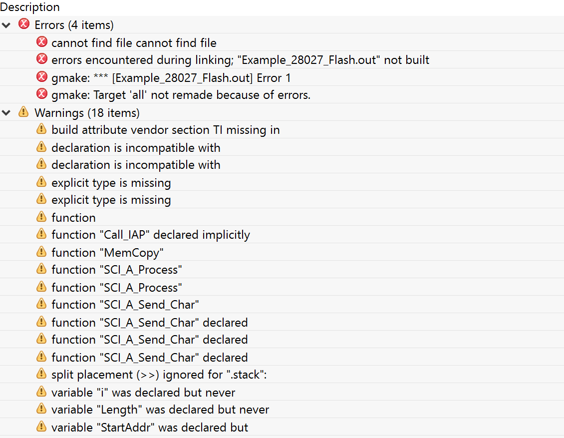

when I immigrate a project from another computer, I encounter a problem. I want to know how to change the configuration to tackle the problem.
the console file looks like:

'Building target: Example_28027_Flash.out'
'Invoking: C2000 Linker'
"C:/ti/ccsv7/tools/compiler/ti-cgt-c2000_16.9.3.LTS/bin/cl2000" -v28 -ml -mt --define=_DEBUG --define=LARGE_MODEL -g --diag_suppress=232 --diag_suppress=10063 --diag_warning=225 --issue_remarks --verbose_diagnostics --quiet --cdebug_asm_data --output_all_syms -z -m"Example_28027_Flash.map" --stack_size=0x300 --warn_sections -i"C:/ti/ccsv7/tools/compiler/ti-cgt-c2000_16.9.3.LTS/lib" -i"C:/software/ti/controlSUITE/libs/utilities/flash_api/2802x/v201a/include" -i"C:/software/ti/controlSUITE/libs/utilities/flash_api/2802x/v201a/lib" -i"C:/ti/ccsv7/tools/compiler/ti-cgt-c2000_16.9.3.LTS/include" -i"C:/ti/controlSUITE/device_support/f2802x/v222/f2802x_examples_structs/flash_f2802x - RAM" -i"C:/ti/controlSUITE/device_support/f2802x/v222/f2802x_common/lib" -i"C:/ti/controlSUITE/libs/math/IQmath/v15c/lib" --reread_libs --issue_remarks --verbose_diagnostics --xml_link_info="Example_28027_Flash_linkInfo.xml" --entry_point=code_start --rom_model -o "Example_28027_Flash.out" "./Call_App.obj" "./DSP2802x_MemCopy.obj" "./Example_2802xSci_Echoback.obj" "./F2802x_GlobalVariableDefs.obj" "./f2802x_codestartbranch.obj" "./f2802x_csmpasswords.obj" "./f2802x_defaultisr.obj" "./f2802x_epwm.obj" "./f2802x_piectrl.obj" "./f2802x_pievect.obj" "./f2802x_sci.obj" "./f2802x_sysctrl.obj" "./f2802x_usdelay.obj" "../F28027.cmd" "../F2802x_Headers_nonBIOS.cmd" "../Flash2802x_API_V201.lib" -lrts2800_ml.lib -l"C:/software/ti/controlSUITE/libs/utilities/flash_api/2802x/v201a/lib/Flash2802x_API_V201.lib" -lIQmath.lib
remark: --cdebug_asm_data is deprecated and will be removed in a subsequent
release.
remark: --output_all_syms is deprecated and will be removed in a subsequent
release. This is now the default behavior of the compiler.
>> Compilation failure
makefile:156: recipe for target 'Example_28027_Flash.out' failed
error: cannot find file
802x_API_V201.lib"

_f2802x - RAM/Flash2802x_API_V201.lib<Flash28_Verify.obj>": compatibility
cannot be determined
warning: build attribute vendor section TI missing in
_f2802x - RAM/Flash2802x_API_V201.lib<Flash28_ClearSector.obj>":
compatibility cannot be determined
_f2802x - RAM/Flash2802x_API_V201.lib<Flash28_CompactSector.obj>":
_f2802x - RAM/Flash2802x_API_V201.lib<Flash28_Delay.obj>": compatibility
_f2802x - RAM/Flash2802x_API_V201.lib<Flash28_DisInt.obj>": compatibility
_f2802x - RAM/Flash2802x_API_V201.lib<Flash28_Erase_Pulse.obj>":
_f2802x - RAM/Flash2802x_API_V201.lib<Flash28_ClearLoop.obj>": compatibility
_f2802x - RAM/Flash2802x_API_V201.lib<Flash28_Compact_Pulse.obj>":
"../F28027.cmd", line 142: warning: split placement (>>) ignored for ".stack":
split run placement for this section is not permitted
.stack : >> RAMM0 | RAMM1 PAGE = 1
error: errors encountered during linking; "Example_28027_Flash.out" not built
gmake: *** [Example_28027_Flash.out] Error 1
gmake: Target 'all' not remade because of errors.
**** Build Finished ****
  • Emma,
    Let us focus on the error first and tackle the warnings later.
    The error reported is this:
    error: cannot find file "C:/software/ti/controlSUITE/libs/utilities/flash_api/2802x/v201a/lib/Flash2802x_API_V201.lib"
    The path to the library (highlighted in bold) is incorrect (it should be c:/ti/controlSUITE/...), which is why it is unable to find the file.
    To fix this, go to Project Properties->Build->Linker->File Search Path and edit/fix the path in the --library option box.
    Although it shouldn't impact this specific linker error, I do see a few incorrect paths under the -i (--search_path) linker option as well, so you should fix those also.
    Let us know if this fixes the error.
