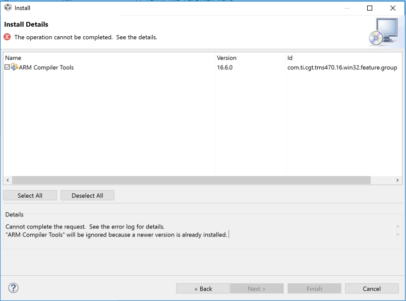

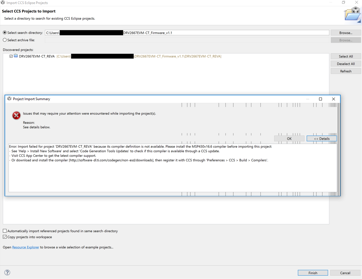

When I try to import one of the projects from TI website (DRV2667EVM-CT firmware to be specific), this is the error I get:
But then when I do try to install that version of compiler, this is the error I get:
Any suggestions, where is the problem? Should I keep trying to install the old version of compiler or is that a firmware code problem?
Thank you,
Marko
See Installing Older Versions for how to work around that error.Marko Grdakovic said:But then when I do try to install that version of compiler, this is the error I get:
