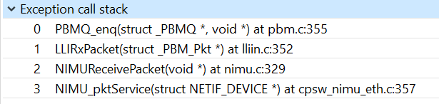

  • Some more information:
    In the RTOS Object View (ROV) -> Exception, i see the following Exception call stack:
    This is the console output this time:
    Exception occurred in ThreadType_Task.
    Task handle: 0x80339630.
    Task stack base: 0x805bd450.
    Task stack size: 0x2000.
    R0 = 0x6000005f R8 = 0x0000000e
    R1 = 0x8033aff4 R9 = 0x80343e80
    R2 = 0x00000000 R10 = 0x00000000
    R3 = 0x0000000a R11 = 0x500610ac
    R4 = 0x8033aff4 R12 = 0x4b5a6978
    R5 = 0x810ce390 SP(R13) = 0x805bf328
    R6 = 0x00000000 LR(R14) = 0x80182154
    R7 = 0x070610ac PC(R15) = 0x80182178
    PSR = 0x200001df
    DFSR = 0x00000a05 IFSR = 0x00000000
    DFAR = 0x00000008 IFAR = 0x00000000
    ti.sysbios.family.arm.exc.Exception: line 205: E_dataAbort: pc = 0x80182178, lr = 0x80182154.
    xdc.runtime.Error.raise: terminating execution.

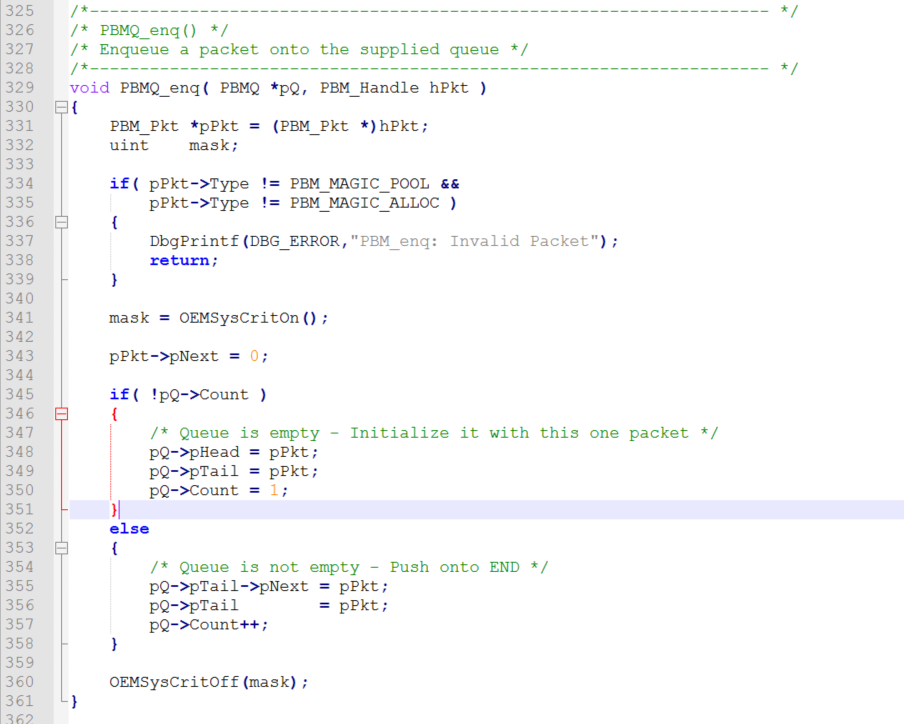

    This is the code at pbm.c, where the exception/error seems to occur:
    Could it be that NIMU is receiving packets when the program is suspended (as it should not), and the list of unhandled packets are filling up? So when resuming the board again, the list is too long, and is trying to point to a section outside of its legal memory section?
    Any tips appreciated,
    Anders.
