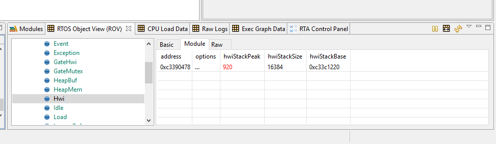

CCS/PROCESSOR-SDK-OMAPL137: While running my code after some time observing Internal exception: IERR=0x9 Instruction fetch exception Opcode exception ti.sysbios.family.c64p.Exception: line 248: E_exceptionMin: pc = 0xc33ae9d0, sp = 0xc33c1338.
Part Number: PROCESSOR-SDK-OMAPL137
Other Parts Discussed in Thread: SYSBIOS
In my code i have added one loop which doesn't do anything in my task function. like below
void task1fxn()
semaphore_pend();
for(j=0;j<25000;j++);
semaphore_post();
If my for loop iteration value is 20000 while running code  didn't see any issue. But if loop iteration value is 25000 facing below error while running the code

Exception at 0xc33ae9d0
EFR=0x2 NRP=0xc33ae9d0
Opcode exception
To see more exception detail, use ROV or set 'ti.sysbios.family.c64p.Exception.enablePrint = true;'
xdc.runtime.Error.raise: terminating execution
can any body help me to resolve this issue? why it misbehaving if i just change the loop iteration value from 20000 to 25000.
