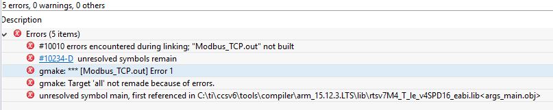

While compiling my program in CCS, I am getting the following error.
"unresolved symbol main, first referenced in C:\ti\ccsv6\tools\compiler\arm_15.12.3.LTS\lib\rtsv7M4_T_le_v4SPD16_eabi.lib<args_main.obj> " .
What to do to resolve this? Please help me to get out of this.

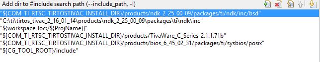

    The include search path in compiler options is given as shown below:

    The error console is as shown below:
    Did I miss any library file? How can I find where the error is? Please guide me to find the cause of error.

  • sandra george78 said:
    I took the tcp echo project from the sample projects and integrated Modbus slave stack on top of it.
    Is there a source file that contains a main() function in your project? In the tcpEcho example, the file tcpEcho.c has a main(). Are you using that file as-is in your project? If you are not, then you need to make sure that there is another source file with a main() function.

  • Hi Aarti,
    Thank you for your reply. In one file main was redefined. It is solved. Thank you for your help.
