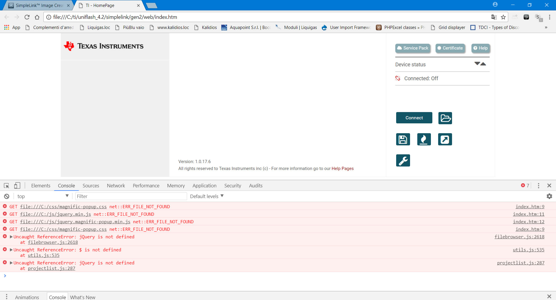

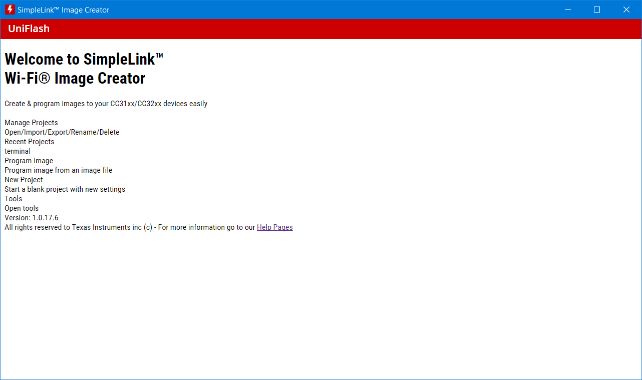

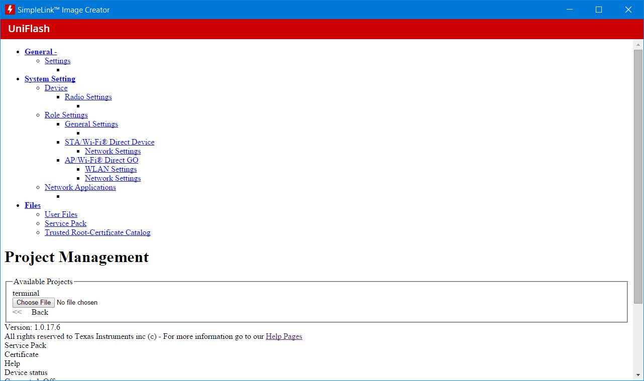

I am tryng to run Uniflash on Widows 10 (I tried version 4.1 and 4.2).
The interface is not displayng correct, aftrer i click "start image creator" - looks like if one or more css are not applied.
Tried to uninstall, clean every file, reinstall more times.
The only screen that displays correctly is the startuo screen and when I import a .ccxml.
The same tool displays nice on another PC with Windows 7.
My Windows 10 build is 14393.1593 (version 1607), 64 bit Italian.
I attach two screen shots for your reference

  • Hello Richy,
    The command opens Chrome. I see the same problem.
    Here is my windows cmd screen after running the commad

    If If open Chrome console, then navigate trough uniflash pages some warnings are reported
    Resource interpreted as Stylesheet but transferred with MIME type application/x-css: "127.0.0.1:7594/.../filebrowser-style.css".
    index.htm:9 Resource interpreted as Stylesheet but transferred with MIME type application/x-css: "127.0.0.1:7594/.../magnific-popup.css".
    Then if I countinue I get numerous Javascript errors of the type
    utils.js:3158 Uncaught TypeError: Cannot read property 'systemFiles' of undefined

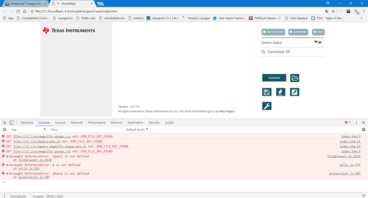

    Can you try opening the index.htm file from \simplelink\gen2\web\ in a text editor, and adding (type="text/css") in the filebrowser-style.css and magnific-popup.css link lines?
    For example:
    <link rel="stylesheet prefetch" type="text/css" href="/css/magnific-popup.css">
    <link rel="stylesheet" type="text/css" href="css/filebrowser-style.css">
    Let me know if this works for you.
    Ricky
  • Done. This does not fix the problem, but if I double click on the html to open it as a file I do not get the warning about filebrowser-style.css and the screen appears similar t wat it should be (see screenshot).
