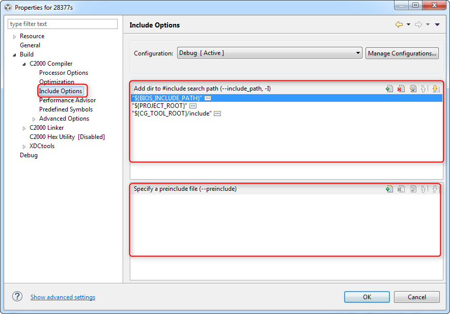

  • Hi Emma,
    When looking at your build output, I see the --preinclude option being used:
    'Building file: ../DSP2802x_MemCopy.c'
    'Invoking: C2000 Compiler'
    "C:/ti/ccsv7/tools/compiler/ti-cgt-c2000_16.9.3.LTS/bin/cl2000" -v28 -ml -mt --include_path="C:/ti/ccsv7/tools/compiler/ti-cgt-c2000_16.9.3.LTS/include" --include_path="C:/ti/controlSUITE/device_support/f2802x/v230" --include_path="C:/ti/controlSUITE/device_support/f2802x/v230/f2802x_headers/include" --include_path="C:/ti/controlSUITE/libs/utilities/flash_api/2802x/v201a/include" --include_path="C:/ti/controlSUITE/device_support/f2802x/v230/f2802x_common/include" --include_path="C:/ti/controlSUITE/device_support/f2802x/v222/f2802x_headers/include" --include_path="C:/ti/controlSUITE/libs/math/IQmath/v15c/include" --preinclude="C:/ti/ccsv7/tools/compiler/ti-cgt-c2000_16.9.3.LTS/include" --preinclude="C:/ti/controlSUITE/libs/math/IQmath/v15c/include" --preinclude="C:/ti/controlSUITE/device_support/f2802x/v230/f2802x_common/include" --preinclude="C:/ti/controlSUITE/device_support/f2802x/v230" --preinclude="C:/ti/controlSUITE/device_support/f2802x/v230/f2802x_headers/include" --preinclude="/packages/ti/xdais" --define=_DEBUG --define=LARGE_MODEL -g --diag_suppress=232 --diag_suppress=10063 --diag_warning=225 --issue_remarks --verbose_diagnostics --quiet --cdebug_asm_data --output_all_syms --preproc_with_compile --preproc_dependency="DSP2802x_MemCopy.d"  "../DSP2802x_MemCopy.c"
    remark: --cdebug_asm_data is deprecated and will be removed in a subsequent
       release.
    remark: --output_all_syms is deprecated and will be removed in a subsequent
       release. This is now the default behavior of the compiler.
    >> Compilation failure
    subdir_rules.mk:16: recipe for target 'DSP2802x_MemCopy.obj' failed
    Fatal error: cannot open source file
              "C:/ti/ccsv7/tools/compiler/ti-cgt-c2000_16.9.3.LTS/include":
              Invalid argument
    The parameters for the --preinclude option look more like include search paths than preinclude files. This would explain the error. Hence I believe that thise paths need to be moved to the --include_path option. Please confirm this.
    The below graphic shows where both options are set.

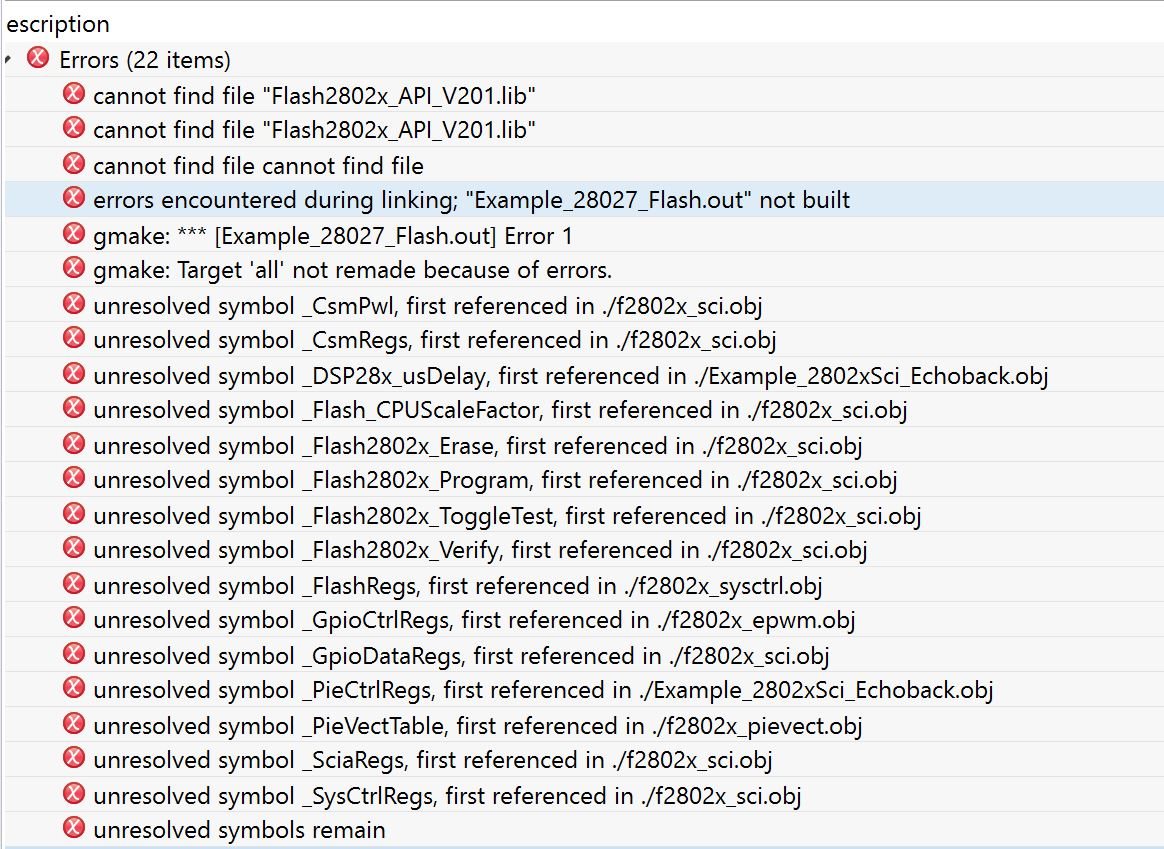

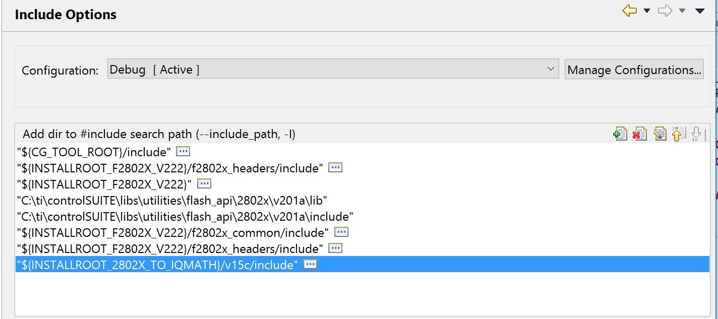

  • your answer solved my problem but I meet other errors.
    I changed the include option like this.
    I want to know the meaning of this expression  "${INSTALLROOT_F2802X_V222}/f2802x_headers/include"
    besides, how to change this "C:\ti\controlSUITE\libs\utilities\flash_api\2802x\v201a\include" into this kind of expression  in include_path option?
    the console file is attached.

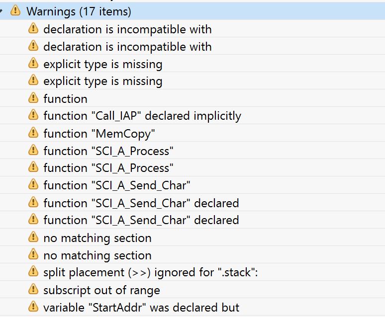

    'Building file: ../Example_2802xSci_Echoback.c'
    "C:/ti/ccsv7/tools/compiler/ti-cgt-c2000_16.9.3.LTS/bin/cl2000" -v28 -ml -mt --include_path="C:/ti/ccsv7/tools/compiler/ti-cgt-c2000_16.9.3.LTS/include" --include_path="C:/ti/controlSUITE/device_support/f2802x/v230/f2802x_headers/include" --include_path="C:/ti/controlSUITE/device_support/f2802x/v230" --include_path="C:/ti/controlSUITE/libs/utilities/flash_api/2802x/v201a/lib" --include_path="C:/ti/controlSUITE/libs/utilities/flash_api/2802x/v201a/include" --include_path="C:/ti/controlSUITE/device_support/f2802x/v230/f2802x_common/include" --include_path="C:/ti/controlSUITE/device_support/f2802x/v230/f2802x_headers/include" --include_path="C:/ti/controlSUITE/libs/math/IQmath/v15c/include" --define=_DEBUG --define=LARGE_MODEL -g --diag_suppress=232 --diag_suppress=10063 --diag_warning=225 --issue_remarks --verbose_diagnostics --quiet --cdebug_asm_data --output_all_syms --preproc_with_compile --preproc_dependency="Example_2802xSci_Echoback.d"  "../Example_2802xSci_Echoback.c"
       release.
    "../Example_2802xSci_Echoback.c", line 16: warning: explicit type is missing
              ("int" assumed)
      extern      Update_Flag;
    "../Example_2802xSci_Echoback.c", line 17: warning: explicit type is missing
              ("int" assumed)
      extern      FW_Burning_Success;
    "../Example_2802xSci_Echoback.c", line 34: warning: function "MemCopy"
              declared implicitly
         MemCopy(&RamfuncsLoadStart,&RamfuncsLoadEnd, &RamfuncsRunStart);
    that path is using a build variable (INSTALLROOT_F2802X_V222) to avoid an absolute path.
    For more information on build variables, see:
    http://processors.wiki.ti.com/index.php/Portable_Projects#Variables_2

    I see a bunch of linker errors. The key ones are:
    >> Compilation failure
    makefile:152: recipe for target 'Example_28027_Flash.out' failed
    "../F28027.cmd", line 128: error: cannot find file "Flash2802x_API_V201.lib"
               -lFlash2802x_API_V201.lib(.econst)
    "../F28027.cmd", line 129: error: cannot find file "Flash2802x_API_V201.lib"
            -lFlash2802x_API_V201.lib(.text)
       "C:/software/ti/controlSUITE/libs/utilities/flash_api/2802x/v201a/lib/Flash2
       802x_API_V201.lib"
    "../F28027.cmd", line 128: warning: no matching section
    "../F28027.cmd", line 129: warning: no matching section
    note this path:
    Is that correct? In your message above, it looks like you have controlSUITE in C:\ti\controlSUITE. If you inherited this cmd file from somewhere else, you need to modify it to match you environment.
    ki
