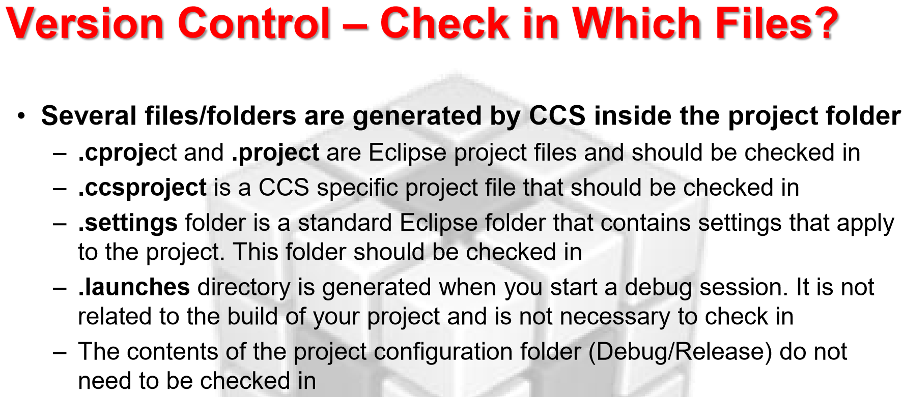

2. what's version control, I've never checked .cproject, .project, .ccsproject file before because I cannot open these files, what should I check about these files?
    Version Control is usually some system than manages changes to documents/source. Examples are things like Git, CVS, SVN, ClearCase, SourceSafe, etc. The term "Check in" is a term from such software and refers to an action when you add a file to the version control system to be managed.
