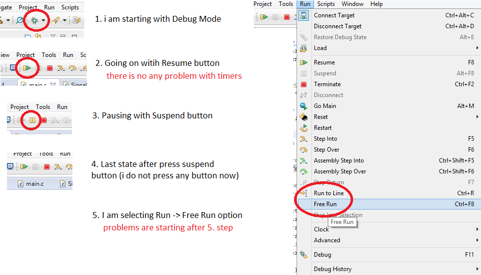

I am working on a project that i use cc430. i have a problem when i using debug mode in code composer studio. The problem is happening that ways;

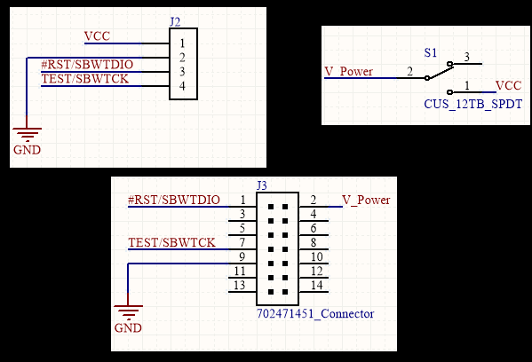

I am using MSP-FETFlash Emulation Tool and programming my device using ccs in debug mode. my device has a battery and FET's Target VCC is OFF. it's all okay. my timers are  working without any problems.
After this time i pausing the device and going on with Free Run mode. i get wrong result from timers in Free Run Mode. There are NOT differents in codes. I am getting also same issue when i run device with using battery.

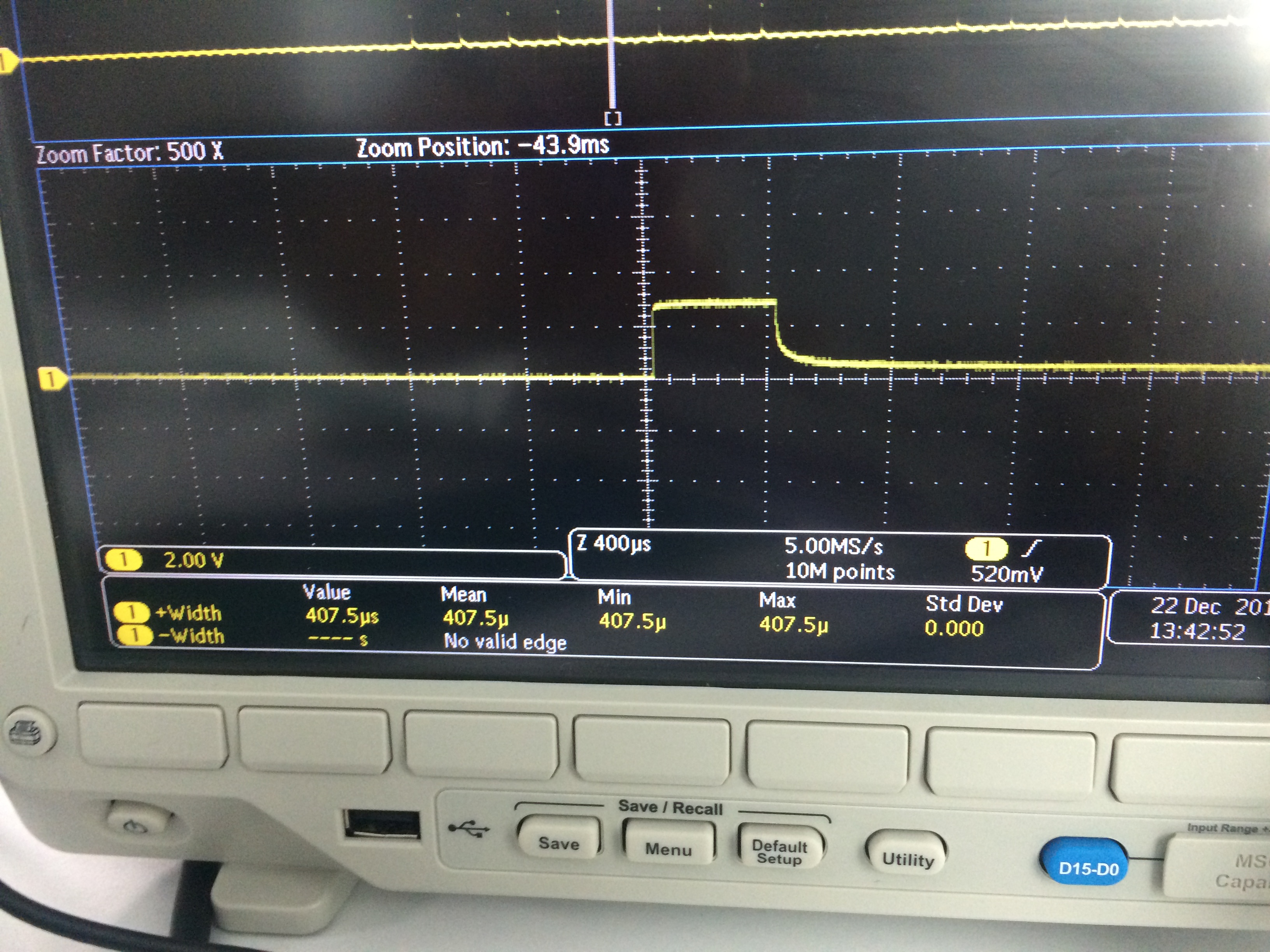

I am adding 2 photo of this issue. It shoud be 400us but i get 560us in Free Run Mode.
(Free Run Mode or with Battery) 560us photo is here.
Please inform me about this issue.
