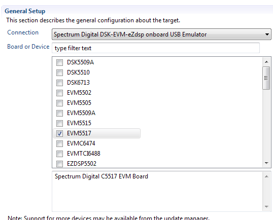

    1) Could you try to change the emulator to below?
    2) Has this EVM worked previously where you were able to run other examples?
    3) Do you have another emulator that you can try such as a Spectrum Digital XDS200 to plug into J8?

  • Hi Sharad,
    Sorry for the confusion.
    The JTAG issue was caused by the on-board demo which is in the SPI flash. looks like the current BOOTMODE (SW-3) was set for the SPI boot. To solve this problem, we need to disable the SPI boot (therefore stop the on-board demo). To change the BOOTMODE to UART boot will stop the SPI boot and put the DSP in the waiting mode, so that the JTAG can be connectted.
    The factory default C5517 EVM boot mode setting is for SPI flash boot. I am not sure where did you get the C5517 EVM. If you recently purchased it, then it should be the factory default setting.
    For the CCXML file, you can use the c55_csl\c55xx_csl\build\C5517EVM_Onboard_Emulator.ccxml, if you installed the C55XCSL 3.07.00
    Ming

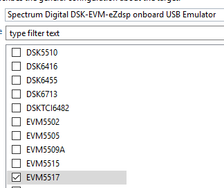

  • Hi Sharad,
    By the way, the C5517 EVM is using XDS-510 on board emulator (not XDS-100). You should use "Spectrum Digital DSK-EVM-eZdsp onboard USB Emulator" like Lali suggested before.
    You can also use the one included in the C55XCSL 3.07.00 (c55_csl\c55xx_csl\build\C5517EVM_Onboard_Emulator.ccxml)
    Ming

  • Sharad,
    There's definitely a discrepancy regarding the emulator in the documentation that needs to be addressed, and we are looking into fixing it.
    Have you tried "Spectrum Digital DSK-EVM-eZdsp onboard USB Emulator" as the emulator option as below? Just wanted to confirm.
  • Following up on an offline conversation. The board connectivity issue has been resolved.
    The correct emulator to use in CCS is "Spectrum Digital DSK-EVM-eZdsp onboard USB Emulator" for EVM5517. The documentation will be fixed to reflect this and avoid any confusion.
