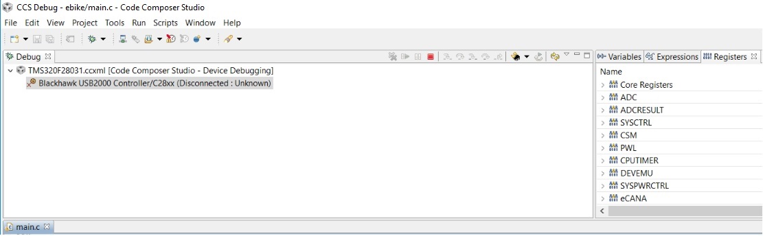

I am trying to use BlackHawk USB2000 emulator to debug the code on processor (28031) having issues in launching the debug session. It does pass the communication test and when I try to launch the debug session the code composer just hangs there and stays there in launching point for hours and hours.
 I am using Code composer studio 5.5.0.00077 and BlackHawk USB 2000 controller (BH-USB-2000). I have also tried uninstalling the code composer studio and fresh installation with fresh workspace  but still same result.
Any help is appreciated.

    When I run the debugger, it shows as the BlackHawk USB2000 controller (disconnected state) see attached picture. If I right click and select connect device it just hangs at that point and doesn't do for hours. I have to unplug the usb connection to get it to response again.

  • Can you also try lowering your TCLK speed to legacy 10.368?
    www.youtube.com/watch
    ki
  • 0334.Newlog.log
    generated the log file again with the TCLK at 10.368. Its still responding in the same way.
    It worked couple of times today and I was able to launch the debug session couple of times. I power the processor and now it is doing the same thing as before. It just hangs in the launch process. There was no change done before or after the power cycle.
