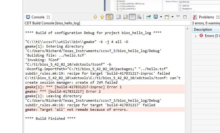

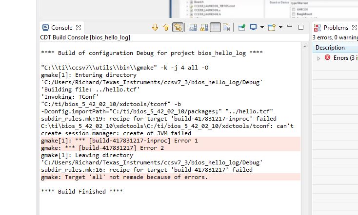

and hey presto, it fails to build with...
subdir_rules.mk:14: recipe for target 'build-1656349521' failed
C:\ti\bios_5_42_02_10\xdctools\C:/ti/bios_5_42_02_10/xdctools/tconf: can't create session manager: create of JVM failed
I have no idea where to start on fixing this error. But it seems to me that something else probably needs installing.

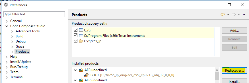

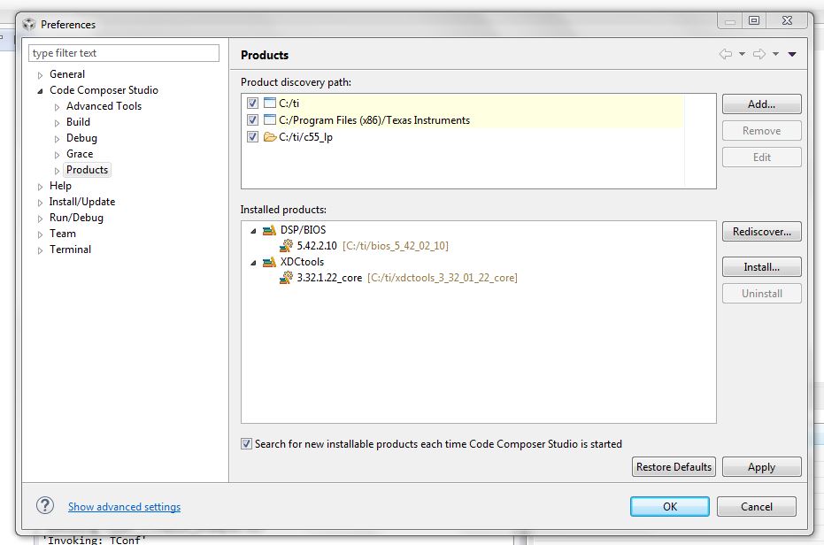

  • Rich,
    Do you have the relevant packages needed to build the project registered with CCS?
    Window>Preferences
    Lali
  • Hi Lali,
    I have installed TMS320C55XXCSL-LOWPWR-03.07.00.01 so now my PREFERENCES looks like this...

    ...and guess what ? I get EXACTLY THE SAME ERROR!
    This isn't a surprise to me because the problem isn't with CCS is it ?  IT'S WITH DSP/BIOS 5.42.02.10. Specifically with "tconf" not executing correctly i.e. something in the hello.tcf is throwing it (or other such fault).

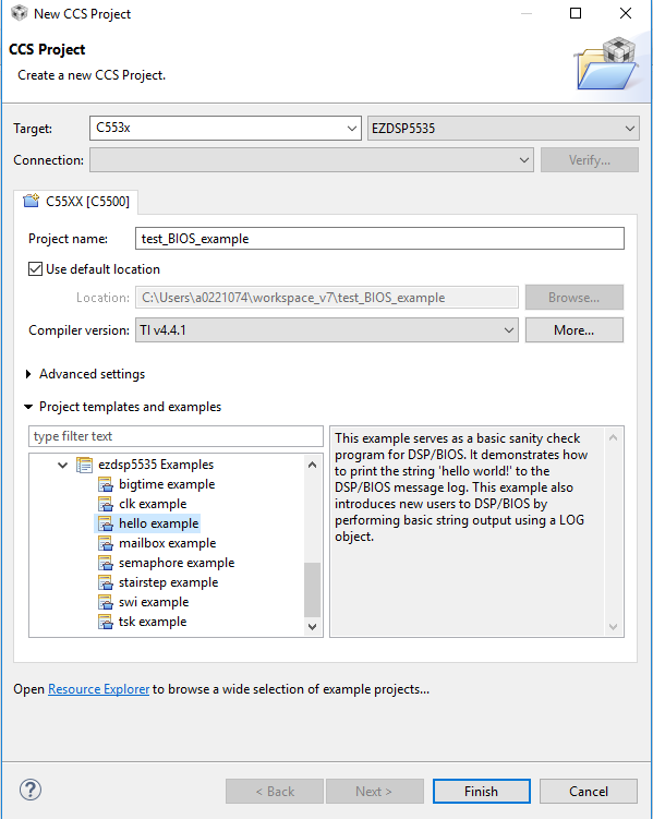

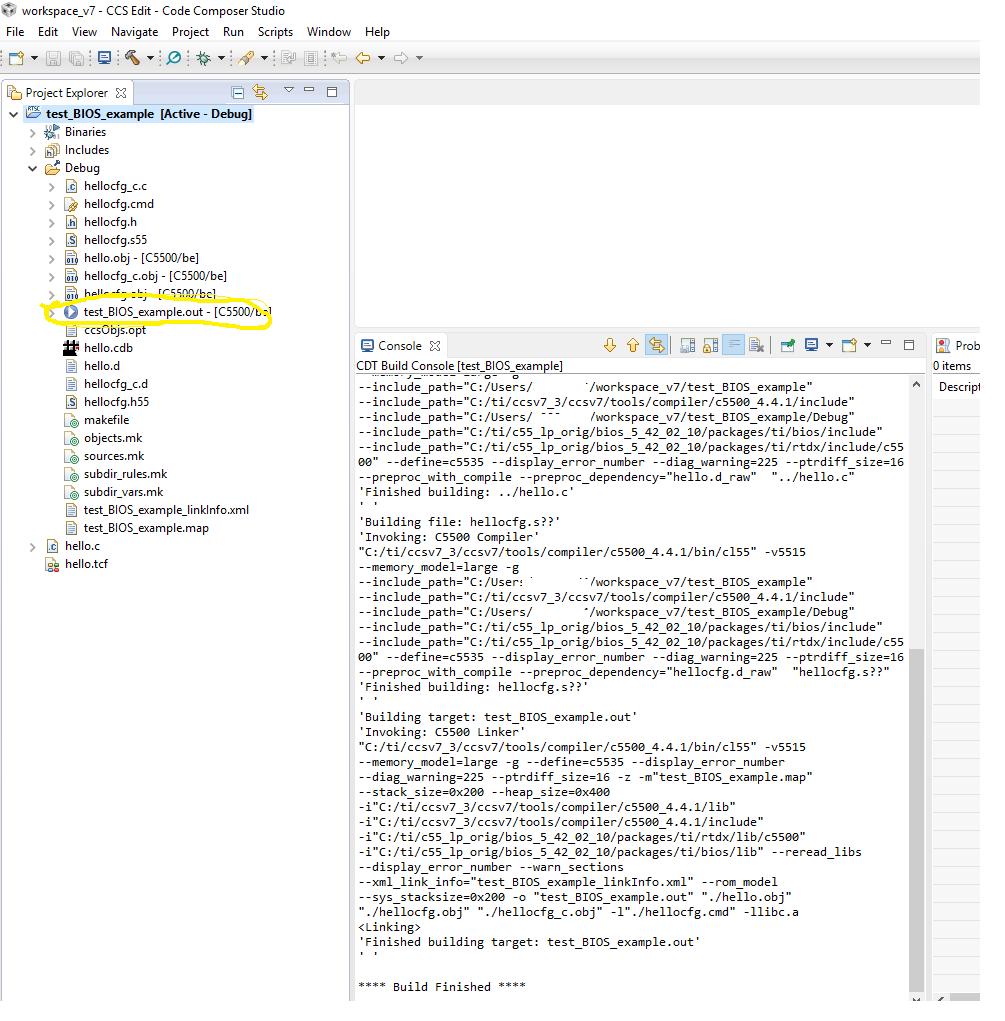

    I tried this on a fresh installation of CCS v7.3 and added the compiler manually. Then, created the example by DSP/BIOS v5xx Examples / ezdsp5535 Examples / hello example. See the screenshots below and the successful compilation. Hope this resolves your issues.

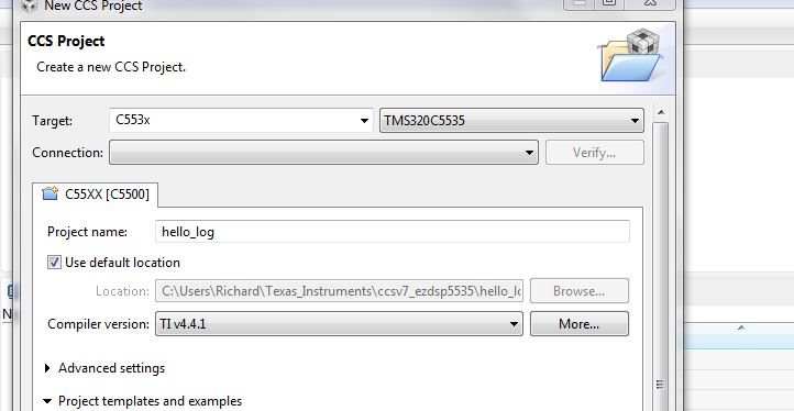

  • Okay Lali, now we're getting somewhere.
    I already have the c55x compiler installed (v4.4.1) installed, but here's the thing, when I try to create the project I can't see the EZDSP5535 device option in the Target dropdown. The closest device target option is the TMS320C5535 see the following screen-shot...
    So, what else am I missing, or hasn't been installed ?
    Best ,Rich.

  • Hi Lali,
    Still no joy ! I'm at my wits end. I re-installed CCSv7 (for C5000 devices only), and the C5500 compiler, and DSP/BIOS 5.42.2.10. I can now see the EZDSP5535 target but, I still get the following...
    ...I really could do with someone to tell me precisely what's going wrong here. Whether it's with my installation, or... I don't know what.

    Thank you for your previous post and the link with it. The "https://e2e.ti.com/support/embedded/tirtos/f/355/t/422003" forum exactly matches the problem that I'm seeing.
    So appending
    C:\ti\bios_5_42_01_09\xdctools\jre\bin to your System PATH variable resolved the issue.
    Your Path should look like the following
    C:\ti\bios_5_42_01_09\xdctools\jre\bin;C:\ti\bios_5_42_01_09\xdctools;<Rest of your PATH variable>
    doesn't solve my problem !! (I was convinced it would). In fact I have two copies of the MSVCR71.dll in my ti installation.

  • Fixed it!
    It helps if I put the precise system PATH strings in place...
    C:\ti\bios_5_42_02_10\xdctools\jre\bin;C:\ti\bios_5_42_02_10\xdctools;%PATH%
    I feel a bit silly now.
