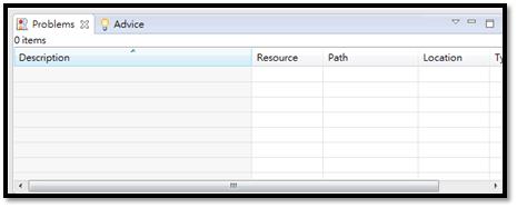

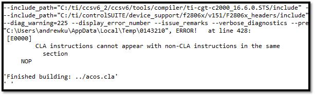

  • George,
    Please see the attached figures below.
    It seems the errors only occur in the console rather than the "Problems" window as errors or warnings.
    Is my understanding correct?
    If so, would you please modify it to show errors directly on the "Problems" window as well?
    Wayne
  • I filed CCDSK-2959 in the SDOWP system to have this addressed.  You are welcome to follow it with the SDOWP link below in my signature.
