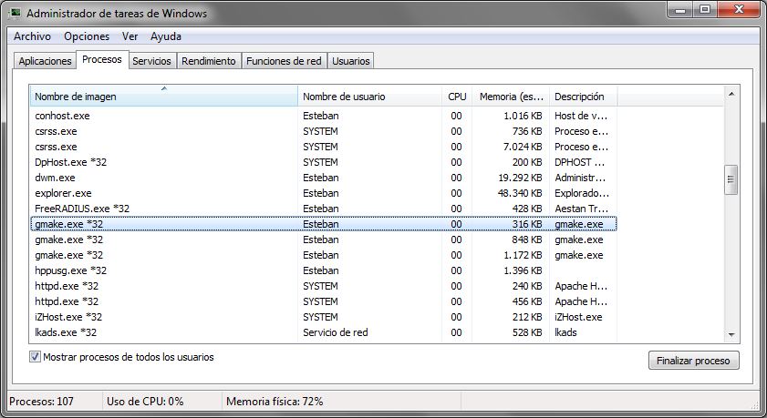

    When I was trying to delete project folder after close CCS, Windows Explorer doesn't allow me to do it, I open Task Manager and I founded 3 instances of gmake running. I'm not sure if this is helpfull, Just in case I share it.
    In conclusion, the problem persists. What else could I check?

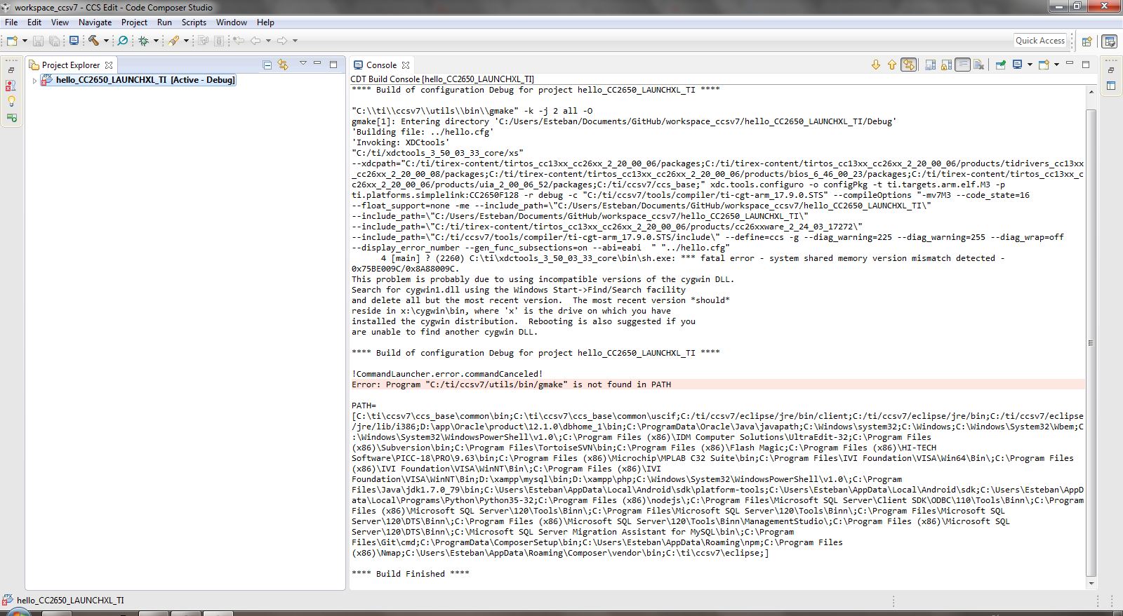

  • I'm in trouble again.
    I tried to modify a semaphore instanstiated by XGCONF and building stopped working again. But now it stoped working at 1%, intead 25%.
    I tried to repeat the actions that solved my problem before:
    -Clean workspace
    -Download an Example from Resource Explorer (HelloWorldExample)
    -Build it
    But this time, this is not solving my issue.
    The problem is presented in CCSv6 and CCSv7 in the same way and in both cases it appeared after using the XGCONF tool.
    What is going on? I need help please!
  • Now, when I tried to build, it gets stucked at 1% of process progress, and console output says:
    And after cancel the process:
    Anybody has an idea why is this happening and how could I solve once for all?
