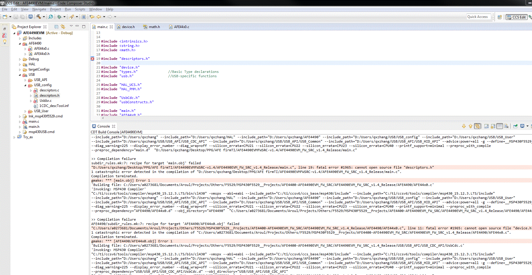

I just received the EVM board and trying to use CCS to load firmware, downloaded from TI web.
But when I include the project, and build it, it always show missing files, as following snapshot.
For example, missing 'descriptors.h' is actually in USB/USB_config.
Thank you!
Jackie
  • This part of the compiler has worked the same way for a very long time.  It is unlikely to be in error.
    The directory searched is D:/Users/qxzhang/USB/USB_config.  Please carefully check again.
