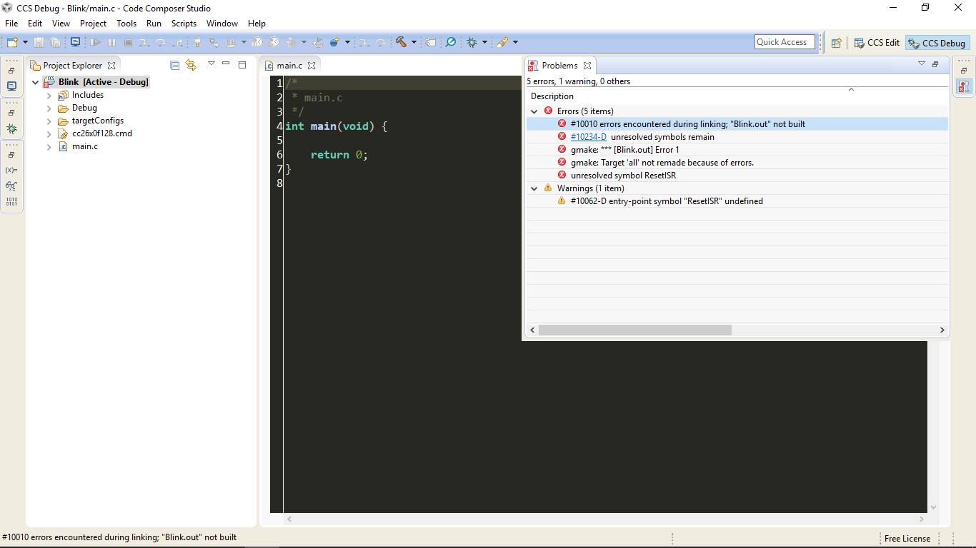

I wanted to create a new empty project with a main.c file as shown in the first picture. However, after the project is successfully created I build it without adding or modifying anything; as a result, I got a bunch of errors that can be seen in the second picture. I have been testing the examples that CCS provides for the CC2650 LaunchPad, and so far everything has worked. I don't like understand what I am missing.
Please see Aarti's post in the thread below (same goes for CC2650):
https://e2e.ti.com/support/development_tools/code_composer_studio/f/81/p/577584/2120877#2120877
Hence it is best to start with one of the simplelink SDK examples as a template.
