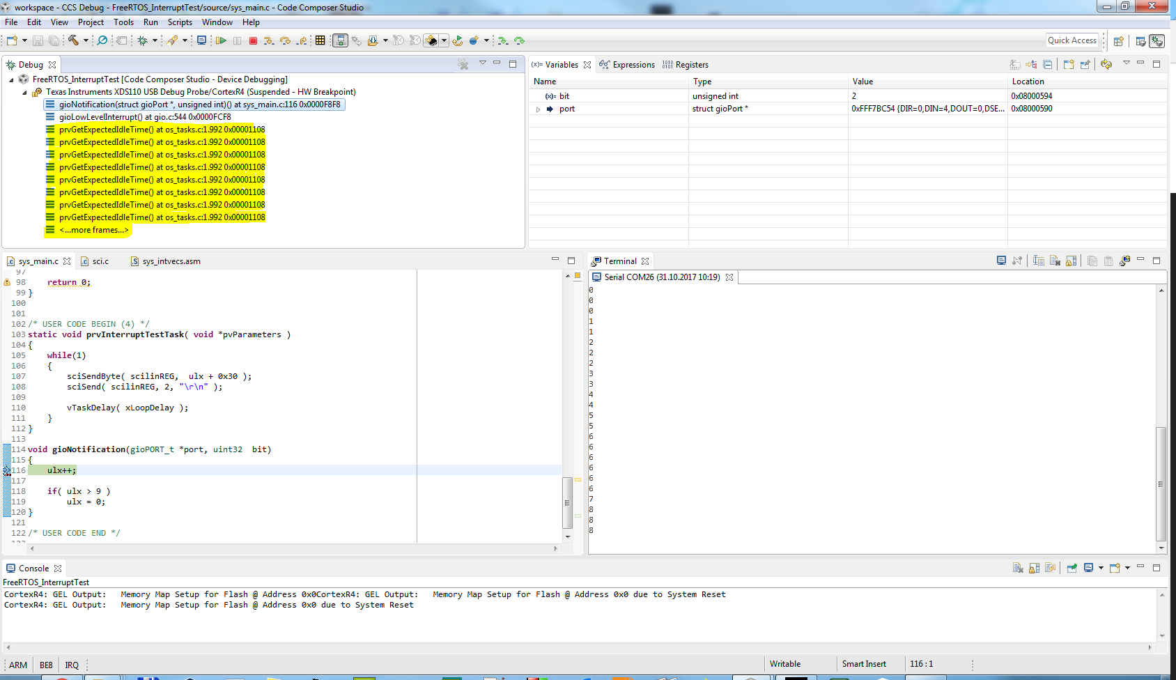

I have a problem when debugging in Code Composer Version: 7.2.0.00013. I generated code with FreeRTOS support using Halcogen. I created a free rtos task sending 1 byte periodically using sci api. Byte sent by the task is manipulated in an ISR triggered form GIOB[2] pin connected to User Switch A on LAUNCHXL2-TMS57012. While debugging in ISR sometimes call stack is filled with frames pointing to same address. Below image illustrates that case. When I click <...more frames...>, I see more of them and it looks like an infinitely long list of the same frame.

This is my first time using interrupts with freertos tasks. Is there anything wrong with my code or there is really an issue at the compiler side?
Murat
  • I apologize for the delay.  This issue has been getting some internal discussion among various experts.
    Please attach the executable .out file to your next post.  Since that file extension is not accepted on the forum, please compress it into a .zip file first.
