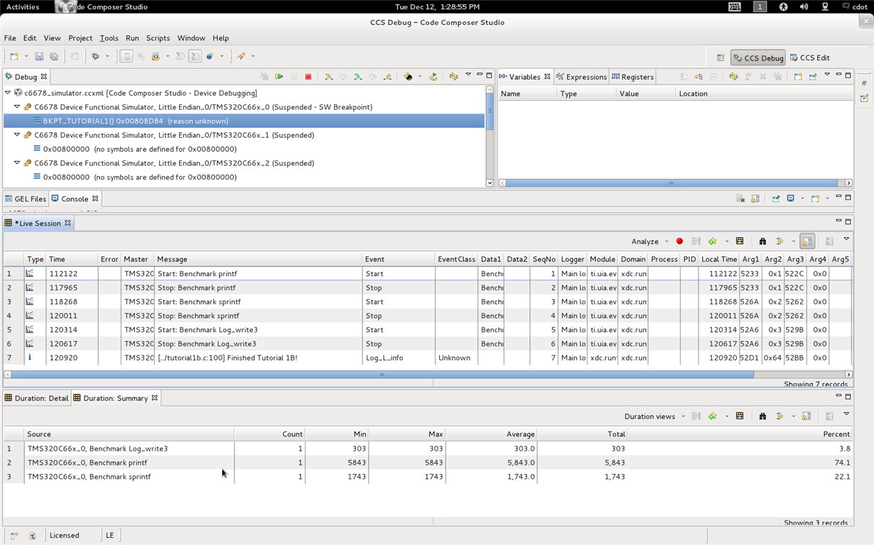

Hello! I have problem when I execute Tutorial1b on c6678 simmulator . Duration : Summary window is empty but there are information in Live Session window .

GK REDDY said:Please use UIABenchmark_start/UIABenchmark_stop events instead of using UIABenchmark_startInstanceWithStr/UIABenchmark_stoptInstanceWithStr.
You can see the duration analysis with these events
This worked for me too. Thank you for sharing the solution!
Looks like we need to update those tutorials.
