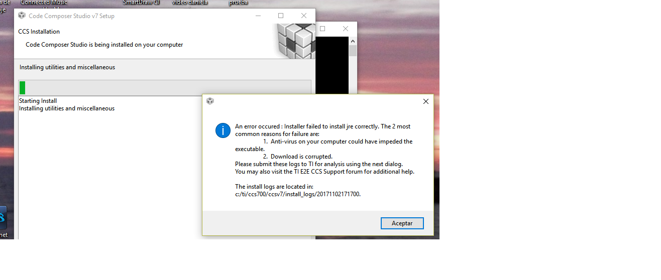

  • Hello John
    I solved my problem, about the start of execution the install CCS, with your advices. Tanks a lot.
    But now I have another issue that avoids install CCS. I send file with message and install_logs.
    In adition I uninstalled in permanent way the windows defender.

    11/02/2017 22:43:26(GMT) - checkStatus - CCS_ERROR: Installer failed to install jre correctly. The 2 most common reasons for failure are:
    	1.  Anti-virus on your computer could have impeded the executable.
    	2.  Download is corrupted.
    Please submit these logs to TI for analysis using the next dialog.
    You may also visit the TI E2E CCS Support forum for additional help.
    The install logs are located in: c:/ti/ccsv7/install_logs/20171102163949.
