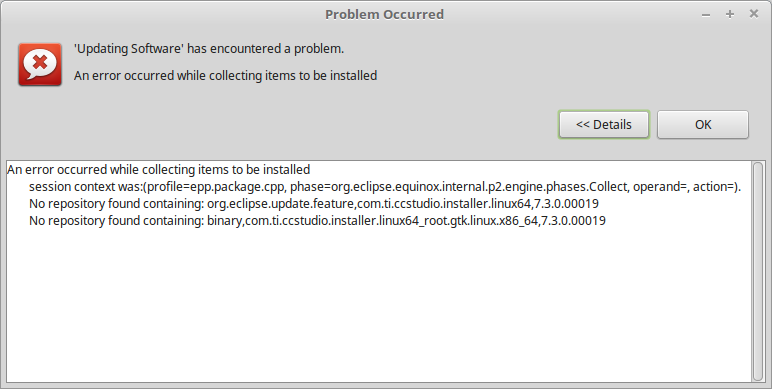

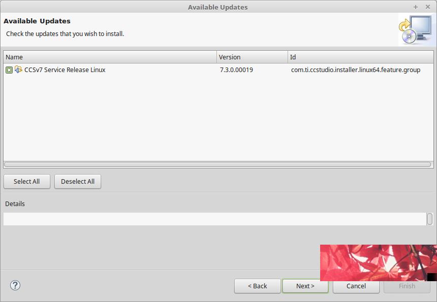

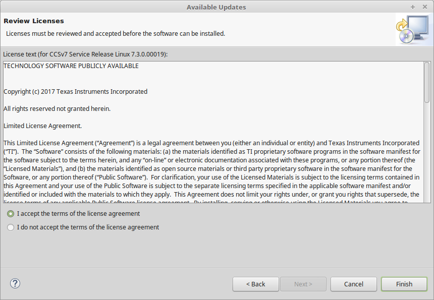

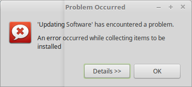

I am attempting to upgrade CCS 7.2.0 to 7.3.0 but it has failed.
Here are a few screen shots:
This is my version of Linux:

Am I running into a file permissions issue here?
Should I grab the offline installer and reinstall?
    We were having issues with the 7.2 -> 7.3 update so we deactivated it... or at least we thought so.
    If you want to use 7.3.0, you will have to do a full install to a new directory from scratch. Sorry for the inconvenience
