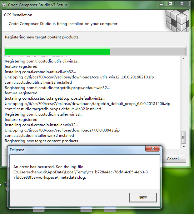

    When i was trying to  install CCS to an empty folder, the progress bar stopped at middle place and informed below.it complete installing immediately if i click yes.
    than the programe show below :

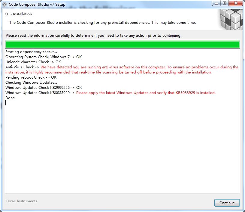

    and before install, setup software show these messages:

  • Hi ki:
    The vision of IAR for ARM is 8.20. IAR always  installed succeed ,But i double click the icon , it informed something wrong with file  msvcp140.dll.
    thank you very much.
    CCS will not work if the latest Windows updates are not applied. Please verify that you have the required Updates installed (see screenshot above).
    Danish
  • Hi danishinnis,
    We'd applied all necessary windows update. But the issue still exists. Please find below screen shot and log!
    Please extend your support! It's pending for months. Thanks!

  • Danishinnis,
    Could you help advise? We local can not find much information in the log. Thanks!
  • Hi Louis,
    It looks like one of the redistributables is not installing correctly on your machine. Can you please:
    Save the attached file as .exe
    Double click on it to run it.
    Follow the prompts and report any errors.
    If no errors, please delete the contents of your installation folder and retry the installer.
    Danishvc_redist.x86_14.0.24212.txt
