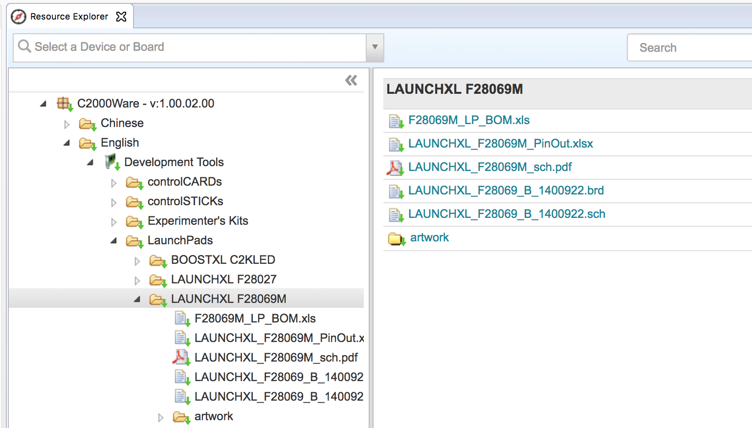

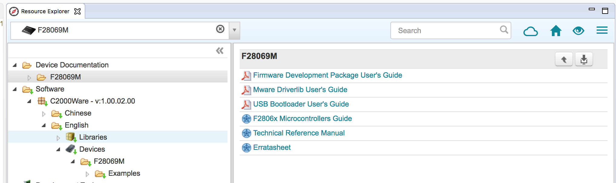

    At this time the F28069M LaunchPad is not available as a top level filter in Resource Explorer.  It isn't that content is not present for the LaunchPad it is just that the content doesn't have all the tagging to associate it with the LaunchPad.  I can check with the C2000Ware team to see what the plans are there.  If you set the filter to the F28069M device the examples show up under C2000Ware.  However the files for the LaunchPad (schematic, pinout...) do not.  If you need to access those files I would not use the filter and would just browse to them.
    Here is the device documentation and examples with the device filter set:
    Here are the LaunchPad materials:
    C2000Ware is pretty new to being integrated with the new Resource Explorer (vs Resource Explorer Classic), so I would expect the integration to improve over time.
