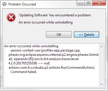

I got the following problem with updating CCS :

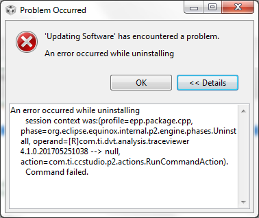

At the end I got this error message:
Can someone please tell me how to solve this.

  • We found there was problem where the 3rd party content delivery provider's data was out of sync with our local data. This issue has been corrected.
    Could you retry this operation? The error message reported above looked like it might have been unrelated so we may still have something to investigate.
    I just installed both C2800 and ARM 16.9.6 compilers on my CCSv7.2.0 without issues.

  • I suspected the sync issue was not going to resolve this.
    Would you be able to exit CCS, then download and run the attached "installer".  While it looks like an installer, all it does is patch some of the existing installation scripts that get run when you try to install an update. We are suspecting that a sequence of dependencies in your installs causes this problem. The patch relaxes those dependencies.
    The installer asks for the install location of CCS and defaults to c:\ti.  If you have installed in a different folder, you can point it to that folder.
    After running the patch, please retry the update and let us know how it goes.
    https://e2e.ti.com/cfs-file/__key/communityserver-discussions-components-files/81/UpdateTest_2D00_1.0_2D00_windows_2D00_installer.exe

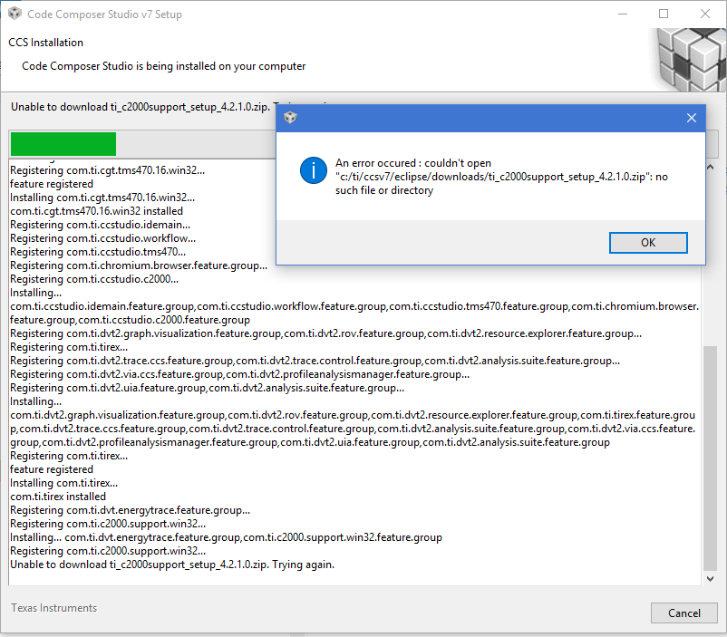

  • Dear all,

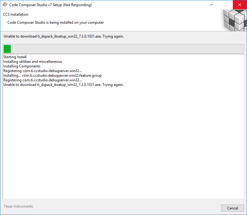

    Same issue over here, the suggested batch doesn't help. It now can go on with the updater but gets stuck while trying to download "ti_dspack_ibsetup_win32_7.3.0.1031.exe". Below the screenshot of the installation. The window is not responding anymore at this point.
  • Re-Opening Code Composer after forced exit of updater window and requesting updates once more results in first: "No updates found" and at the same time an error message "No repository found at software-dl.ti.com/.../."
  • I got the flowing error from windows:
    The program can not be started because COMCTL32.DLL is missing on your computer. You may be able to resolve this problem by reinstalling the program. (only in an other languages)
    I got COMCTL32.dll 20 times on my PC.
    Maybe compress the file. Because of firewalls.

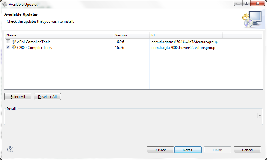

  • On My Side, I installed your provide patch then the two update Compiler C2800 are ok now.
    When I click on "Check For update" the two error message you said bellow was appeared.
    So i restart CCS and now it indicate (No Updates were found in available software sites".
    This Is Ok,

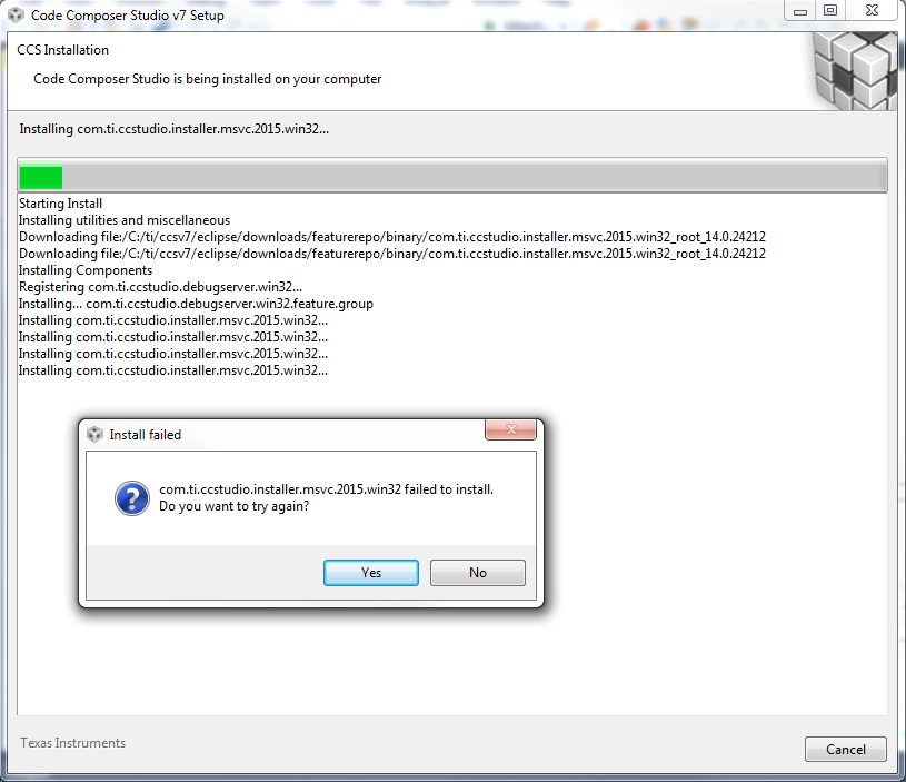

  • I tried running the UpdateTest-1.0-windows-installer.exe, then restarted CCS to perform an update. Now I am getting the following issue where com.ti.ccstudio.installer.msvc.2015.win32 fails to install!
  • The CCS installer also includes and runs the Visual Studio 2015 redistributable installer from Microsoft. For some reason this redistributable installer is failing. This can be run by itself to better see what it is having trouble with.
    You can get the same executable from Microsoft, or I've also made it available here.  Please run this installer. If it offers to repair your installation, please allow it to do so. After this has successfully installed, what does the update do?
