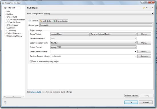

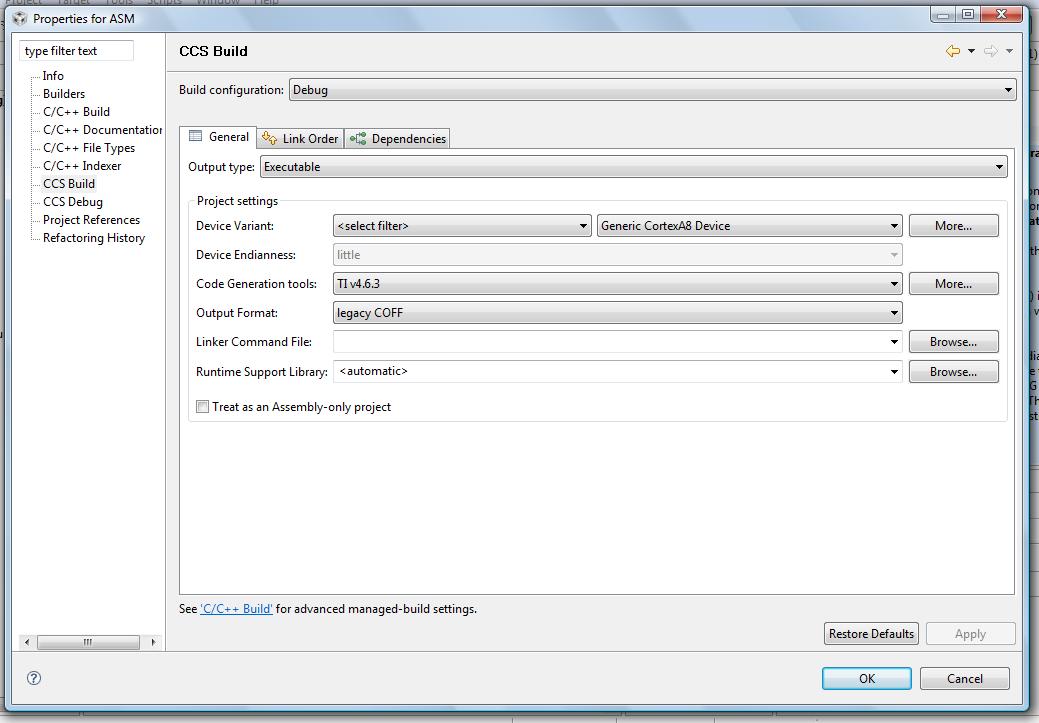

I'm trying to compile C/ASM mixed code (spnu151e.pdf, page 126) with 4.6.3 CGT in Code Composer Studio.
There is the test project (for ARM core in Beagleboard):

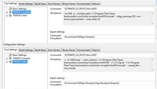

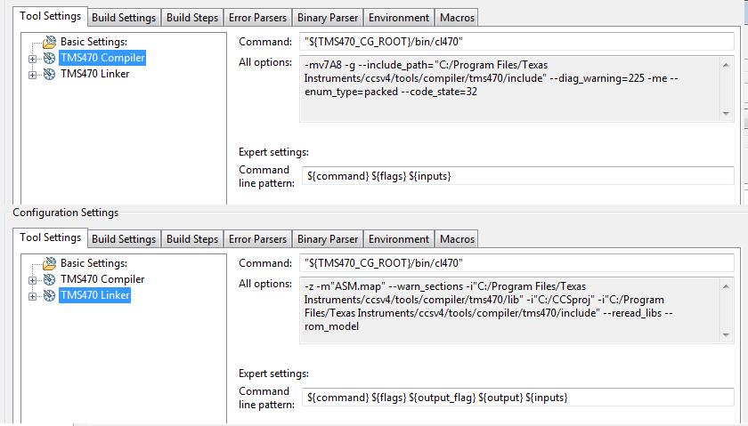

Compiler didn't understand "extern "C" directive (in main.c) and gvar_a symbol (in test.asm).
Could you give me some advices how to link .asm procedure with C/C++ code in CCS 4.1 IDE?
