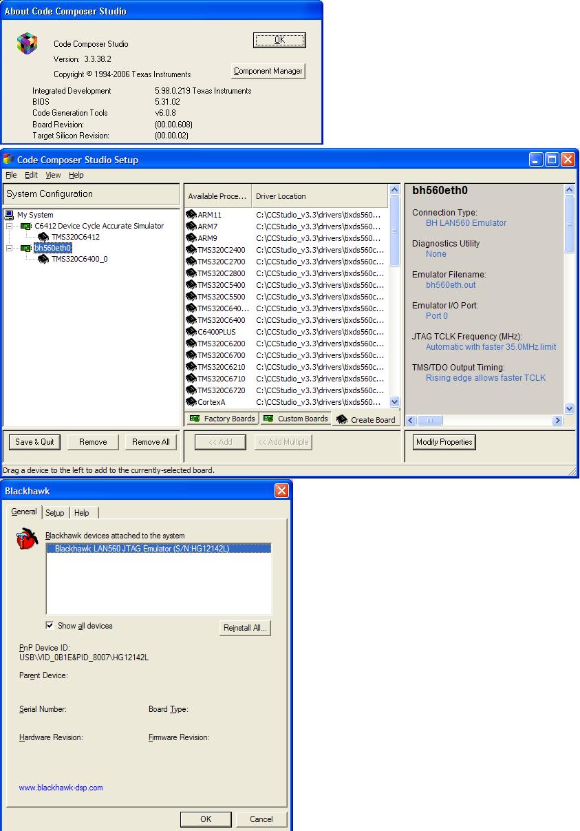

  • What's the complete version number (all digits) for CCS shown in the Help -> About dialog?  Also, what version of the Blackhawk emulation drivers did you install?  Can you post a screenshot of cc_setup?
  • Thanks Brad, Please find the attached screen shots, I was not able to get the versions of the BH driver, the BH control panel didn't show it.
    I got a hardware designer to probe some of the clocks and read some registers, the register DEVSTAT, 0x01B3F004 has its AECLKINSEL1,0(EMIF input clk select) with value 0b11 which is "reserved". Is this normal? Could this be an indication of some issue?
    Many thanks,
    Terry
  • I think the main issue here is that you are using the initial release of CCS 3.3.  In other words, we had 12 service releases to fix bugs but you are not using them!  The service releases are "all inclusive" so you only need to install SR12 (i.e. skip 1-11).
    Once you've done that go to the Blackhawk website:
    http://www.blackhawk-dsp.com/support/Drivers33.aspx
    Download and install the drivers meant for CCS 3.3 SR12 (i.e. BH Release 3.3.300.3).
    The AECLKINSEL value is set by the state of pins AEA[20:19] when reset is released so you must have the wrong termination or else something opposing that termination such as an external device connected to the EMIF.  That's not good that you're in a reserved state, but I doubt that's the issue especially since you see the issue with internal RAM.  I would guess this is a straight-up CCS bug that has been resolved in one of the many service releases.
    Brad

  • Is this on the EVM or your own custom hardware?  Looking at your screenshots I see all F's in your memory so I would guess you have an empty flash and are doing the EMIF boot.  That said, it can cause the device to come up in an unstable state.  Can you try switching to the host boot mode?  I *think* you can still connect in that boot mode and it will prevent the DSP from running "into the weeds" because it will keep the DSP stalled.
    Also, as a sanity check please do Help -> About in CCS and verify you have version 3.3.82.13 which corresponds to CCS 3.3 SR12.  It's critical that you match up the correct version of CCS to the correct version of the emulator.
    One other test... In the directory where you installed the Blackhawk drivers should be a Utility directory and then a BHProbe.2 directory.  Inside this directory you'll find the files called BHreset_LAN560.bat and BHprobe_LAN560.bat.  Try doing the reset and try doing the probe and see if those work.  That will do a lower-level scan.  Perhaps attach your log back to the forum.
  • Hi Brad and Ki,
    It is a custom board, C6412 is used in our other product line (telecom testset) at the moment, this board is a new product, but the DSP has no difference in terms of clocks, pci, emif and other connections and settings.
    The boot mode pins on the board are now 0b00. Is this the host mode? The ccs acts the same after bootmode change.
    Please find attached help version screen shot and logs for the BHprobe.

    TEST 4 - DATA
      BHProbe 5.02: Blackhawk LAN560 JTAG Emulator
    Tue 09/14/2010-16:54:51.53
    bin\XDSProbe.exe -v -F BH560ETH.out -p0x0 -g -o log\BHprobe_LAN560.log
    -----[Print the controller-open software log-file]---------------------------
    This utility has selected an XDS560 class product.
    This utility will load the program 'BH560ETH.out'.
    This utility will operate on port address '0'.
    The controller does use a programmable FPGA.
    The emulator program is named 'BH560ETH.out'.
    The emulator program is version '35.24.0.3'.
    The controller has a version number of '4' (0x0004).
    The controller has an insertion length of '0' (0x0000).
    The cable+pod has a version number of '6' (0x0006).
    The cable+pod has a capability number of '8' (0x0008).
    The local memory has a base address of '0' (0x000000).
    The local memory has a word capacity of '32768' (0x008000).
    -----[Perform the standard path-length test on the JTAG IR and DR]-----------
    This path-length test uses blocks of 512 32-bit words.
    The test for the JTAG IR instruction path-length succeeded.
    The JTAG IR instruction path-length is 38 bits.
    The test for the JTAG DR bypass path-length succeeded.
    The JTAG DR bypass path-length is 1 bits.
    -----[Perform the Given Data scan-test on the JTAG IR]-----------------------
    This test will use blocks of 512 32-bit words.
    This test will be applied just once.
    It uses the first 1 of the 10 different test-cases.
    Do a test using 0x5533CCAA.
    Scan tests: 1, skipped: 0, failed: 0
    All of the values were scanned correctly.
    The JTAG IR Given Data scan-test has succeeded.
    -----[Perform the Given Data scan-test on the JTAG DR]-----------------------
    The JTAG DR Given Data scan-test has succeeded.
    Done.
