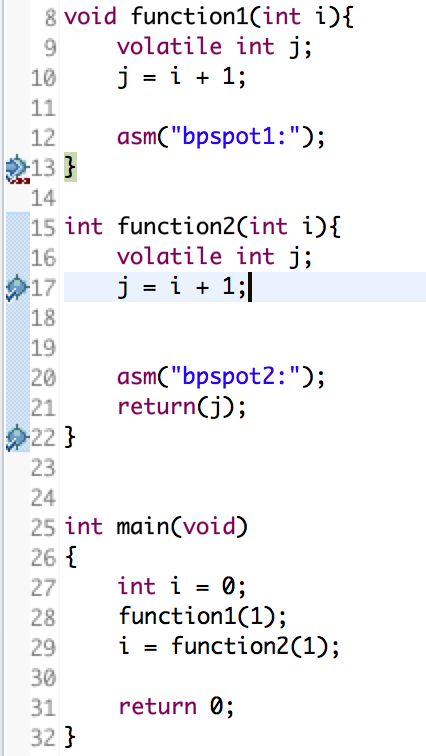

  • Subash,
    What if you add an asm() statement that just sets a label.  i.e. something like this:
    You that should ensure that there is the ability to set the BP at the end of the function.  Alternatively you could even set the BP on the label.
    John
