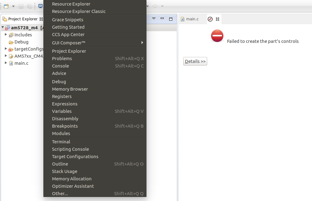

I don't have the menu entry Resource Explorer (Examples):
Also, if I open any of the other two Resource Explorers, they show a tab with the crashed plugin.
How do I get the the RTOS Example in CCS?
Lo2
  • Lo2,
    The examples would appear under Resource Explorer Classic. The Processor SDK examples have not been integrated into the newer Resource Explorer but they would appear in the "Classic" version that scans through software packages to find examples.

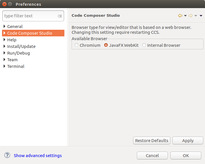

    You may be able to work around this issue by switching the browser that CCS is using for Resource Explorer. If you go to the Window menu and select Preferences. Then select Code Composer Studio on the left. On the right will be some options for the browser. Try the middle one and restart CCS.
    IF the error still happens can you click on the details button to show more information.
    John
  • Hi John,
    I selected the JavaFX Browser as you described and restarted CCSv7. Now it crashes because I probably have a navigator tab open:

  • Hi John,
    these are my options. Chromium doesn't seem to work, JavaFX crashes CCSv7 and internal browser does nothing.
    Lo2

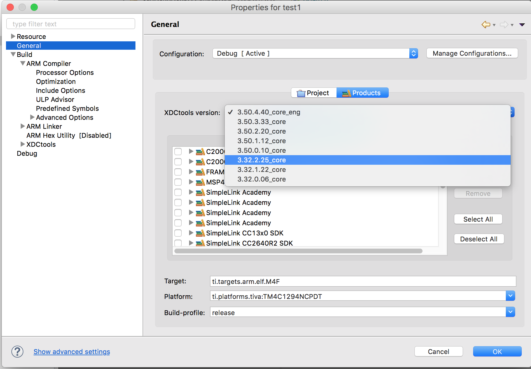

  • Lo2,
    Try switching the project to use the 3.32 version of XDCTools.  3.32 and 3.50 are not compatible.  I suspect that the examples were done assuming 3.32.  CCS ships with both and if the project is specifying the version correctly it should select the right one.  If it is specifying an even older version then CCS may go ahead and use 3.50.
    If you right click on the project.  Select properties.  Then select General in the tree on the left.  Click on products on the right.  Then change the XDCTools version to 3.32.
    John
  • Hi John,
    on Windows CCSv7 installs xdctools 3.5, the processor sdk contains sysbios (built with xdctools 3.3) and xdctools 3.3.
    If I generate a new project, that will use xdctools 3.5 and use the sysbios from the pdk.
    I could either rebuild sysbios with xdctools 3.5 or downgrade xdctools to 3.3.
    What do you recommend?
    Lo2
  • Lo2,
    Switch the project to use xdctools 3.3.
    John
  • Hi John,
    works fine, thanks.
