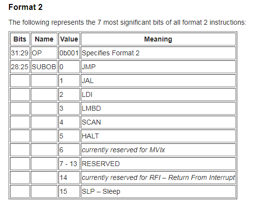

The problem is with the code generated by the ZERO pseudo-op.  2EFF8190.  It shows up in the debugger disassembly as
XIN 255, &R16.bo,4
The only info I can find on the hex op codes tells me the following:
The hex of the op code means Format 2.
That is, the SUBOP is 7, reserved.
The information in the Wiki on the PRU assembly instructions regarding XIN is:
On XIN, the register file data starting at the register REG with a length of IM(124) is read in from the parallel XFR interface from the hardware device with the device id specified in IM(253).
That is, the immediate operand 255 is illegal?
In any case, this instruction crashes the PRU.
Perhaps there is a flag on the compiler to prevent it from generating illegal instructions?
Any assistance would be nice.

  • It turns out the TMS320C6746 has an older version of PRU on it.  You need to add --silicon_version=1 to your build options.  That will prevent the invalid ZERO instruction from being used.  I apologize for the inconvenience.
    Thanks and regards,
    -George
  • Thanks George.  Just noticed your reply.  Indeed that resolves the issue.
    Before I saw this, I had already tried selecting silicon -v1 in the IDE as a work around to complete the project, but it is important for us to know that this is the proper solution.
    Again, thanks.
