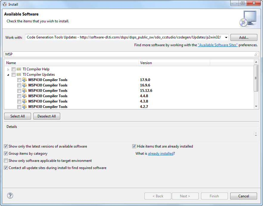

    If you go to help -> Install New Software and select the Code Generation Tools update site by default it is going to show you the latest version of each compiler stream.
    For example here is what it shows me for MSP compilers:

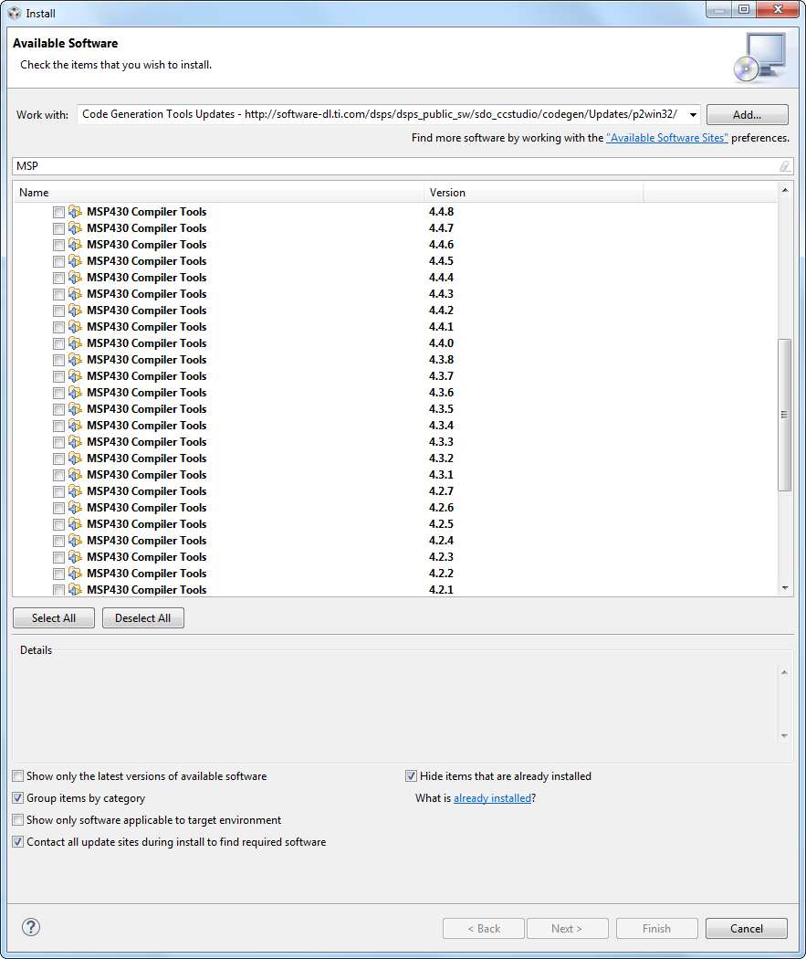

    If I uncheck the box at the bottom to "Show only the latest versions of available software" then I see many more versions:
    Note that once you install a version (say 4.4.8) this way, you will not be able to select earlier versions of the same compiler stream (4.4.7, 4.4.6...) this is because Eclipse does not allow you to install older versions of the same feature.  We have embedded the first part of the version number (4.4) in the feature name so that you can independently update streams.  Now if you happen to install 4.4.8 but need to then install 4.4.6 this is still possible but requires you to manually download and install it and then CCS will detect it and allow you to use it.
