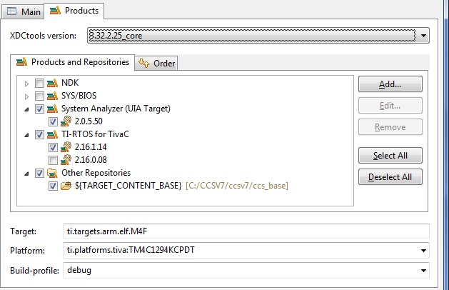

Hello CCS forum,
Recently updated CCS7 DVT and RTOS versions. The CPU load graph & Task graph (details) print yet both graphs remain blank . The execution graph only produces lines (CPU idle) and one of two running tasks and at very slow update rate. Live events on COM6, 115200 baud. Reverted the original project RTOS, XDC tools versions makes no difference, both CPU load, task graphs remain blank.
Recent DVT update suspected to breaking graphs:
 DVT - Graph Visualization	4.1.0.201705251038	com.ti.dvt2.graph.visualization.feature.group	Texas Instruments
   DVT UI Scripting	4.1.0.201705251038	com.ti.dvt2.scripting.ui.feature.group	Texas Instruments
     DVT Core Components	4.1.0.201705251038	com.ti.dvt2.core.feature.group	Texas Instruments
       DVT Common Components	4.1.0.201705251038	com.ti.dvt.common.feature.group	Texas Instruments
        GEF (MVC)	3.11.0.201606061308	org.eclipse.gef.feature.group	Eclipse GEF
          Draw2d	3.10.100.201606061308	org.eclipse.draw2d.feature.group	Eclipse GEF
 DVT Core Components For CCStudio	4.1.0.201705251038	com.ti.dvt2.core.ccstudio.feature.group	Texas Instruments
Any ideas what CCS7 module is giving this issue?

  • I do see the CPU Load and Task Load graphs update when running on CCS 7.3. Please see screenshots below of the versions in my set up. I was running the stairstepStopMode example.
    If you are on an earlier version of CCS than 7.3, there were some known issues in this area. I would suggest installing 7.3 (you could leave your current installation intact if you wish and install 7.3 in a different directory) and giving it a try.

  • CCS 7.3 comes with DVT 4.1.0.201708101502, which is a newer version than the one you have. There was a bug identified in an earlier version of DVT that impacted graph updates, and that should be resolved in this latest version.
  • Wonder why DVT 4.1.0.201708101502 is not showing as an available DVT update to CCS7.0?
  • Unfortunately CCS 7.3 (and its components) is not available as an update, as noted in the Download page.
    Hence, you would need to do a full install of 7.3. I apologize for the inconvenience.
  • Thanks Arti,
    Load graph is working in 7.3 - must have been recent DVT update that refused to revert back after C2800 install repository went missing.
