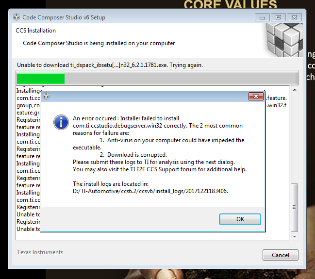

  • Hi Rafeal,
    i am having some problem with while installing the CCS v7.3,v6.2,5.5.
    after referring the community forum and their helps i tried my best for anti virus ,still i am suffering the the same issue. below are the steps what i tried.
    -download the CCS versions and installs -FAILS (here anti virus is running)
    -download the CCS versions,disable the anti virus and installs -FAILS
    -disables the antivirus, download the CCS versions and installs -FAILS
    -uninstall the antivirus, download the CCS version and installs -FAILS
    i am sending the installation failure reports to TI as it suggests in popup after failed installation.
    my PC has "Trend micro" anti virus.
    Need your help for the same.
    Mohammed

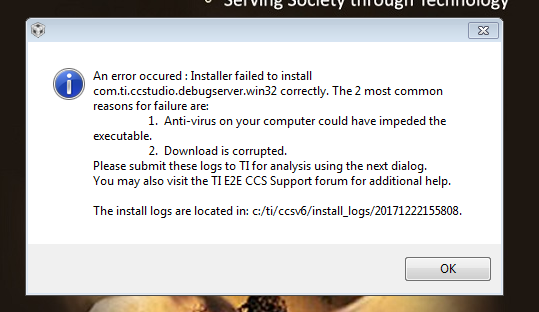

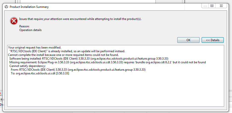

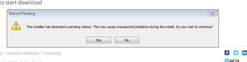

  • Hi Rafael,
    Adding couple images for your reference.
  • Hi Mohammed,
    Trend micro tends to mess up the installation by leaving files open during the install. You would need to turn it off, delete all the files in the installation directory and install successfully before trying to install anything from the update sites.
    Danish

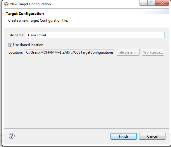

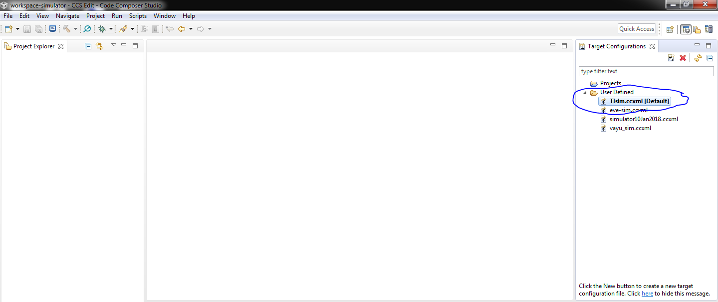

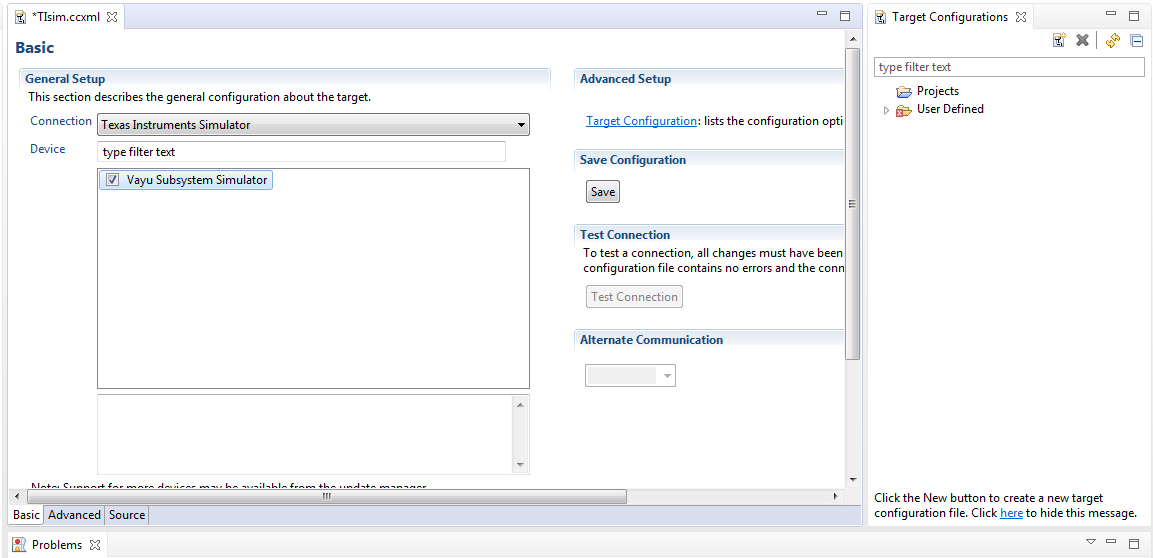

  • Thanks Anshu,
    I am using the CCS 7.4. I am able to install vayu simulator under ccs7.4 successfully. when I create a target and launch the target CCS crashes.
    Refer below steps for target creation and launch.
    1. step01 :create target
    2. configure target, whatever  I see suitable, I select for best result
    3. set target configuration as "Default"
    4. Launch the selected configuration
    Mohammed

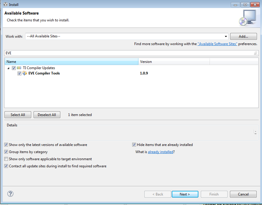

  • Hi Mohammed,
    You dont need offline installer. Please follow these steps :
    In the CCSv5 main window, select Help->Install New Software...
    - This brings up the Available Software window.
    In the Available Software window, type the vayu simulator P2 installation server URL listed below into the "Work with:" text box, and press Enter.
    Server URL for windows:
    Windows: software-dl.ti.com/.../p2win32
    Linux: software-dl.ti.com/.../p2linux
    It will list TI VAYU CCS simulator. Select it and finish installation. You will have to restart the CCS. Once this is done do the workaround mentioned my me earlier after that you should be able to install and use vayu simulator

  • when I open CCS 5.4 I get the popup for the update see below if I click "finish" button on popup it gives error(refer pic 2)
  • Hi Mohammad,
    I am not sure about this error. If you have a fresh installation of CCSv5.5 then you can try the steps on it. I earlier used 5.5 and I didnt faced any such issue. I even tried with 7.3 and with the workaround and steps mentioned by me its working even there.

    I am able to run the simulator on CCS 5.4,
    main trick what I did is I bypassed the update and configured the target for vayu simulator.
