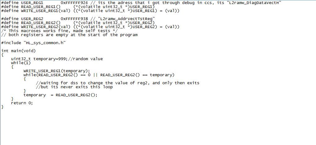

Good day, i have a laucnxl2-570lc43 and im trying to organize an data exchange beetwen lauchpad and my pc through DSS (Debug server scripting).  (The idea is: debugSession.writeReg(val,"registerName") -> launchpad reads it and then write onto the another register -> dss.readRegister("registerToReadName") - reads the data from the second register, its all in the infinite loop here and there)
I found some registers, wrote the values in them, but launchpad just dont read them. the code i wrote tells me it is just like the dss doesnt do changes in registers (i know that it does, cuz when i write registers via dss and them read them via dss as well the values changes).
when i changed the flash memory to test if it is possible to write a and read registers by the launchpad itself, it all worked. (that tells me that my code realy reads registers values).
the part of the code in ccs is like:
while(int i==0){
i=registerRead(); // because the value in the register is always 0 at the start
So this code just dont react to the dss and it always in the cycle when i use debugSession.writeRegister()
Can you help me?

  • - DSS writes value, yes (and reads as well. when i write and than read this exact reg, the values are the same)
    - Code on lauchpad doesnt reads the value written by dss.
    - DSS writes and reads both registers.
    Code on the lauchpad writes and registers but only if i changed their values in the code composer code(i tested it).... and reads them
    but code in the lauchpad doesnt react to the registerchanges when i change values via DSS.
    How the code should work: first, dss reads reg1,prints val, then i write reg writeRegister(reg2,val); the code in lauchpad should read this reg2, exit this infinite loop
    while(int i==0){ i=registerRead(reg2); // because the value in the register is always 0 at the start }
    and write this val to reg1. then the loop in dss starts again and dss reads reg1 again.
    But the problem is value in reg1 read through dss is always 0. that mean that lauchpad sees val at reg2 as 0 and its always in the loop written above.
    I use CCSv7

    DSS and CCS  code (using java, zero exceptions or errors)
    (cant load the text code, forum errm thats why i'll use images)
    The output of the program is:
    Got data from a launchPad 999
    Value 326 has been written to a L2ramw_AddrVectTstReg
    Value 514 has been written to a L2ramw_AddrVectTstReg
    Adress of the second register and his name is correct, i checked it

  • Solved.
    What solved my issue was closing debugSession every time i  need changes to be saved.
    while(true)
    debugSession.target.connect();
    debugSession.memory.readData(0, readBufferReg, 32);
    debugSession.memory.writeWord(0, writeBufferReg, randomValue);
    debugSession.target.disconnect();
     Thread.sleep(1000);
    As far as i understand opening debugSession stops execution the  launchpad's algoritm.
