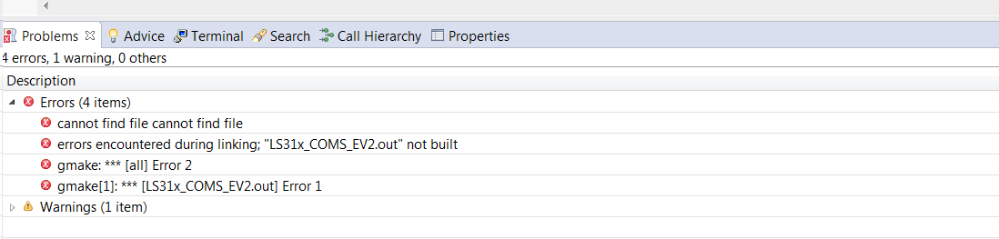

I am working on a CCS 7.3 project which I got from my senior. I tried to compile it and CCS gave me a very unhelpful error message. I was able to link up all missing files in previous errors till this showed up.
Appreciate if anyone can give me any slightest clue about this error? I don't even know where to start to tackle this error.

  • Thanks. Can you provide all the build output from the build console?
  • Hi Ki,
    Thanks for the clue! Attached is the error found in the console.

    However, from my knowledge, we never used this  ***_eh.lib before. Even though I specifically set the runtime support library to be the one without rtsv7R4_T_be_v3D16_eabi.lib, during the compilation, it still looked for this ***_eh.lib. And I couldn't find this ***_eh.lib file in my TI installation directory and online as well. Any help on this?

  • The "eh" is for exception handling support. This library would be selected if exception handling is enabled for the project. If the library does not exist, then CCS should try to build the library:
    processors.wiki.ti.com/.../Mklib
    The question is why the library didn't get built. Were there any other build errors regarding the building of the library?

    I found the issue and got it compiled.
    Under the ARM Linker, the _eh.lib file was included specifically under the "File search path". I don't know why it was there at the first place as we didn't enable the Exception handling option at all from the beginning.
