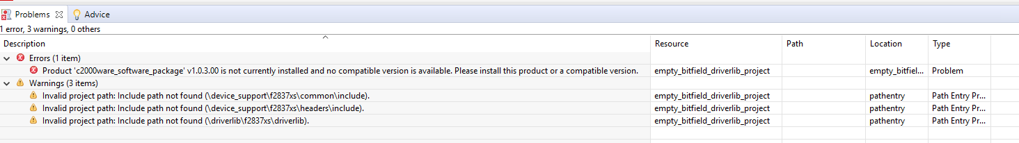

  • Is there a possibility to add C2000WARE downloaded from the web manually to resource explorer? I tried but the downloaded content seems to lack the metadata folder which links it to GUI. Also it seem that if I don't have the package installed, I cannot build projects using driverlib. Would appreciate some sort of workaround to keep the development going.
    Can you let me know what error you get when building the driverlib projects? A screenshot of the error and a copy of the build log in the CCS console would be helpful to see.

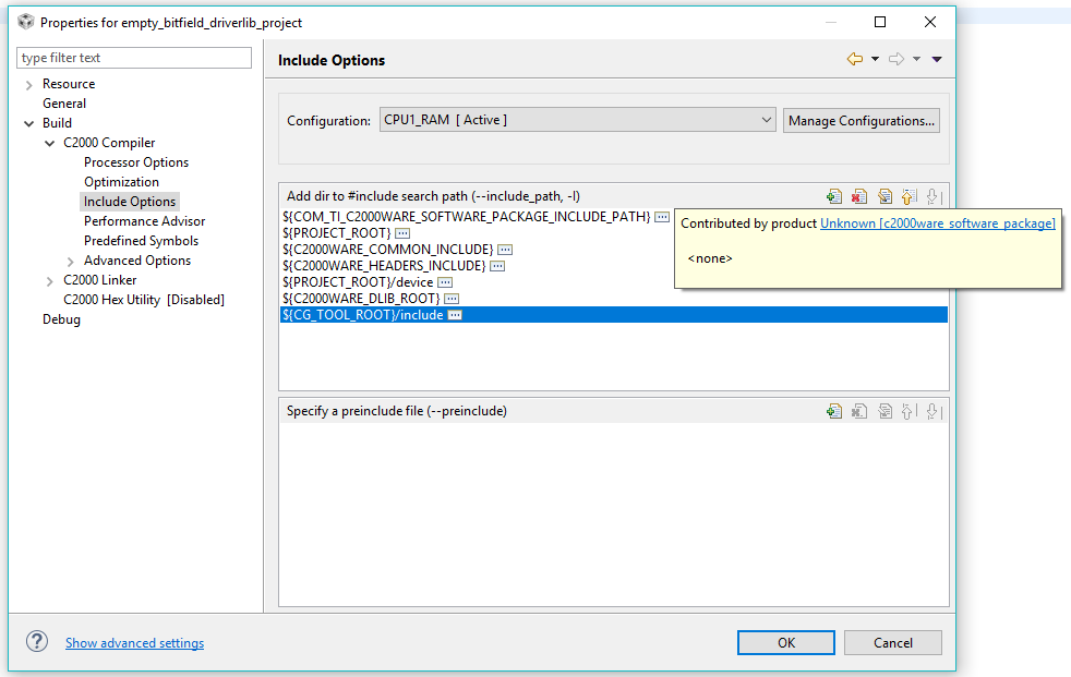

    Did you import the project using menu Project->Import CCS Project? What is the exact path to the project you imported? It looks like some of your paths may not be set correctly. What do your Compiler Include options and Variables look like for the project, in comparison to mine shown below?
  • Yes, some paths were incorrect. I made a new empty project with correct paths to the C2000WARE on the disk and I can access the driverlib now. The problem is that using this method, the driverlib is kind of hardcoded. I think that you might have some residual effect with the paths. For me, it says in the example project that the paths are provided by the software package which is not installed to CCS IDE. I can develop on the hardcoded lib also, but it would be nice to add it as a software package so the updating is not a complete disaster. Have you got any estimate on the fix for resource explorer C2000WARE download?
    Currently, if you download the C2000Ware package through Resource Explorer it automatically adds it as a product to CCS (ie under Project Properties->General->Products tab, C2000Ware is added as a product), while if you download from TI web, it does not. This causes a conflict if a project that is imported/built once on a CCS with the C2000Ware product added is then imported into a CCS that does not have the product added. There should be no build issues if you directly import an example project from 1.00.03.00 using menu Project->Import CCS Project and browsing to the example directory. Could you confirm if this is accurate in your environment?
    One workaround here could be to download C2000Ware version 1.00.02.00 using Resource Explorer so the product gets added to CCS. Then your project should build. However you would still need to adjust the variable COM_TI_C2000WARE_SOFTWARE_PACKAGE_INSTALL_DIR to the 1.00.03.00 version if you want to use the header files, libraries etc from the new version.

  • Hello
    As Aarti mentioned, there is currently a difference between the version downloaded from TIREX vs ti.com
    For your installations from ti.com, copy the ".metadata" folder (I attached versions for 1.00.02.00 and 1.00.03.00) to root folder of C2000Ware (ex: ~/ti/c2000/C2000Ware_1_02_00_00). This will have this version identified as a product and resolve the difference.
    Example may have to be re-imported (and CCS workspace closed then reopened)
    Best regards
    Chris
