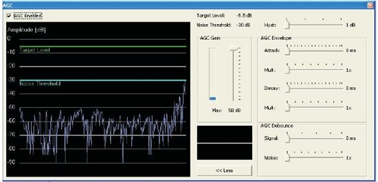

2.  I was going through the application report SLAA446: 'Using the AGC, DRC and Beep Generator Function in TLV320AIC3204 Devices'. I came across Fig. 2, 3 and 4. Is it possible to create such control GUIs using CCSv4.

    Thanks a lot for your reply. It really helped in getting started with GEL programming. I now know how to create individual sliders and dialog boxes. I have few more questions.
    1. How can I make more than 1 silder to appear in same frame as shown in attached Fig.1.
    2.  How can I attach a check box, a button and a responsive curve along  with slider (in same frame) as shown in attached Fig.2.

  • Abhishek,
    The screens shown in your post are probably part of a Windows application and therefore created using a Visual C++ development environment that communicates to CCS using either CCS Scripting (for CCS3.x) or Debug Server Scripting (for CCSv4.x). GEL is the simplest but limited way to add check boxes and sliders.
    Rafael
    (edit) P.S. Debug Server Scripting will make your task much easier, therefore it is the preferred way.
