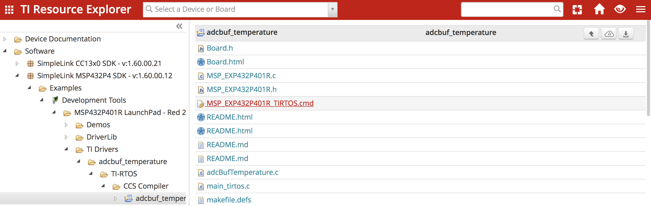

I want to load an example directly from TI cloud to CCS cloud. In the older version I see cloud icon I do't see now. Is there any way?
  • Hassan,
    Are you talking about the cloud icon in the top right of Resource Explorer?  Basically just below the Home icon there is a cloud one with a cube inside it.  Clicking on that will import the project to CCS cloud.
    Can you let us know what example you are trying to import or show a screen shot?
    John
  • John,
    Your figure was very helpful. I needed to go one step further inside the folder to see the icon.
    Thank you for your answer.
