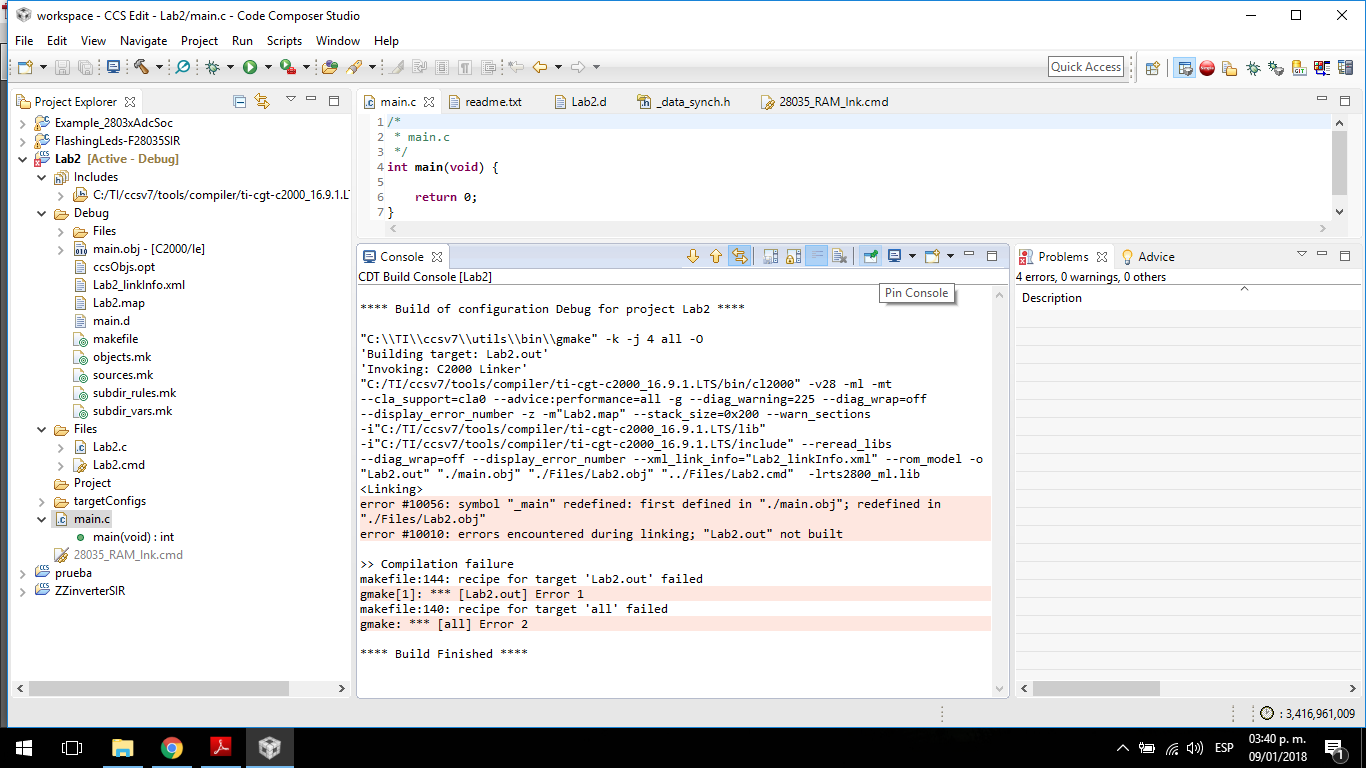

CCS/TMS320F28035: error #10056: symbol "_main" redefined
Part Number: TMS320F28035
I have a issue whe I tried build de example lab2 included in the https://e2e.ti.com/C2000 Piccolo Workshop; F28xPmdw Revision 2.1 December 2010. I send a screenshot to show this issue. I don´t found the cause of issue in the example project.
Best regards
Sebastián
    I haven't used this example before, but the error message clearly specifies which source files of your project are defining the conflicting function "main". Check each source file and see which one has this defined by mistake.
