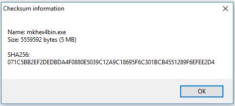

    One ... To be sure you have the same mkhex4bin.exe that I have, compute the SHA-256 checksum and compare it to the one in the following screen shot.  Here is how I did it. My system has the 7-Zip archiver installed.  Use File Explorer to browse to a directory similar to C:\ti\ccsv7\utils\tiobj2bin .  Right click on mkhex4bin.exe and choose CRC SHA | SHA-256 .
    Two ... Get a fresh install of the cg_xml package and replace both of the files in the tiobj2bin directory.  See this forum thread for the details.

  • I used https://md5file.com/calculator to generate the SHA-256 hash and got the following result:
    I also tried replacing the entire folder, but the result remains the same.  At this point, this is clearly a problem that's unique to the way our computers have been set up.
