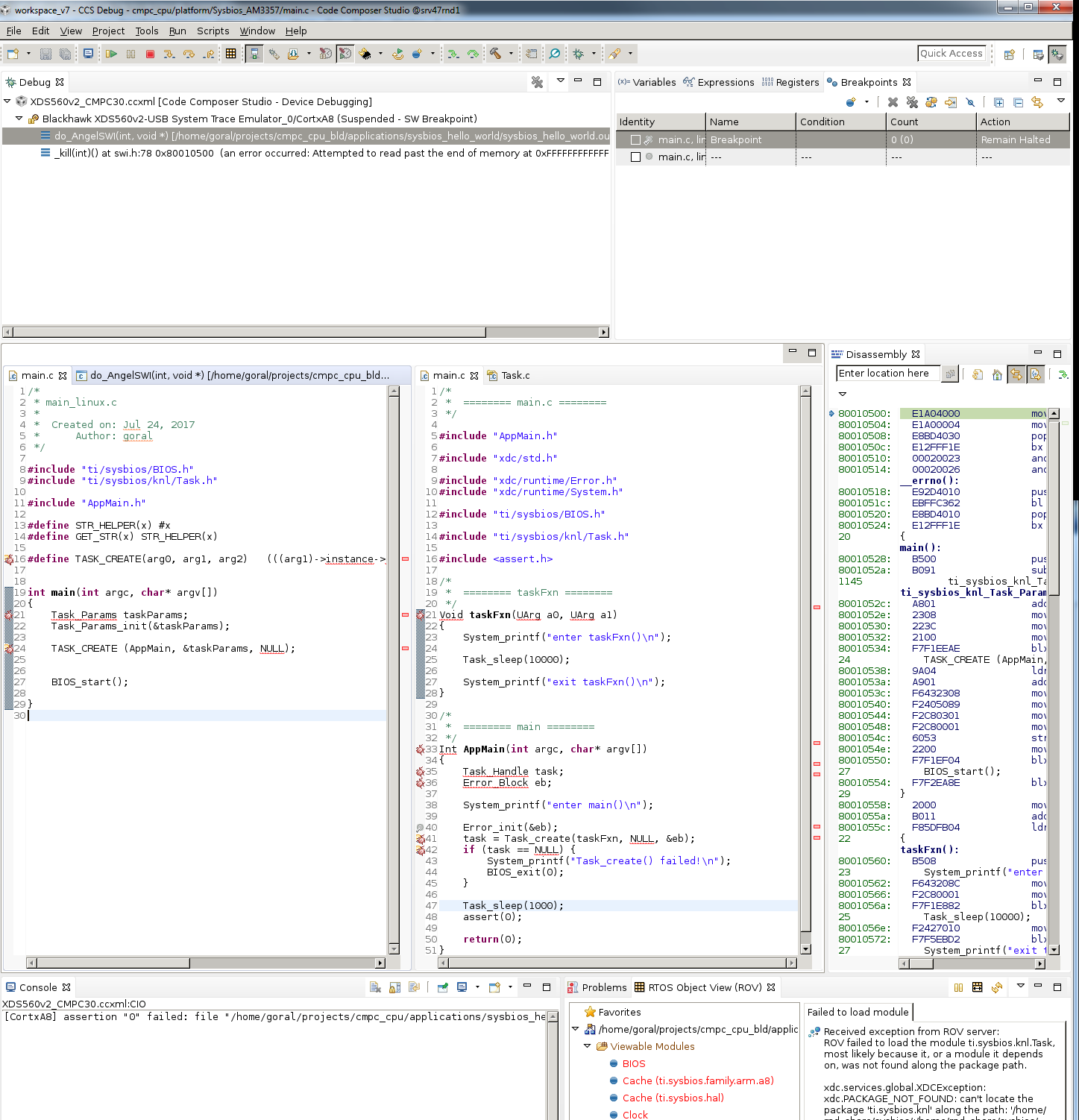

There are many situations where I cannot see full call stack when I break program execution or catch hw exception, or program is trapped in _exit() or assert().
Problem looks to be identical with following one that is well descibed here:
https://e2e.ti.com/support/development_tools/code_composer_studio/f/81/p/551666/2088665#2088665
Im currently using:
Sitara Cortex A8 AM3357.
Blackhawk USB560v2
CCS7.4 under Linux, and Windows too.
gcc-arm-none-eabi-6-2017-q1-update,
bios_6_51_00_15
xdctools_3_50_00_10_core
However, at the beginning I thought that problem is related to the fact that linking sysbios application neeeds to be made with libc delivered by sysbios.
Yesterday I checked that even simply hello world application without sysbios,(and linked to libc delivered by gcc) have same problem.
I tried with dwarf3 and dwarf4, no difference.
