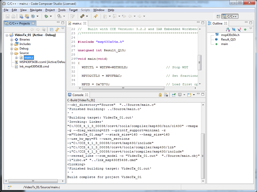

  • Rafael,
    Here is the reponse from my customer;
    I am running CC 4.1.
    I followed the procedures for adding the variable path name to the Windows -> Preferences -> ... -> Linked Resources.
    I then added a simple main.c to the project and it compiled OK
    I next linked to a simple prog.c (using Method 2) and got the following error:
    "C:Program Files\Texas Instruments\CCSV4\gmake\gmake *** No program to make target /prog.c needed by prog.obj"
    I only get this message when I use "Link To" instead of "Add"  Everything else seems to work as indicated in the app note.
    Sorry to make such a production of this.
    -Tom-

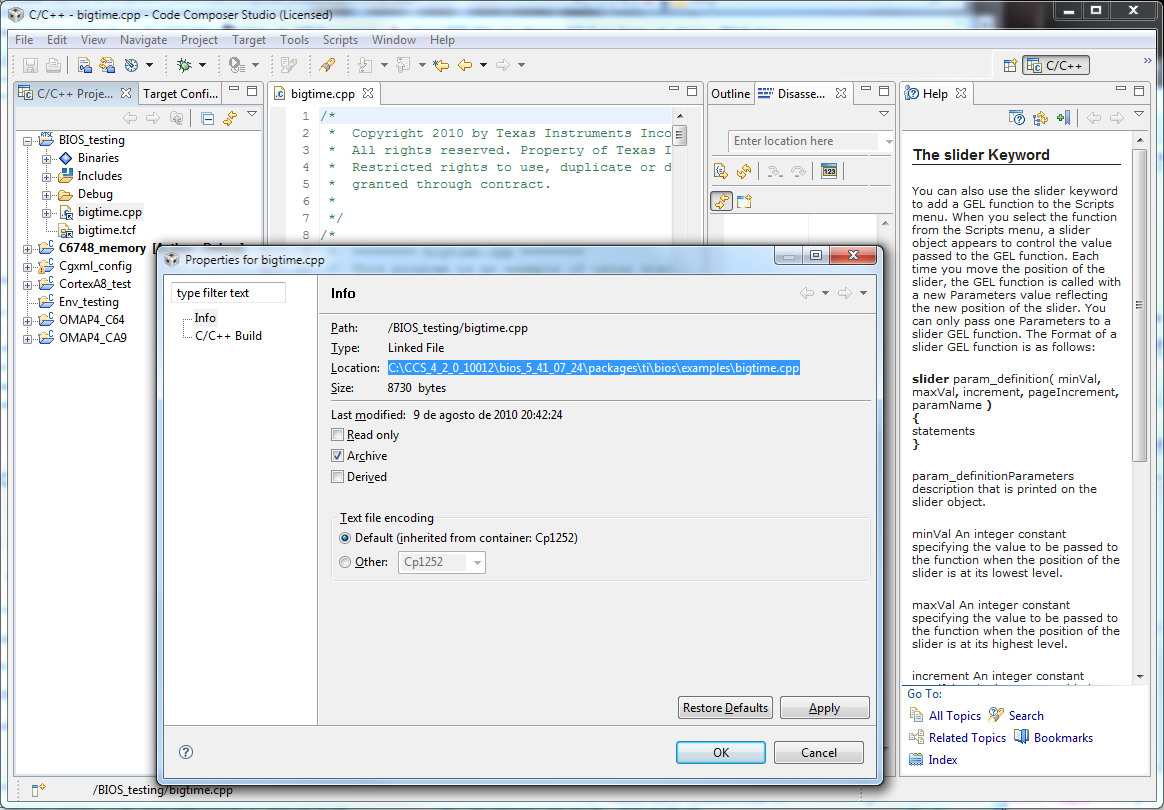

  • Tom,
    Sorry, I am a bit confused. Your first post shows that your customer is trying to simply link a file to a project by selecting the Link Files to Project and pointing to the destination source file. If this is what he wants, he does not need to set the Linked Resources or link the files using the method for Portable Projects. Did he succeed to simply link a file this way?
    It seems that now he wants to create portable projects based on this page, therefore the error shown in your post indicates the variable is not being properly set. The message mentions /prog.c, therefore indicating the variable is resolving to NULL. Can you confirm the following topics?
    - Does the linked file have an exclamation point (!) close to its filename in the C/C++ Projects View? If so, this is a confirmation the file is not being found.
    - If he right-clicks on the file, what does he see? Check the attached screen that shows a file that is tied to a linked resource (MY_DOCUMENTS) and its resolved location in the filesystem.
    Apart from this, I am not aware of any problems in the method depicted in the Portable Projects page. I would need additional details about his project (maybe even the project itself) to have a clearer idea.
    Hope this helps,
    Rafael
  • Rafael,
    Here is the latest from my customer;
    I may have made things more complicated then they have to be.
    My original intent was to create projects with source code in multiple directories.  I thought I needed to follow the guidelines in the "Portable Projects" app note to implement this.
    I deleted the project I had been working with and created an new project.  The directory structure is as follows:
    All my MSP430 projects will be inside the main directory C:\Projects\CC4_MSP430
    All my video transmitter projects will be in C:\Projects\CC4_MSP430\VideoTx
    The new project is C:\Projects\CC4_MSP430\VideoTx\VideoTx_01
    Inside VideoTx_01 is a directory named "Source" and there is a simple program main.c in Source.  C:\Projects\CC4_MSP430\VideoTx\VideoTx_01\Source
    When I used "Add file to Project" the build worked OK.  When I used "Link file to project" I got the following error message:
    "C:\Program Files\Texas Instruments\ccsv4\utils\gmake\gmake: *** No rule to make target `../main.c', needed by `main.obj'."
    When I open the .project file everything looks correct.  I have attached a Notepad version of the file.
    I must be doing something fundamentally wrong, but can not figure out what it is.  Thanks for the help.

  • Tom,
    I see what's going on now. The source files that are inside the directory structure of the main project are automatically included in the project, therefore they do not require being manually linked or added to the project - doing this can create a convoluted reference to the source files that seem to be confusing CCS (I could reproduce the same message he is seeing).
    Just as a reference, please check the attached screen: I created an identical directory structure as reported but did not add or link any files from the "Source" directory. The project builds fine as it automatically scans the subdirectory Sources.
    What I don't understand is that adding <main.c> to the project should fail because the function main() (or other functions, variables, etc.) would be duplicated, causing the linker to throw an error. However this does not seem to be the case.
    Anyways, if your customer still has problems please let me know, ok?
    Rafael
    P.S. In the future your customer may create a portable project, since the directory structure he created is perfect for this; I would simply follow the steps at the page he mentioned.
