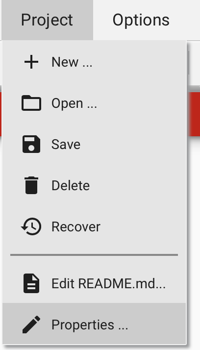

    When creating the GUI Composer Project and selecting XDS as the transport were you able to specify the program file?
    i.e. were you able to fill out this screen:
    If not you can get back to those settings here:
    John

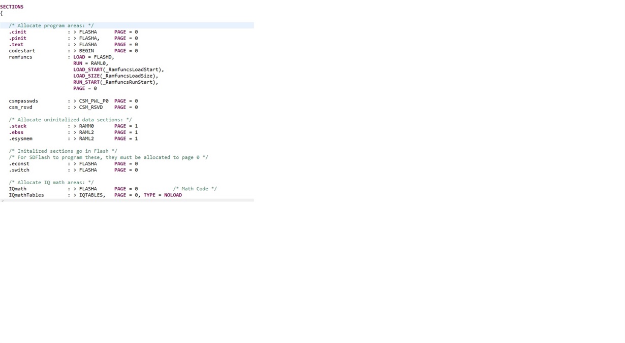

    Where is .text being placed?  I.e. what does the line in the .cmd file look like
       .text            : > RAML0_L3,   PAGE = 0
    or something like?
       .text            : > FLASHA,   PAGE = 0
    If you are placing it in FLASH then you need to copy it to RAM in your application.  You would not want to place it in .text as you only want to copy the relevant code to RAM so keep it in ramfunc.
    There are example projects in C2000Ware that show how to copy the ramfunc section at runtime.  Just take a look at one like Example_F28035_Flash.  You still have the code going into ramfunc, the ramfunc section is placed in FLASH for loading but then at runtime it gets copied to RAM.
    On this device if it is working in CCS don't assume it is going to work in GUI Composer.  Please note that if the program is being placed in RAM CCS will still work fine.  The extra reset that causes the device to start executing from FLASH does not occur when using CCS.  The problem is specific to GUI Composer.
    John
  •  Yes I did change  .def _DSP28x_usDelay
          .sect "ramfuncs"
    To:
          .sect ".text".
    In Cmd File this what it shows in screen clippling-
  • Sagar,
