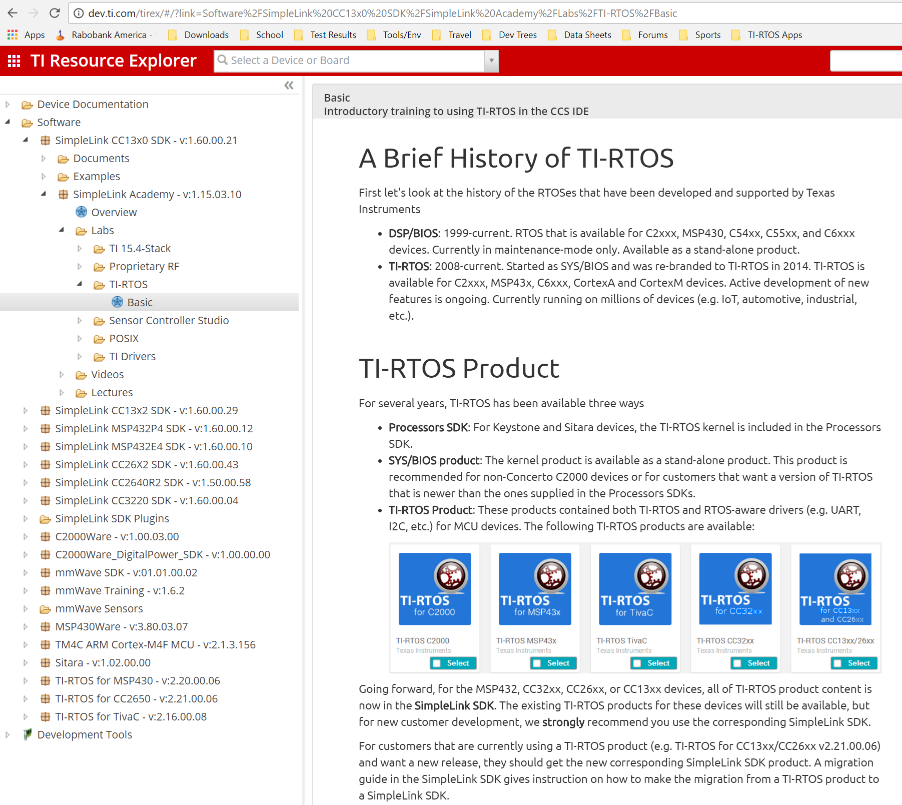

  • Holey Moley! That's exactly what I was looking for. The problem was I didn't have sys/bios package installed, but I did have the tirtos package (I'm still not overly clear on the difference... sometimes I read stuff that says they're the same, then times like this, they appear to be separate). Anyways, for anyone on this path in the future, installing the sys/bios package was done through the resource explorer.

  • The branding of SYS/BIOS vs TI-RTOS has been rocky. Here it is in a nutshell. Note: when I say "product" below, that means an installable product.  SDKs are products also
    We have had a SYS/BIOS product for several years. It is basically a kernel. It does not include drivers or stacks. A few years ago, we started bundling the SYS/BIOS kernel, RTOS-aware drivers and stacks together for MCUs (e.g. MSP43x, CC32xx, CC13xx, CC26xx, C2000, and TM4C).  We called this the TI-RTOS  product. For the "Processors" devices (e.g. C6x, Sitara, etc.), SYS/BIOS was already bundled into their SDKs (along with drivers and stacks). So everyone just using the term TI-RTOS even though for processors, it was SYS/BIOS. Note: in the TI-RTOS product, SYS/BIOS was basically added as is into TI-RTOS product for backward compatibility.
    Last year (2017), for the CC13xx, CC26xx, CC32xx, and MSP432 devices we came out the the SimpleLink SDKs that include TI-RTOS. So for those devices, we recommend using the SimpleLink SDKs and have stopped making TI-RTOS product releases. Now the new TI-RTOS features are going into the new SimpleLink SDKs.
    For C2000, we never made C2000 drivers, so it's really just the kernel, so we recommend you just use the SYS/BIOS product directly.
    For Processors SDKs, we give them new SYS/BIOS releases to add into the SDK.
    I hope that helps clear things up some.
    Since you are using TI-RTOS product, another way to get to the docs was the Docuementation Overview html page in the doc directory. This seems like a relatively easy way to find things.
