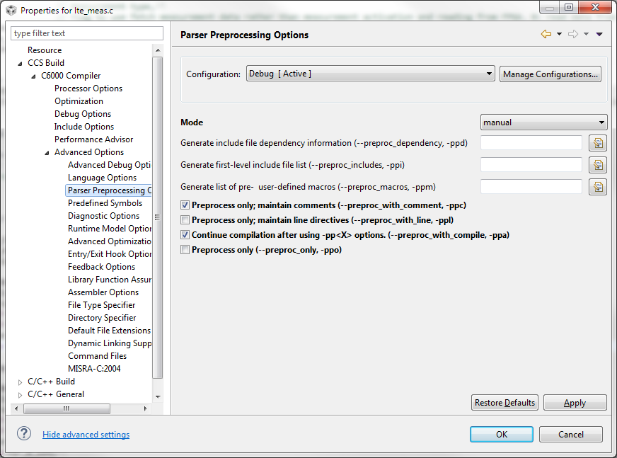

I wish to check preprocessed version of my source file. I follow instructions at http://processors.wiki.ti.com/index.php/Preprocess_Complex_Source_Code_for_Bug_Submissions#CCSv5.1_Method, so I have right clicked a source of interest, found Parser Preprocessing Options, ticked --preprocess_with_comment and --preprocess_with_compile, tried to build as selected file of interest, so whole project. Unfortunately, no *.pp file is produced nowhere under the project folder.
Options screen:
Build console output:

  • The preprocessed file is in the same directory as the corresponding source file.  In this case look for it next to ...
    D:/*********************/src/lte/meas/lte_meas.c
    I have never seen CCS put asterisks (*) in front of a file name.  I guess you changed it after you copied and pasted from the CCS build output.  Anyway, wherever that really is, under the CCS project directory or not, that is where the .pp file is.

  • Thank you, George!
    Indeed, it was next to the source. And sure, I zapped the path with asterisks by myself.
