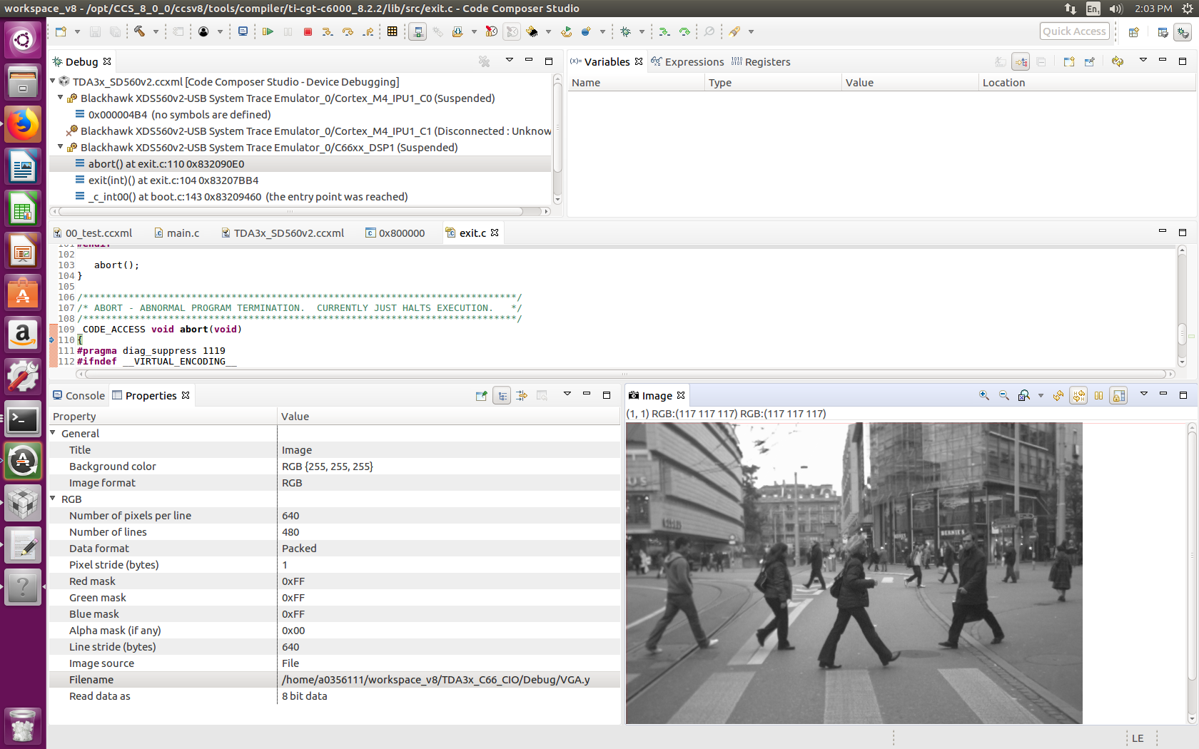

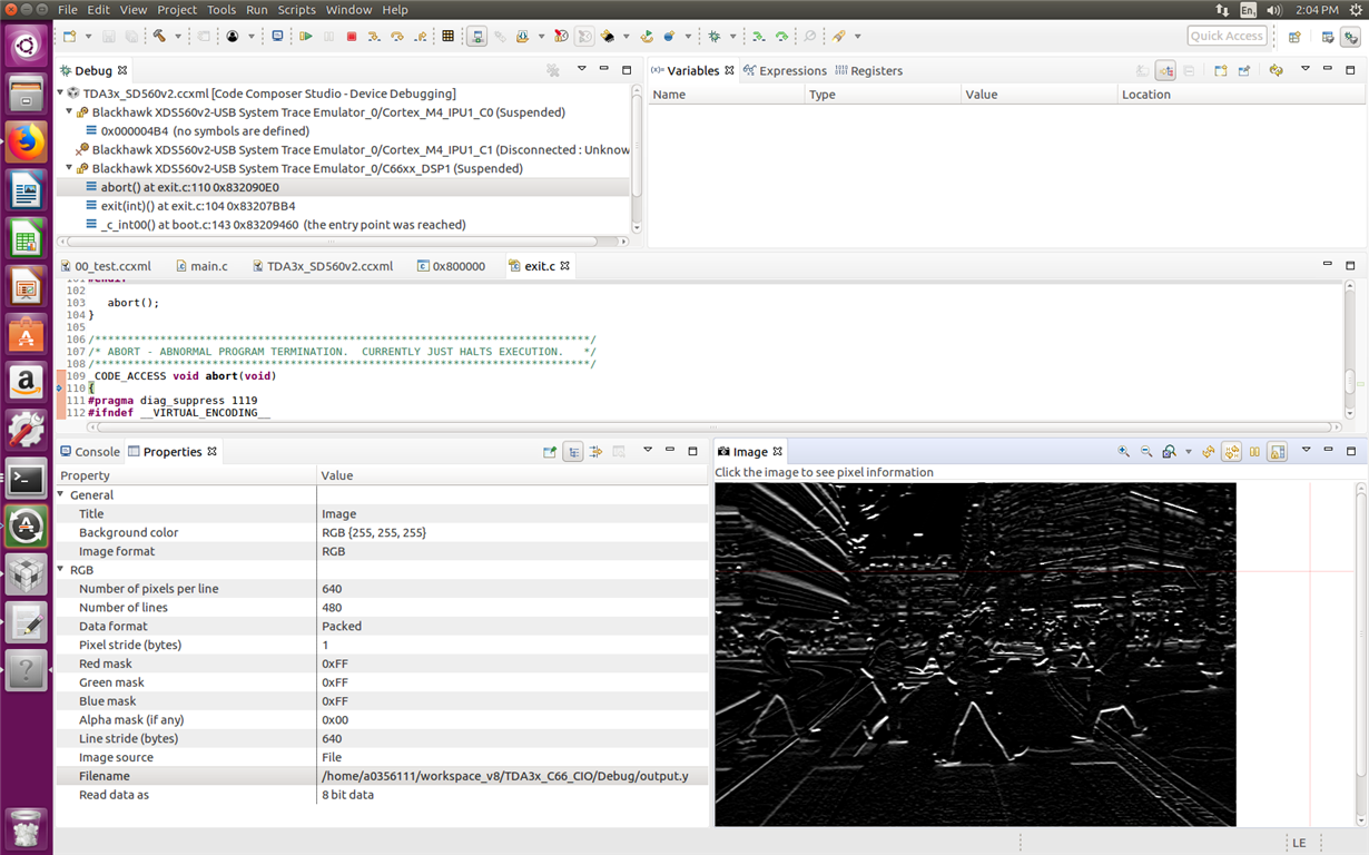

  • Pritam,
    I am not entirely sure what is the end result you are looking for, but the VGA.y and the output.y results I got here are shown in the following screens, together with the parameters I used.
    Does that look ok?
    Rafael
  • Hi Rafael,
    Yes,that's the output expected which you have shown in second screen,but i didn't get that output ......?
    The output.y which is generated is showing only black and white strips on image generated.
    I am testing it on TDA2x board for DSP core on ubuntu system.
    And i checked same code on CCS5.5 simulator(on windows platform) it is showing correct output as you have shown in second image....!

  • Pritam,
    Unfortunately I still couldn't reproduce this issue in Ubuntu. I tested CCSv7.4 and an internal Beta of 8.0.
    I suspect there may be something else at play in your environment. Did you make sure the image parameters are identical to what I showed in my screenshots?
    This may be an issue with some temporary settings of the Debugger. Can you check sections 4 and 6 of the Troubleshooting page and see if the suggestions there help you get a correct output?
    I send attached my project with the generated output.y file.
    Hope this helps,
    Rafael
