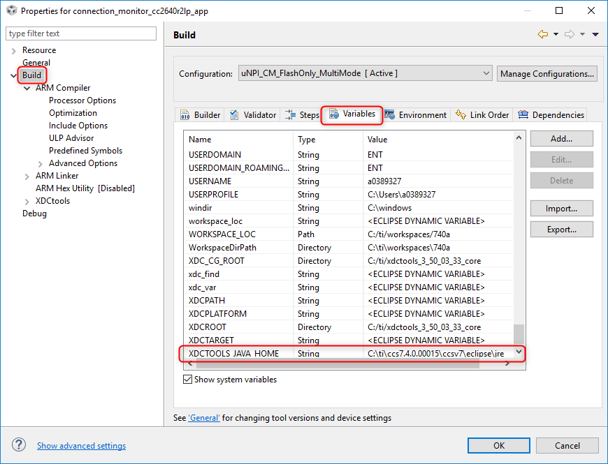

I tried to build project with command line,
cd D:\TI_PRJ\workspace-2\simple_peripheral_cc2640r2lp_stack_library\FlashROM_Library
"C:\\ti\\ccsv7\\utils\\bin\\gmake" -k -j 8 clean -O
"C:\\ti\\ccsv7\\utils\\bin\\gmake" -k -j 8 all -O
cd D:\TI_PRJ\workspace-2\simple_peripheral_cc2640r2lp_app\FlashROM_StackLibrary
but when execute until last command , some error message shows from console,
C:\ti\xdctools_3_50_04_43_core\C:/ti/xdctools_3_50_04_43_core/xs: error:
can't create session manager:
can't find a JVM;
try setting the environment variable 'XDCTOOLS_JAVA_HOME'
to the absolute path of any directory containing a 32-bit Java Runtime Environment (1.7 or greater);
e.g., 'C:\Program Files (x86)\Java\jre7'.
TOOLS/subdir_rules.mk:12: recipe for target 'build-1287780815-inproc' failed
gmake[1]: *** [build-1287780815-inproc] Error 1
TOOLS/subdir_rules.mk:9: recipe for target 'build-1287780815' failed
gmake: *** [build-1287780815] Error 2
gmake: Target 'all' not remade because of errors.
When I set XDCTOOLS_JAVA_HOME done, it works fine.
but I want to know, this configuration should be set automatically when I checked "Generate Makefiles automatically" (at project >> property >> build / builder page), Right?
       if not, is some setup error cause of this issue happened by myself?
