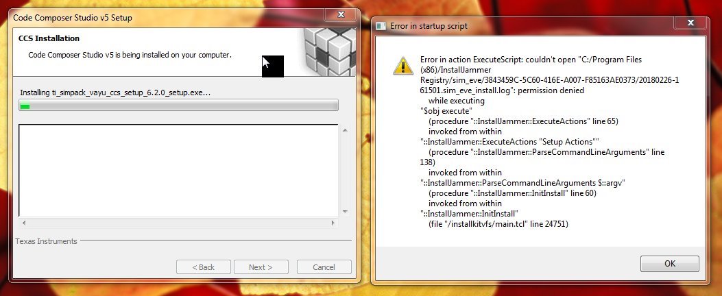

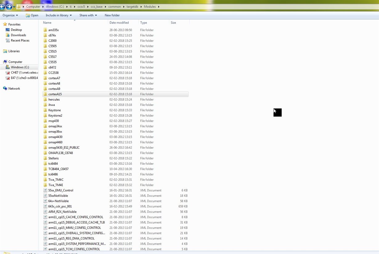

Hi Anshu,
I have tried multiple times, but the issue remains the same. Unable to install the //xdctools// and also cant locate the EVE folder in the //ti// folder in the Computer. I will contact the local TI trainer for this issue and update .
Srinath

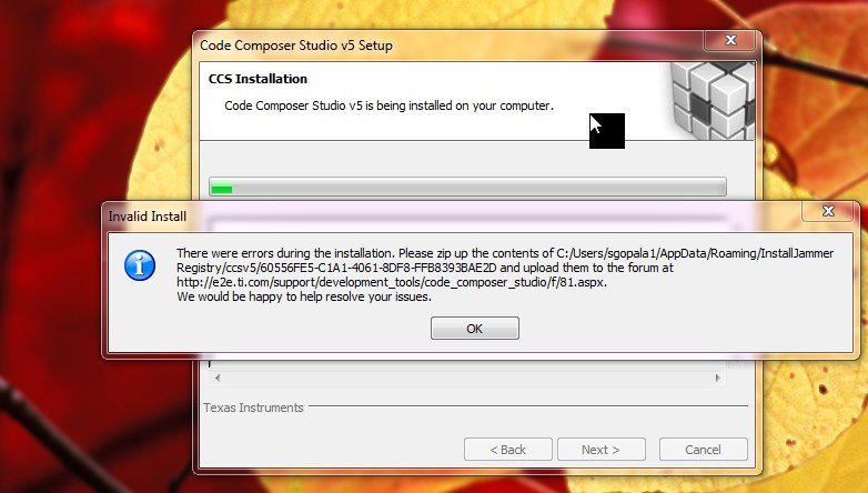

Anshu
If there are errors then installation will not happen. Can you confirm that you have tried the exact same steps as I mentioned? If yes I would suggest you to try those steps on a fresh installation and keep the screenshots of the errors you are getting while installation.
Anshu

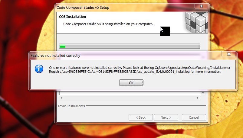

Hi Anshu,
I have followed all the steps you have mentioned earlier. After that only, these errors are generated.
I never opted for the CCS update along with the VAYU installation.
Srinath

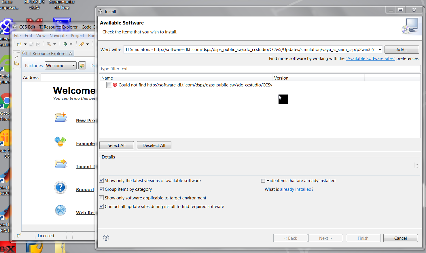

Srinath,
Sorry about the delayed reply.
Srinath Gopalan76 said:I have tried installing in another system too. Now it says Vayu Simulator not found.
Have attached a screenshot for this too.
In your last post, the update site you have specified in the "Work with:" field is incorrect. If you follow the steps outlined in this post by Anshu then the above error should not occur.
Now as for the error pop-ups that you had encountered earlier during installation, if that is still an issue that is preventing a successful installation then please zip up the contents of the folder mentioned in the error dialog and attach it here.

Hi Srinath,
The vayu installer is having a problem writing to the log folder for some reason, possibly a bug in the vayu installer. Could you please shut down CCS completely, and delete the contents of c:\program files (x86)\installjammer registry and try installing again.
I'm sorry for the inconvenience.
