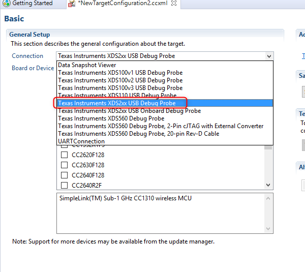

  • Gabriele Miorandi said:
    Yes, I see XDS100[v1,v2,v3] and XDS110, but none of them is an "emulator"... I see emulators only for "Spectrum Digital".
    "emulator" is the same as "debug probe". "Emulator" was the term used more often in the past. However the standard term these days is "debug probe", hence we are shift towards that. But you can use them interchangeably.
    This is the option you need:
    It is missing in your dropdown list?

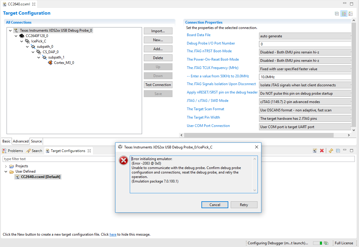

  • Dear Ki,
    I already tried to use XDS2XX from the beginning, but also this configuration reports the same error, please see below:
    Thanks in advance for your help, Gabriele.
  • That is a type of host connection error. Please see the below link for more details and suggestions:
    software-dl.ti.com/.../ccsv7_debugging_jtag_connectivity_issues.html
